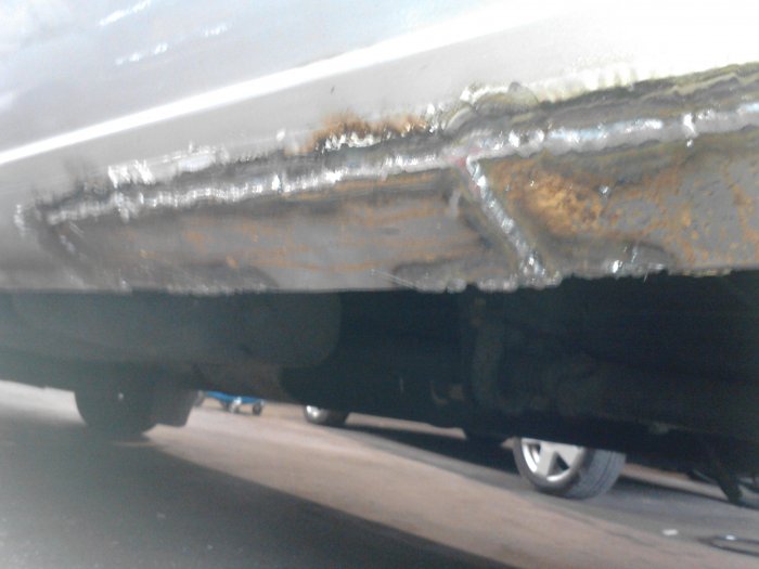

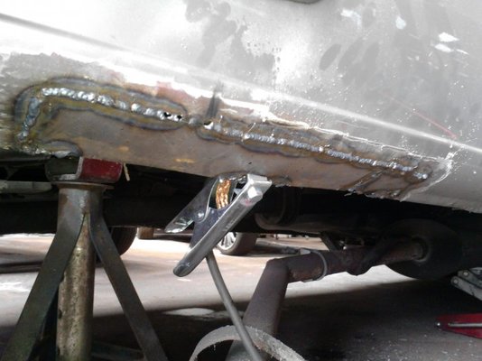

Hello, I'm mainly on the arc welders section as my first found skill was with stick welding. I'm familiar with MOT repair work from the garage I work within, Seam welds where needed/plug welds as needed etc. I've half done a job to a large rusty mercedes sprinter, rotten in a few places on the sills.
The mig is an old (10+) beasty lincoln compact 185 (old school!)
and set on the minimum Voltage setting will readily blow through 1.6mm body steel.
I used a stitch welding technique to create a seam weld, alternating areas of welding to keep warpage and burn through limited...
Its not pretty, its half done also, plus i'll be going over areas that I find unsatisfactory tommorow.
Heres my work...dont laugh!
P.S. the snotty looking bits at the sill lip aren't mine and will be grinded off tommorow!
