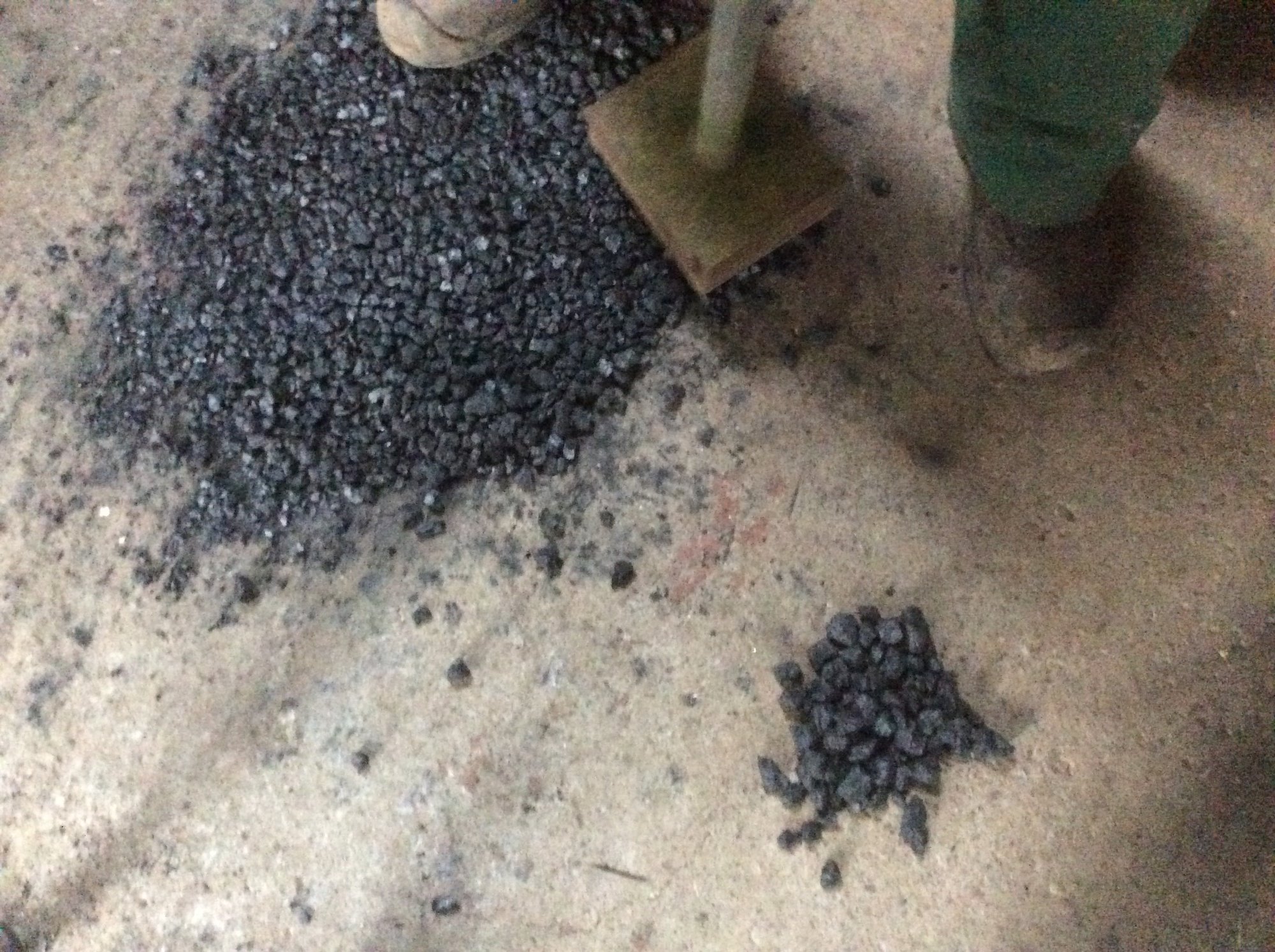

You heat your home with coke or is this for a different application?View attachment 175280 I’ve been experiencing problems lately,as my bunker gets low,the Coke I’m removing from it is too big,20 mm,so I’m resorting to crushing to reduce to the usual 10-15 mm,the fires now behaving as it usually does,frustrating as it’s the supplier I’ve used for over 20 years.tried a garden roller to no avail.
