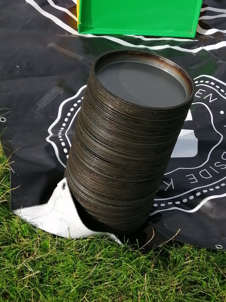

Guy at the boot fair is selling these for 20 quid Bob. Must be 100 of them about 9 inch diameter and just over an inch deep
muffin trays: pour ingots, wait 5 minutes, tip out, reuse. You could even use a bit of water to cool them quicker if you’re impatient. I find the round slugs are easier to stack in the crucible and quicker to melt than blocks. You’ll want to keep the crucible half full so it doesn’t freeze as you add more scrap so you’ll have plenty of time to recycle.Yes, they would be îdeal, but I would need dozens of them. I even looked at Chinese sellers.
For that money they are worth grabbing, even if only for parts trays when working on kit.I was looking at what I typically need to cast and the biggest thing is less than seven kg, if I make ingots of 2kg in brick shapes they can go straight into the crucible I have with no further messing about. Checked out the grade of alloy typically used in ali wheels and in the main its A356 which would appear to be LM25 which is exactly what I want.
