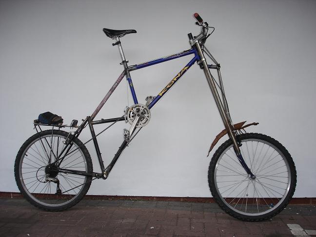

Looks promising, lengthening the wheel base avoid the tendency to wheelie like hell, a good thing when you are this tall.

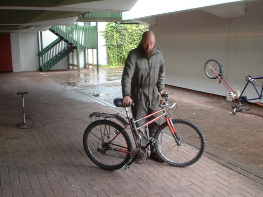

Seat post? gallons of WD40 or plus gas, then sometimes giving it a stern belt from above can help to unseize it, or weld a big tube to the top at 90 degrees and use it to twist the sucker out. Last one we did that to came out smoking from friction.
Bottom bracket, they need a special tool that locks into the splines, turn both of them towards the front of the bike.
Watch out for the chainline fouling on the rear stays, mine just brushes them and has not been a problem is a hundreds miles. I had to fit a small jockey wheel by the bottom bottom bracket
Forks? I would reccomend using twin crown forks and bracing them, they are under massive strain.
Bracing the front triangle? I reckon this might even weaken it, lots of heat going into an already welded join.

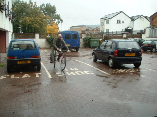

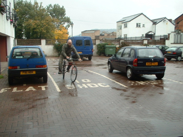

Here is Godzuki, Son of Godzilla.
Remember doing this kind of thing is officially stupid. But you can make twenty people smile by going to the shops, in my eye that makes it damn cool. Just never fall off it in public.
Last thought, check out how the pedals come and see if you can hop up that high, being able to free mount is essential.
