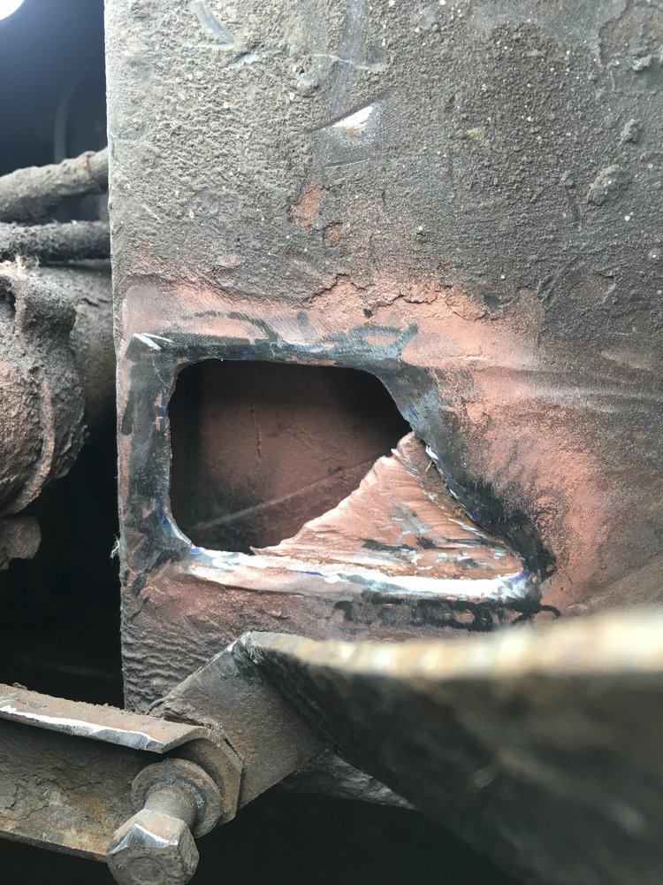

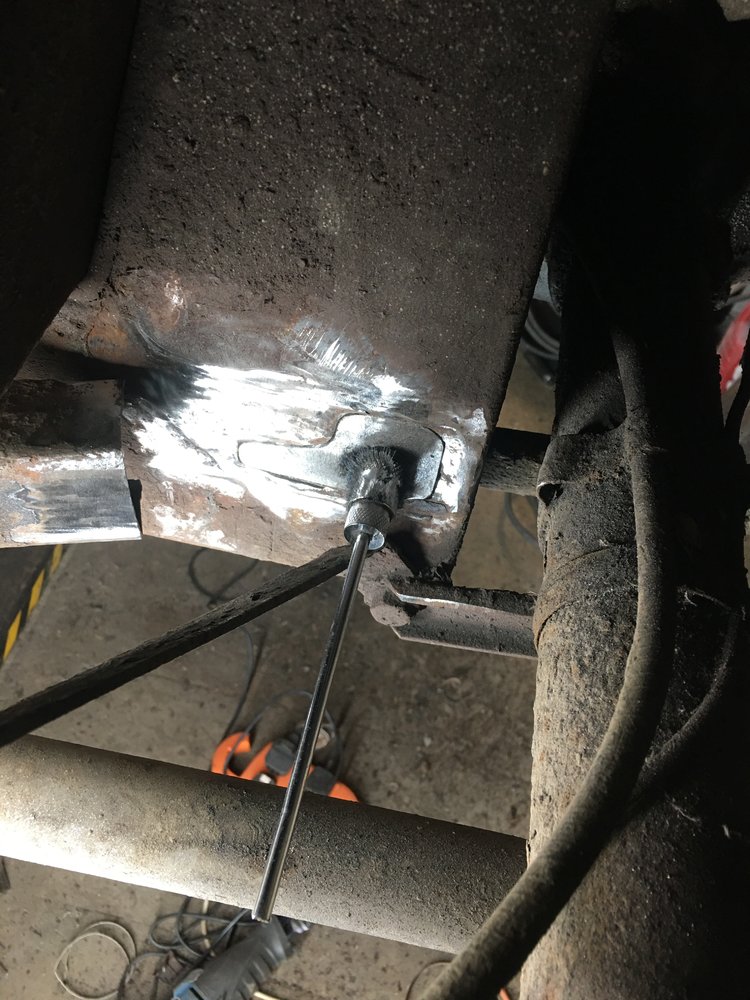

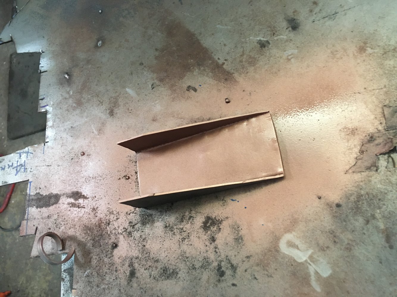

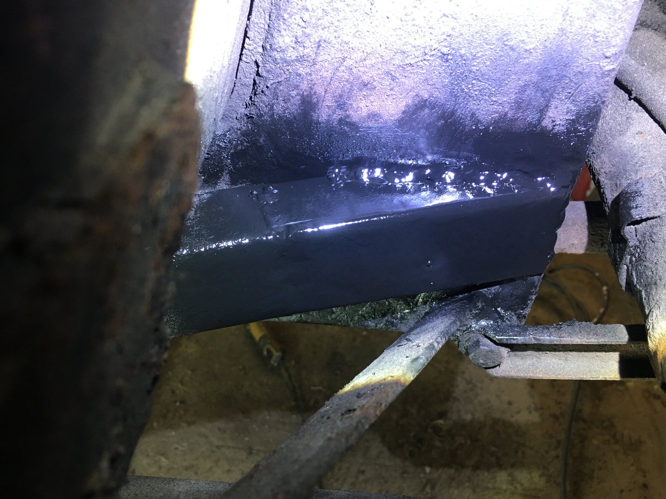

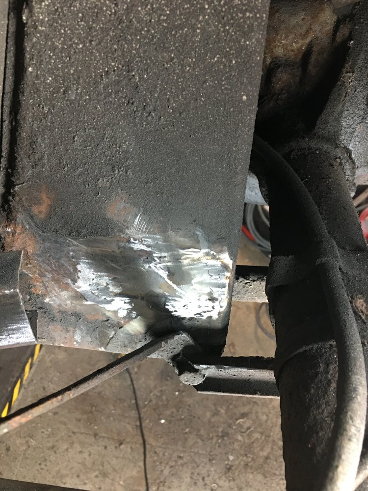

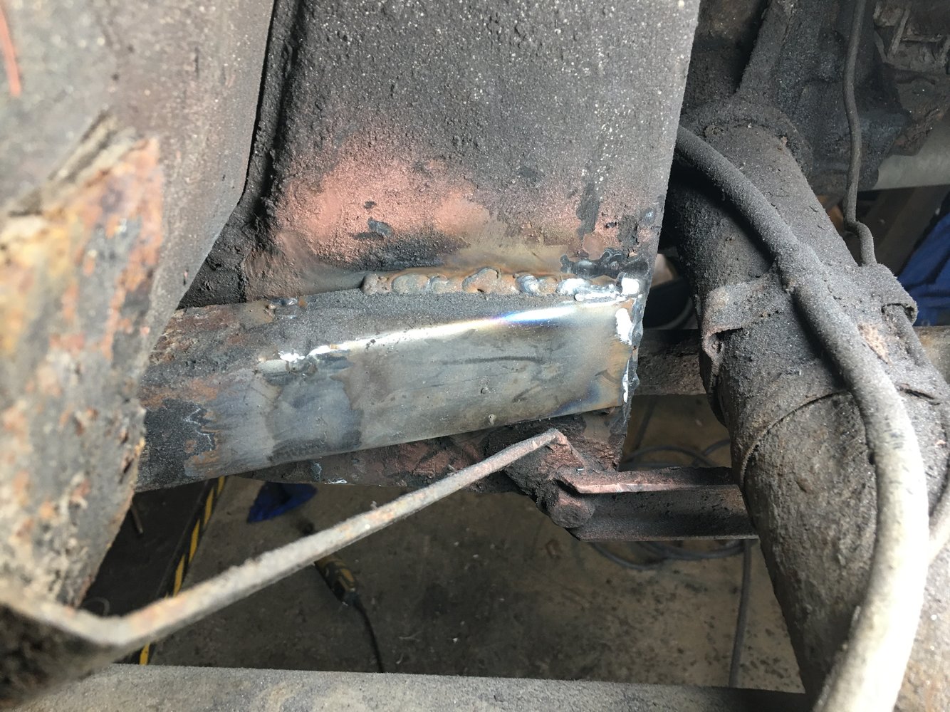

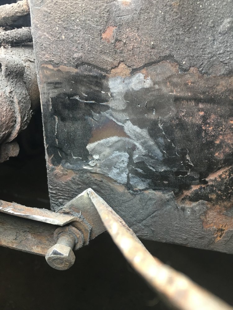

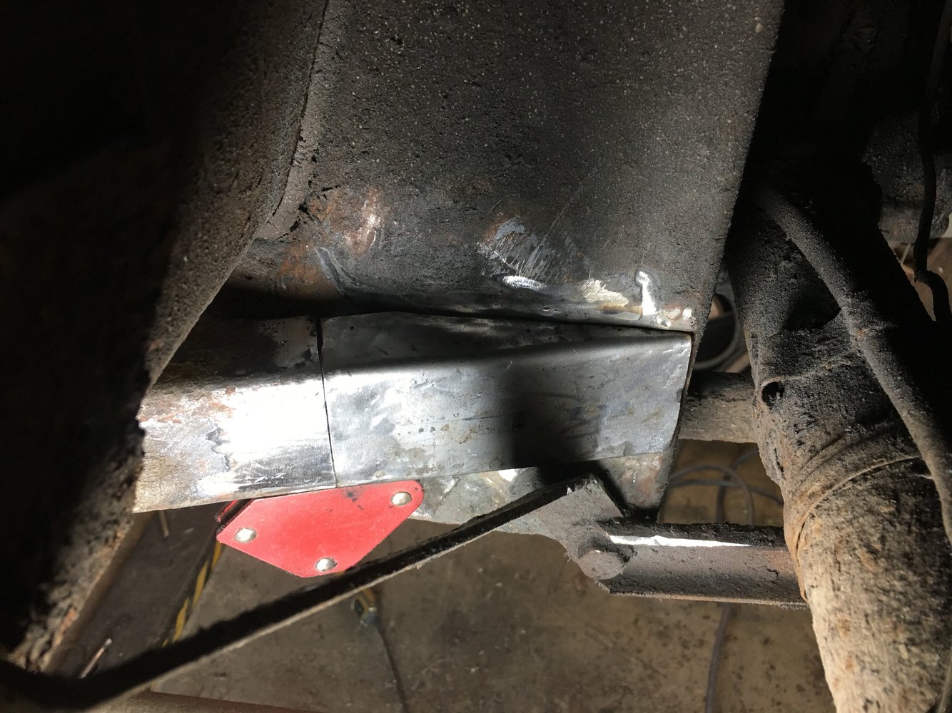

I had to make my own repair section as I couldn't find any C section in my pile to cut it from. It fitted reasonably well, but the welding was an utter nightmare as access was so difficult. I could only seam weld small areas, the rest had to have joined up spot welds. Grinding back, even with a 12mm finger file was very difficult too.
One side done, just the other side to do now, probably tomorrow.
