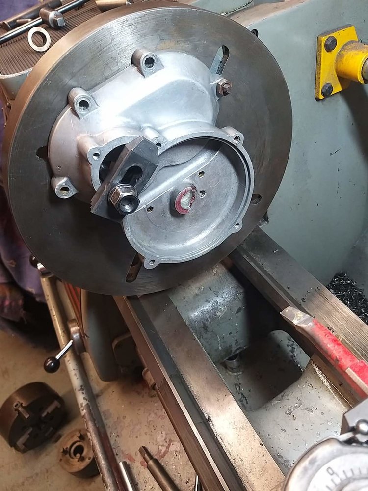

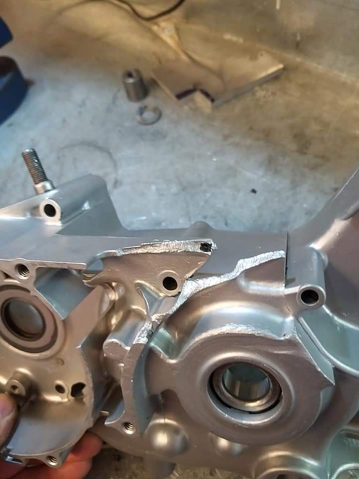

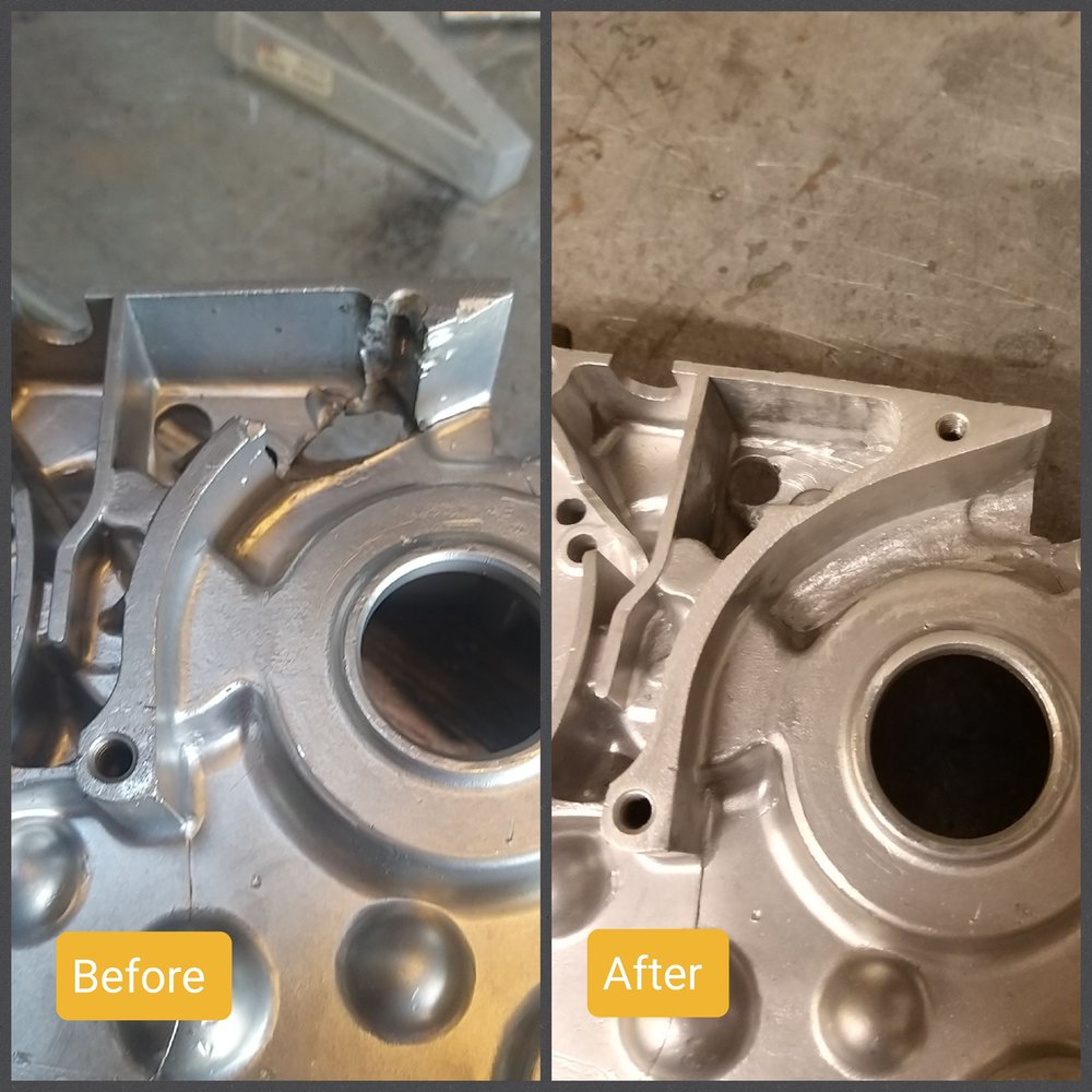

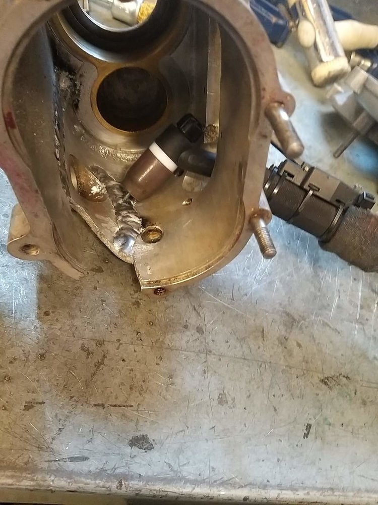

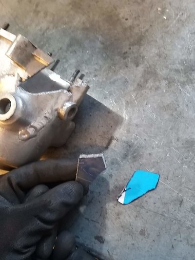

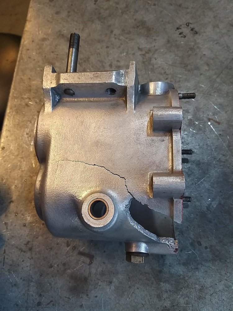

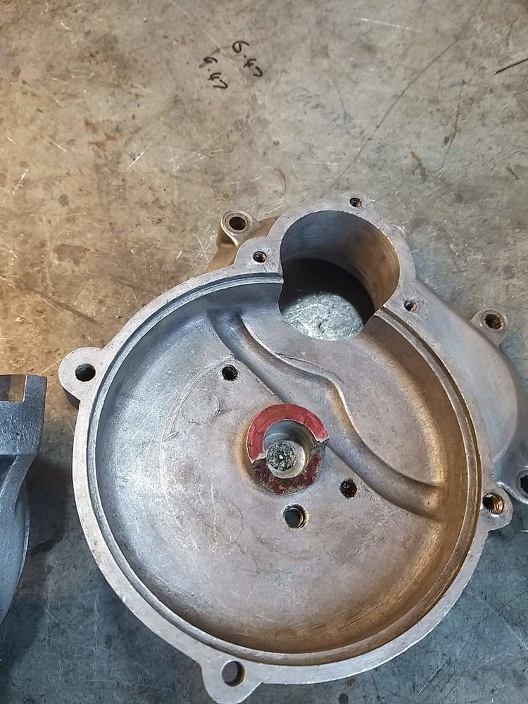

This came in for repair. It's a left side engine case for a 1975 Honda CR125

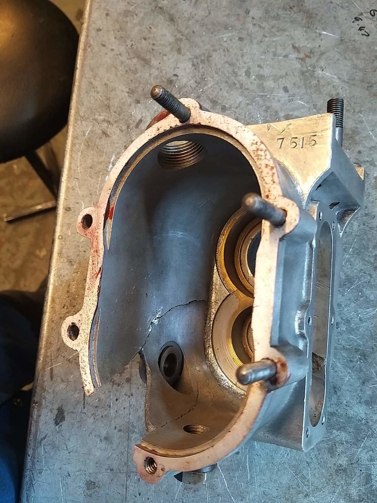

At some point in its life the chain snapped and destroyed part of the case.
This is before

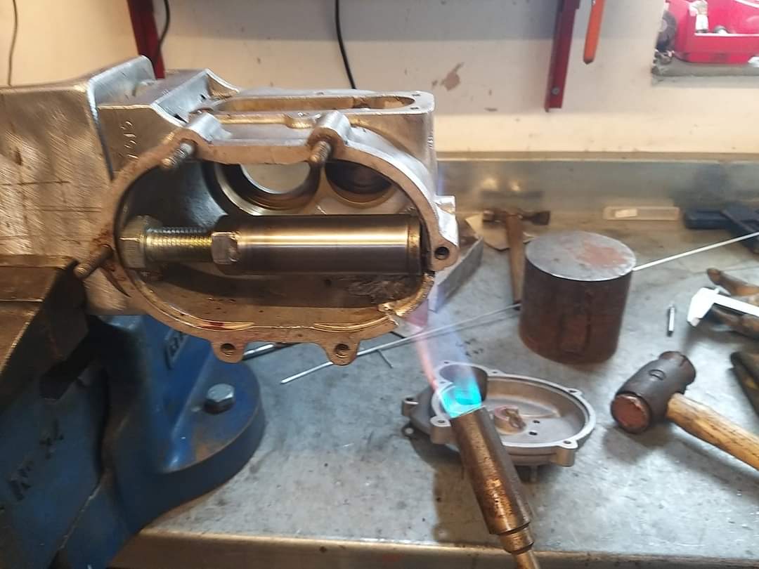

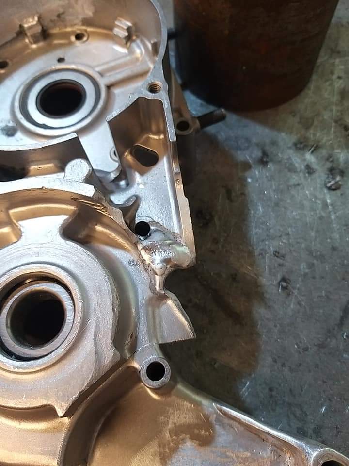

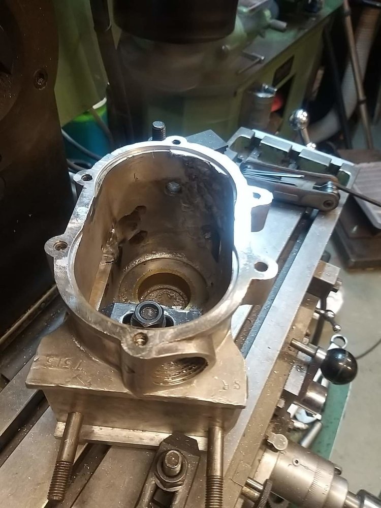

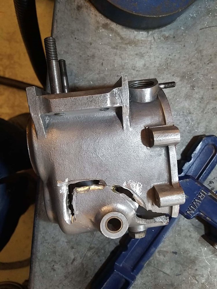

Starting to TIG up the hole

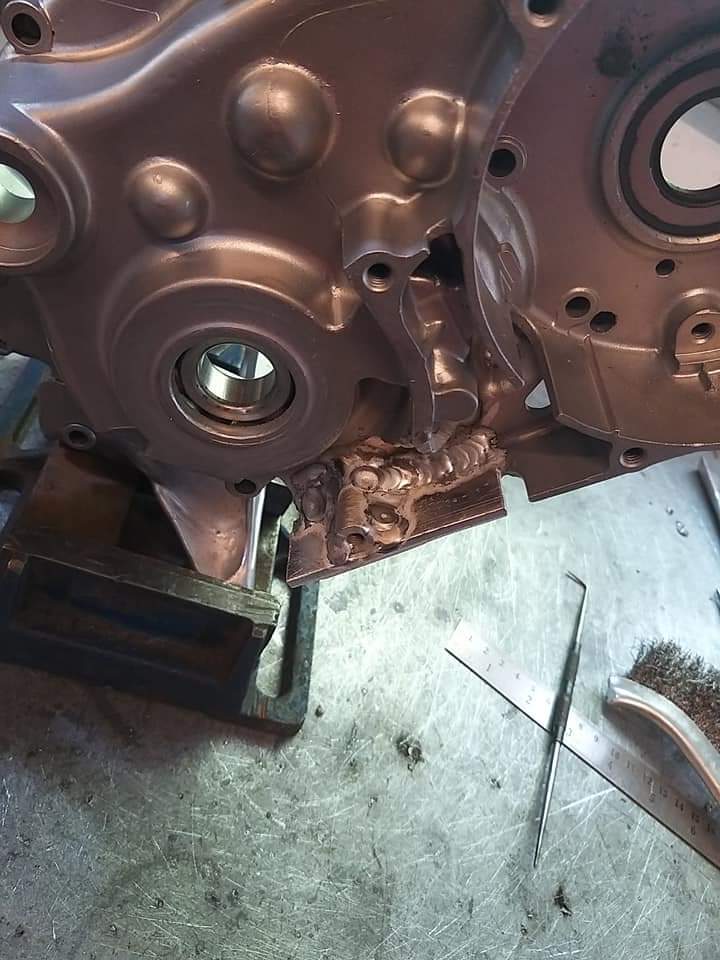

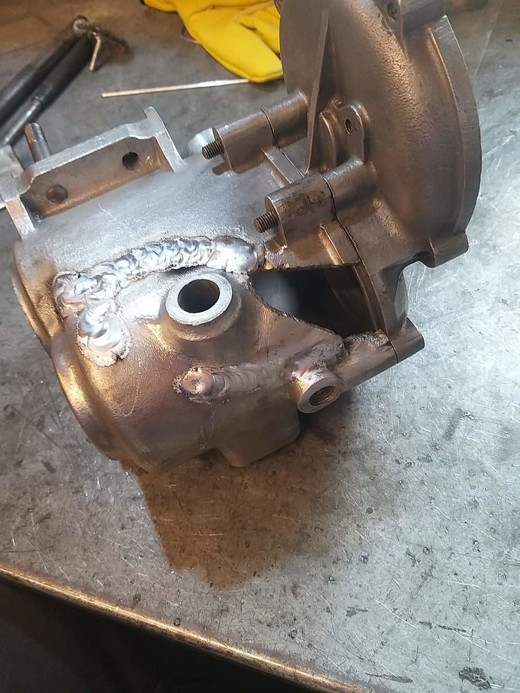

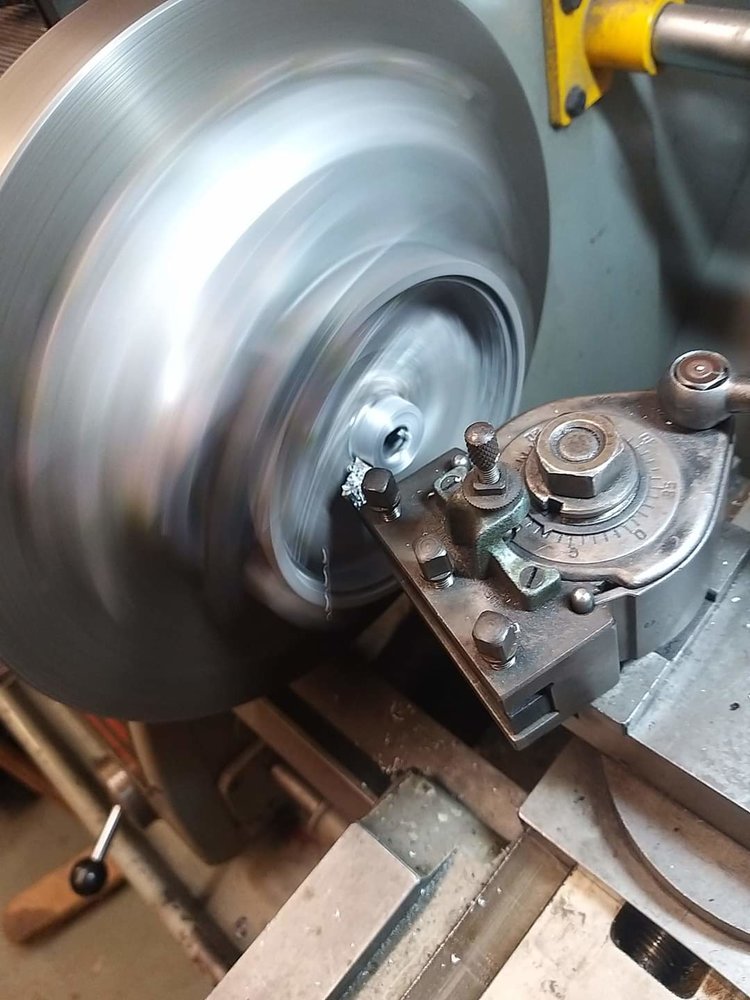

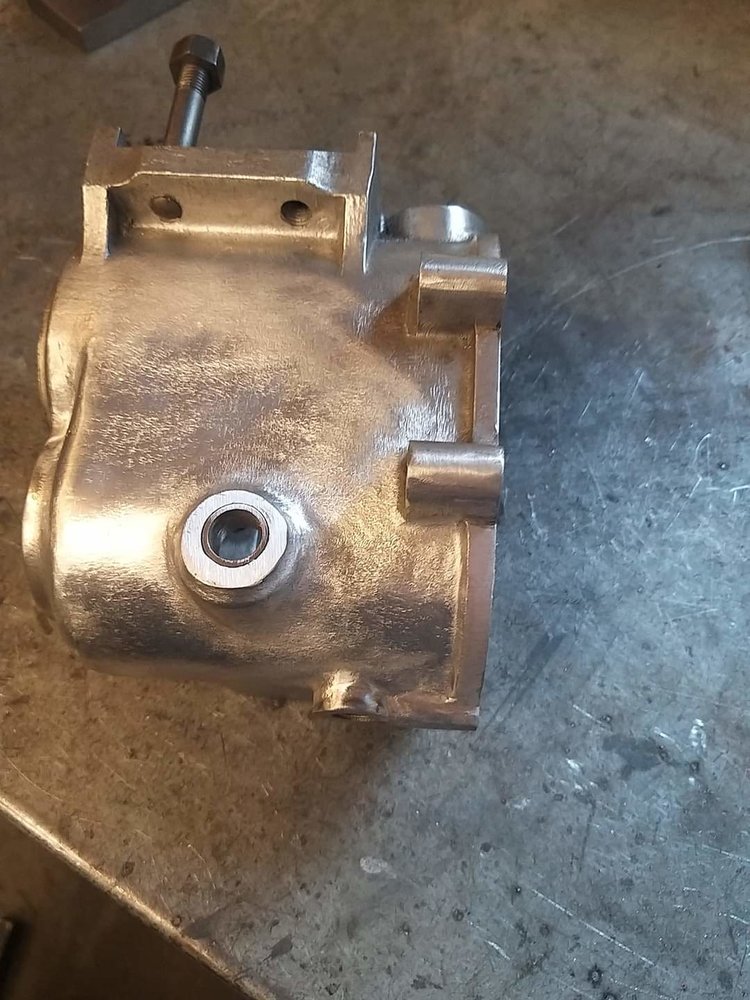

Machined a threaded boss and welded in

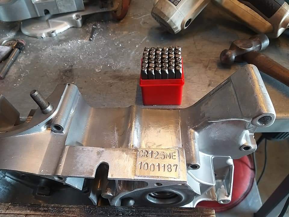

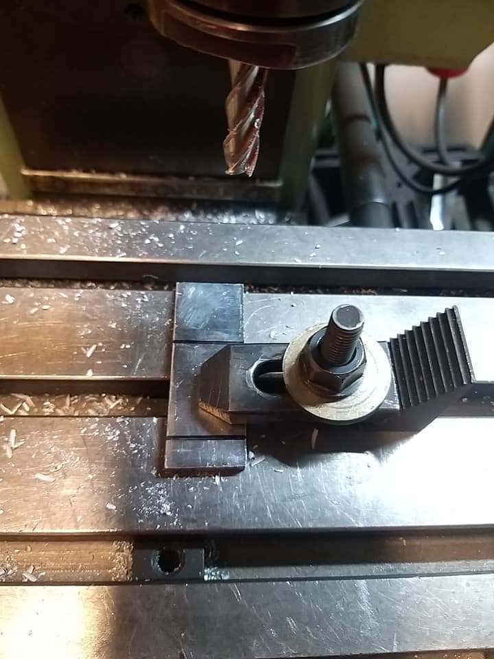

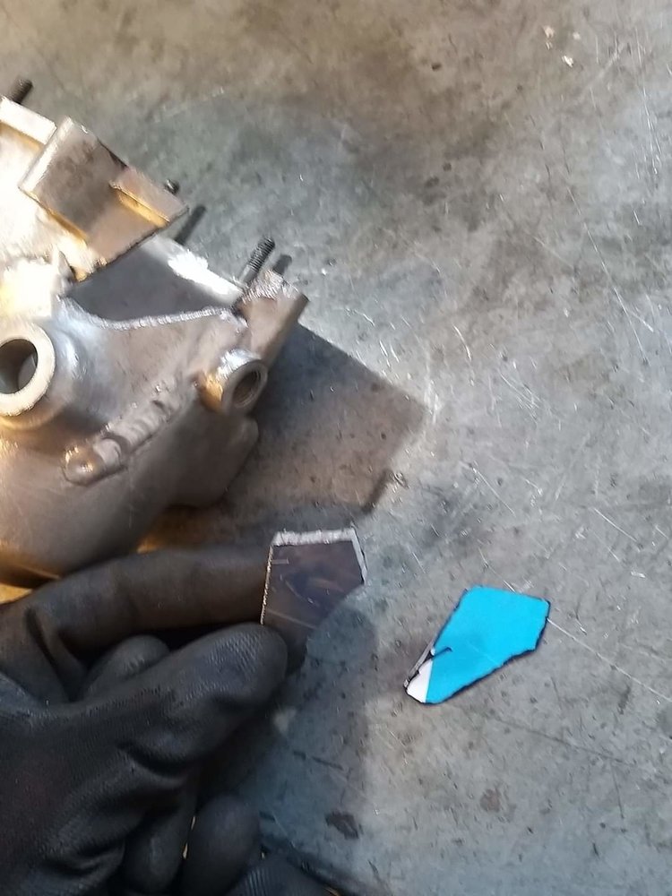

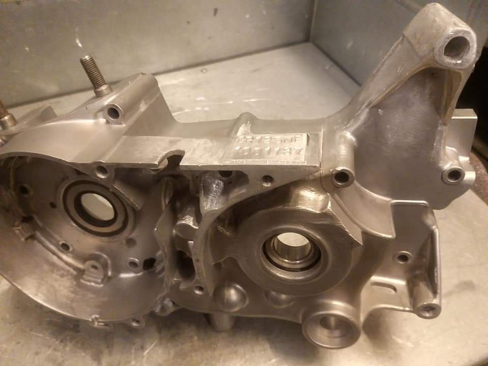

Milling out a new id plate
Welding that in

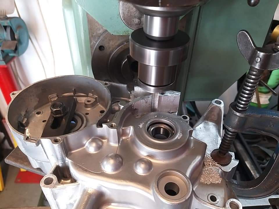

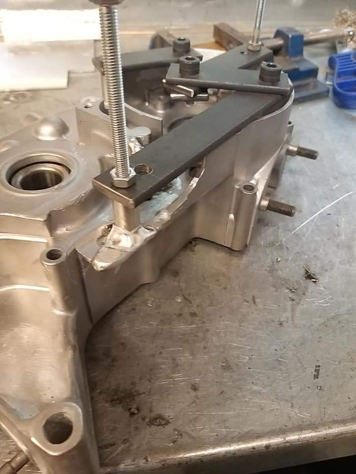

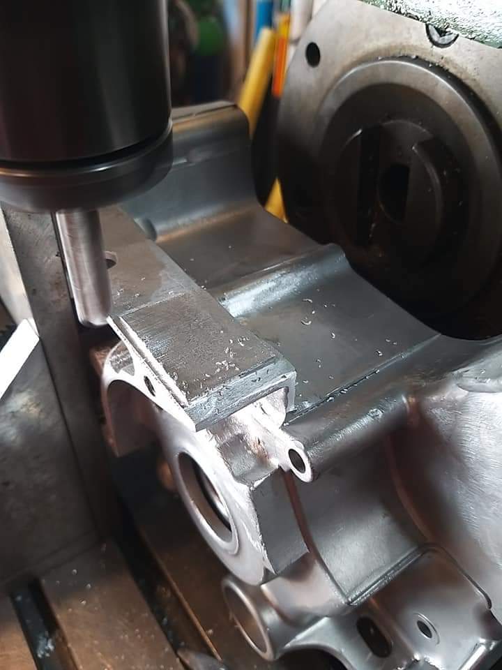

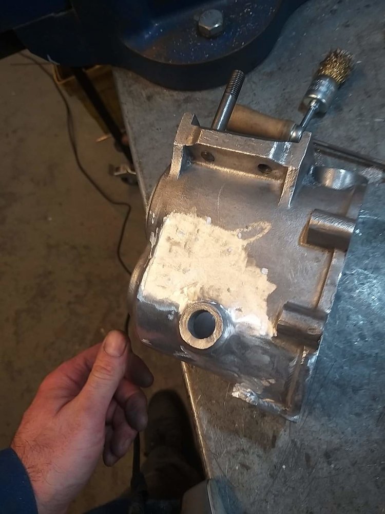

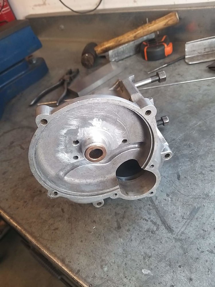

Lots more welding in pieces to restore the shape then back on the mill to whittle it down

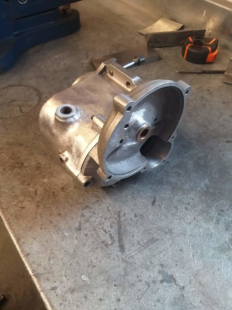

Finished article
