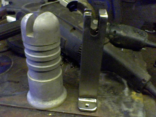

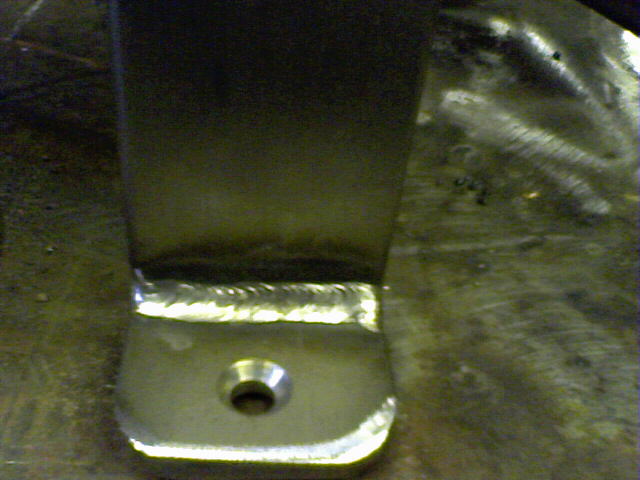

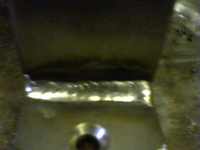

Just some photo's of a little job im doing with stainless steel, theoretically i should put this in the projects section. But its going in the Arc welding section here because all this stainless work was done using arc rods. Its all 304 stainless and welded with 312 disimilar rods (should have been done with 308 rods which i was going to get from weldequip, but the guy im doing the job for wanted it done yesterday, so even with his super quick service it wouldnt have been quick enough and the 312 rods were to hand) The first pic is the unit i have made next to its plastic counter part, they are just brakets to hold partioning up in swimming pool changing rooms. The plastic version look remakably like something else.
