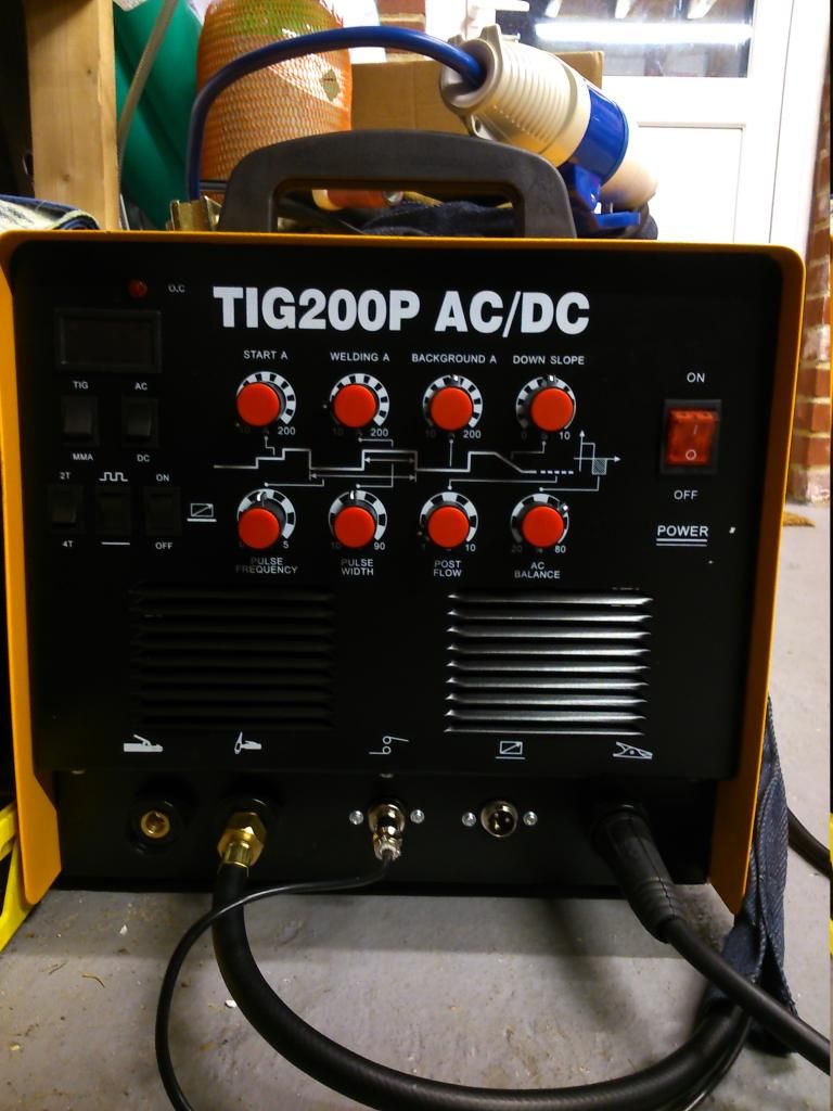

Hi Guy's I am new to the forum. I have read plenty off here over the years learning tig welding with my DC welder.
I got a cheap chinese one a few years ago for some odd stainless projects and it has served me well.
I decided to get an upgrade an bought a chinese A/C D/C pulse welder of the same brand. My stainless welding is not amazing but good enough for what I need. I have made some exhaust system parts using 1.5mm stainless tube and was welding at around 80amps on the welder setting. Which maybe be a touch o the high side but seemed to suit be best.
So my new welder arrived the other day and I thought I would give it a whirl today but I am having issues.
I know ally welding is a bit different so I thought I would see what you guy's think before I jump to the conclusion there may be an issue with the welder.
First of all I ran a weld on DC on some stainless tube offcuts 1.5mm thick. I noticed that I at 80amps it was blowing right through the tube in now time and dropping to around 60amps I could get a reasonable weld but was having to move fast.

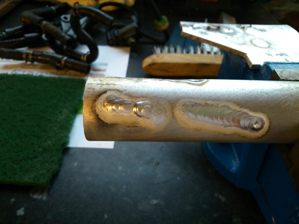

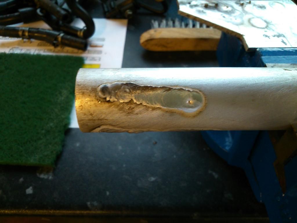

As I didn't have much time to play I thought I would give the ally a quick go. I have white 1.6mm tungstens and found a bit of plate 4mm thick which I just wanted to run some lines on.
What I have noticed is in basic A/C with 50/50 AC balance at 40amps the tungsten is balling up very quick and large and the arc is completely unstable and all over the place. if I drop down to 40amps I can get a fairly stable arc bit no pooling or penetration and just about the right size balling on the tungsten from what I have read. I turned the welder up to 80 amps and it basic obliterated the tungsten. The end just started balling up like crazy and dropping off like a bit of filler rod! It sounds like the amps are completely out of balance or rising rapidly as you trigger on to me? but maybe I am doing something wrong. I tried changing the AC balance and that didn't help. Just got worse or spattered around more on the job.
I am running argon gas around 8-10lpm
Thoughts please chaps.. Have I done something silly or is something in the welder gone?
Side thought.. once the clean tungsten has balled up when do you need to regrind it and start fresh. Am I correct in thinking you can just cut a square end on a 1.6 tungsten and let it ball?
I tried both options for info. Also gone through about 1/2 a tungsten in 20mins playing! Something is not right!
Cheers
Lee
