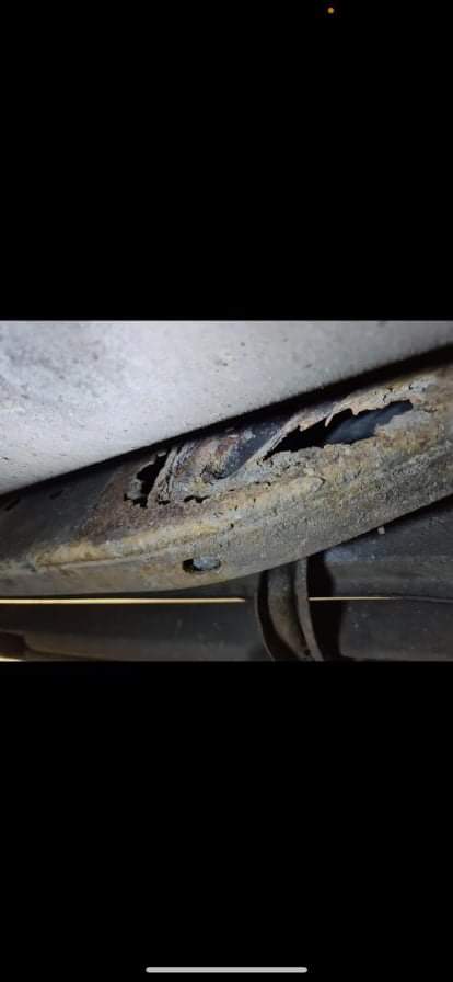

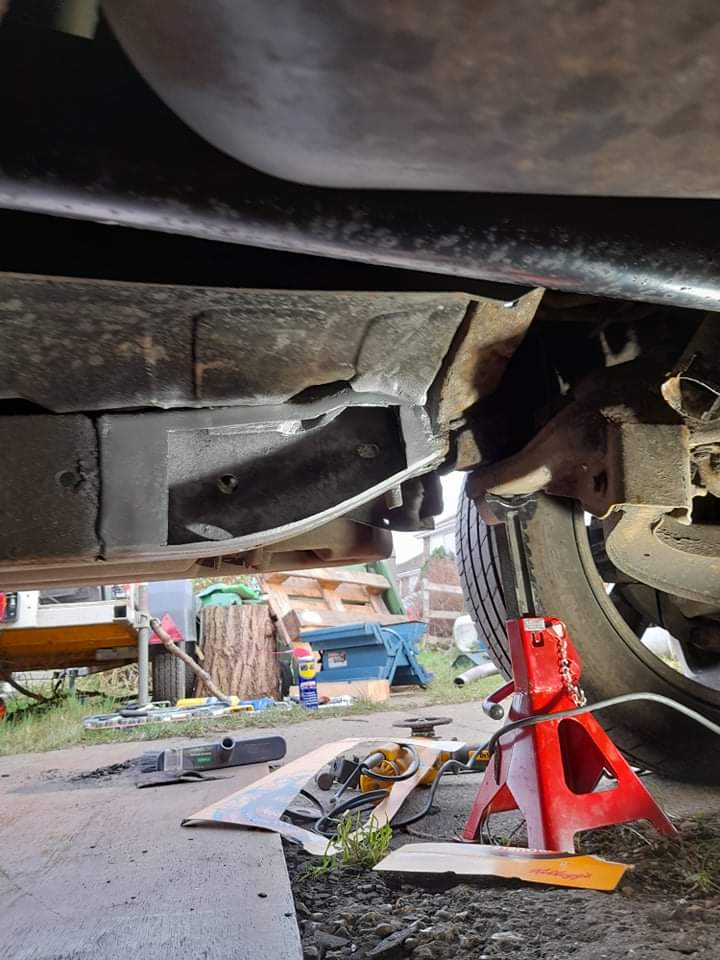

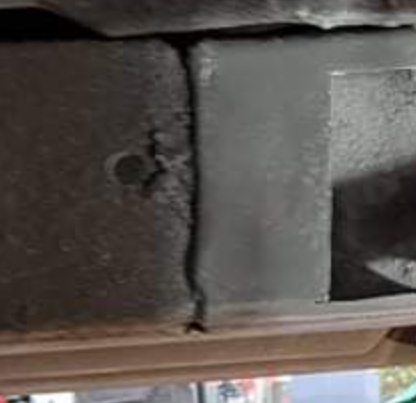

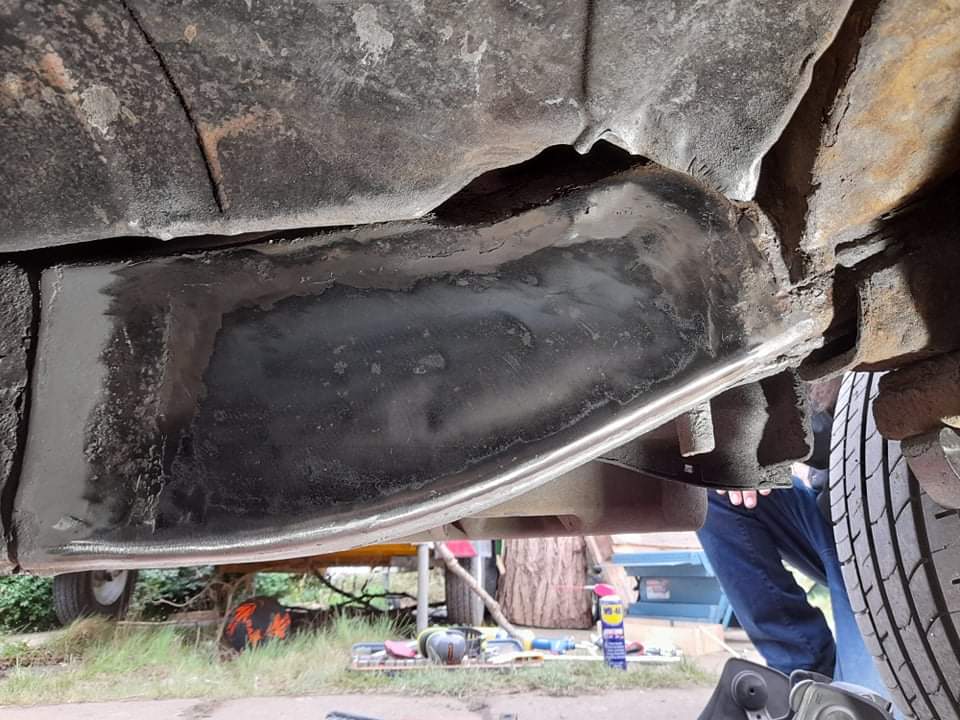

Had a phonecall from my brother saying that his pathfinder had failed it's MOT on an area of corrosion on the chassis and asked if I could patch it up for him. My response no I'm not patching over it, if you want me to do it I'll be cutting it out and laying new steel in and that is what I did.
