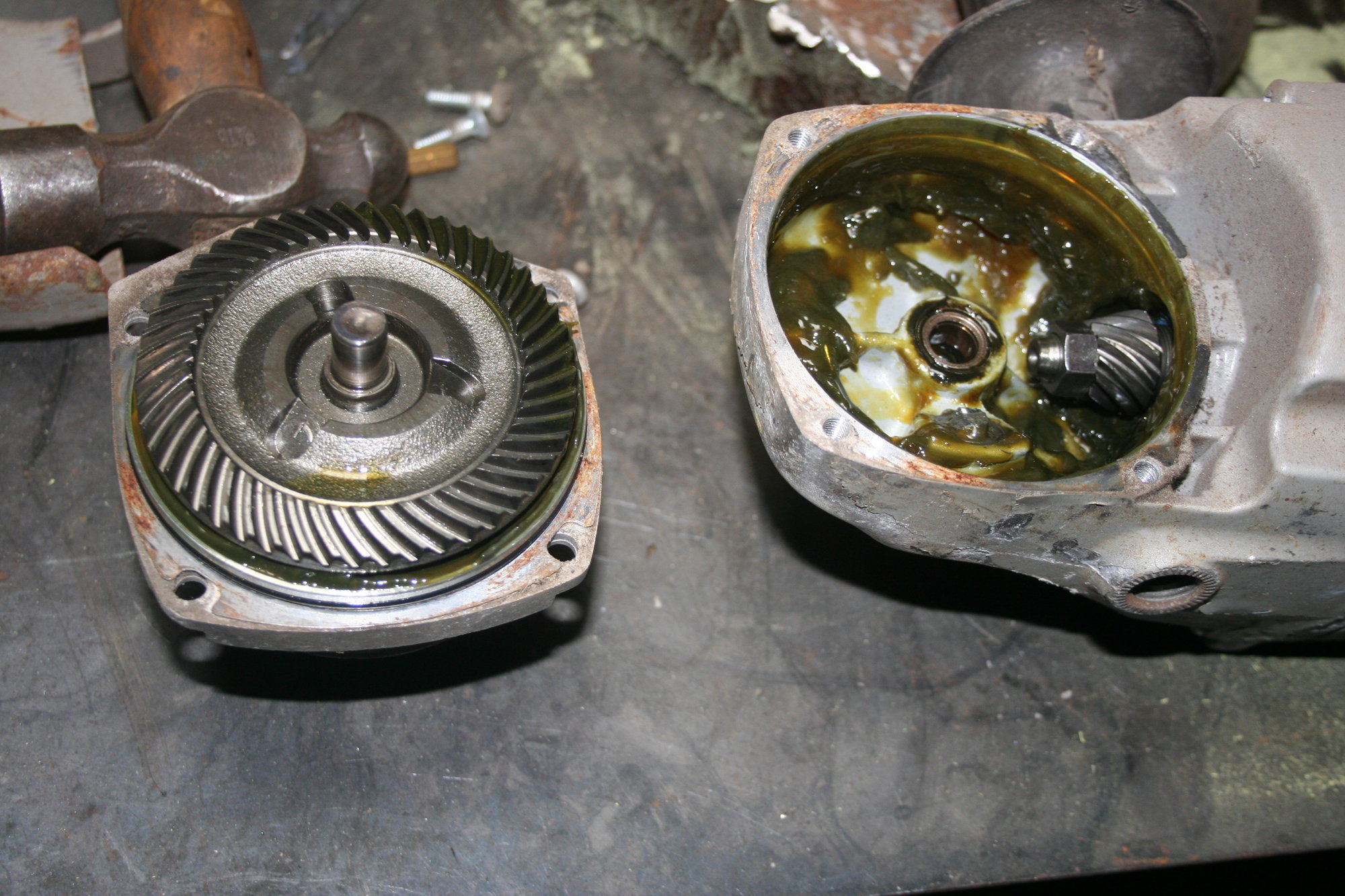

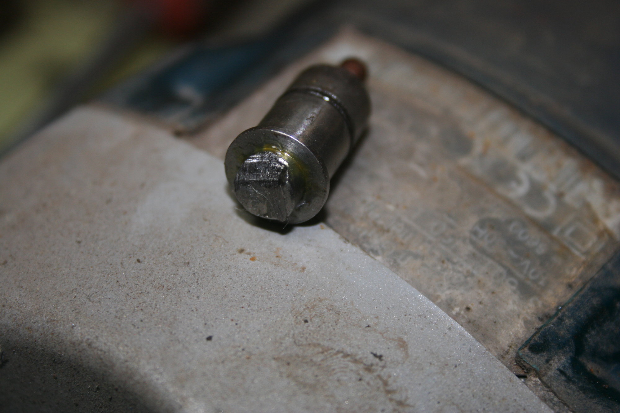

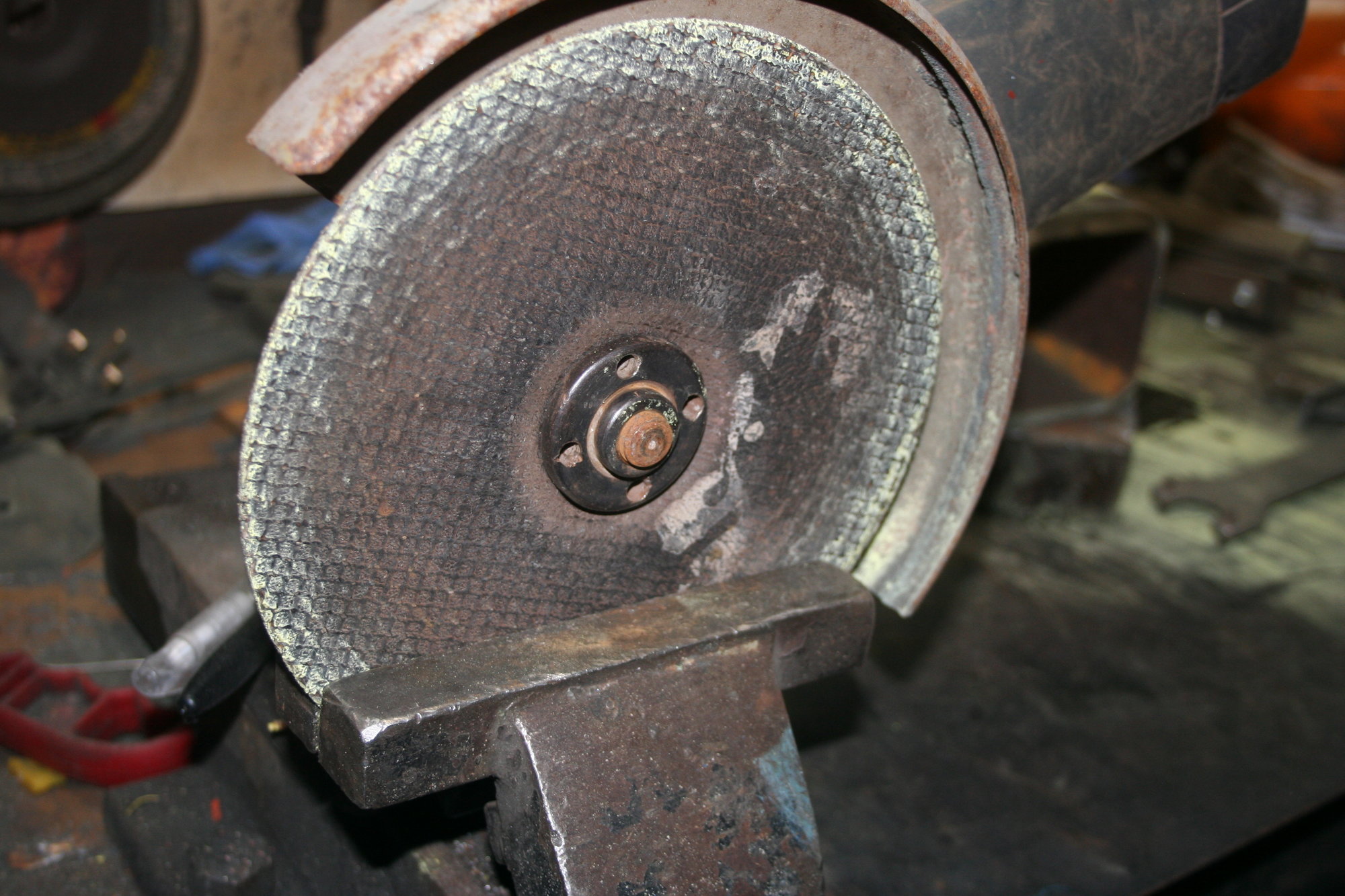

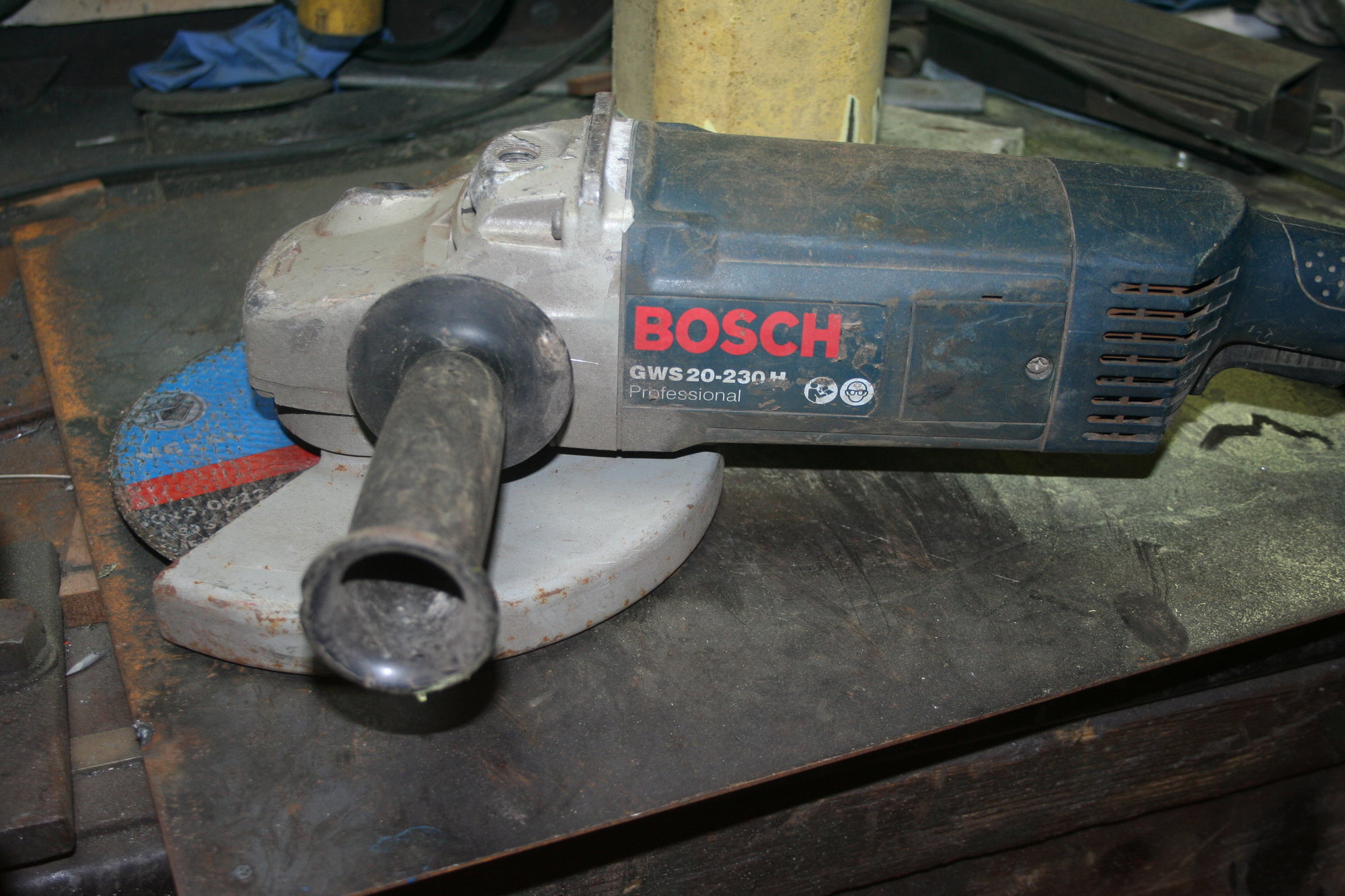

    Found the 9" Bosch grinder I had trouble with, but there were no nuts on it which is a pity.
    I put a couple of nuts on it and gave it a quick go.
    Couldn't get it slackened, but main reason was the lock was slipping.
    Put the disc in the vice and got it off with the spanner.
    It was tight but not mad.

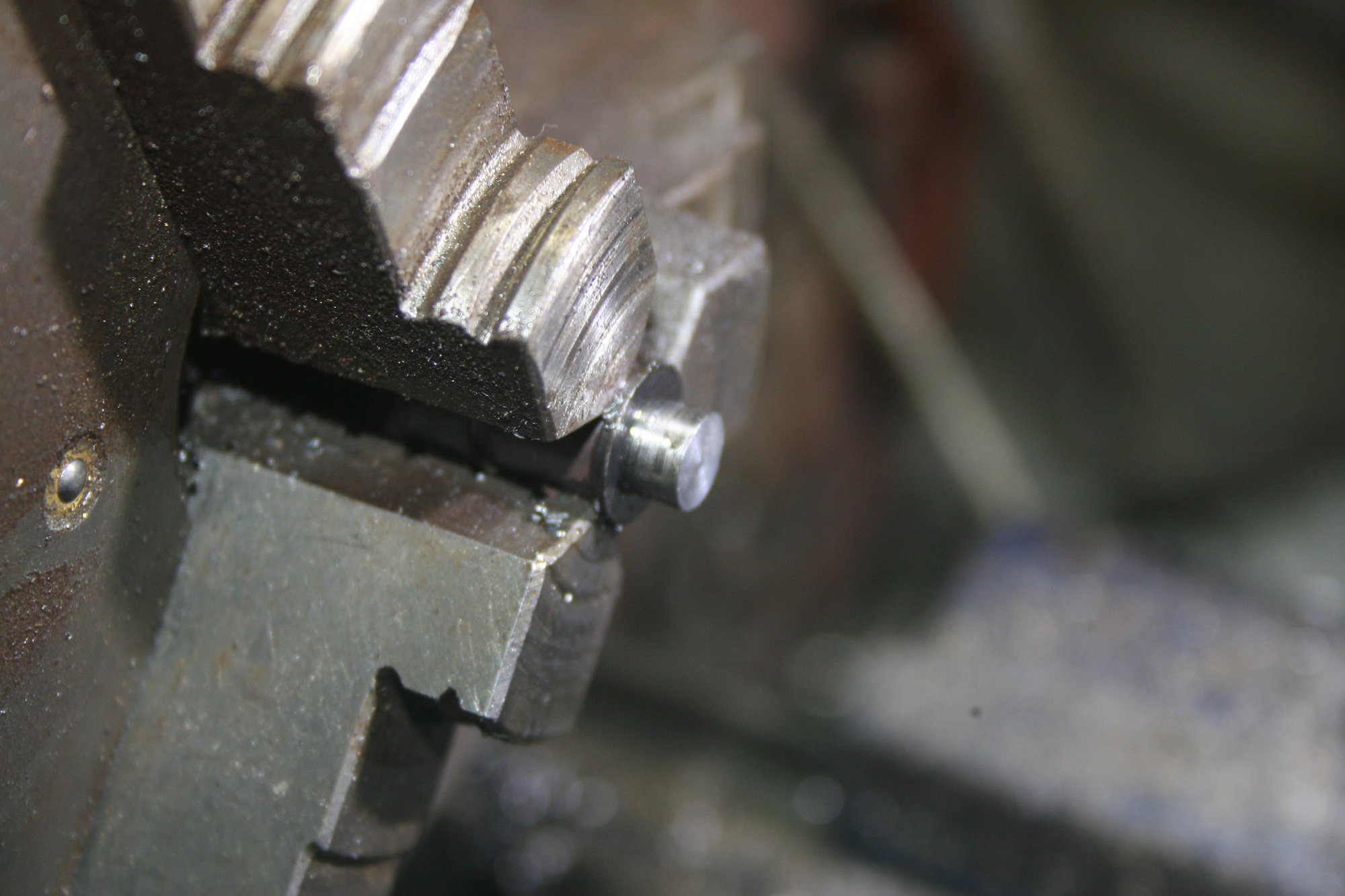

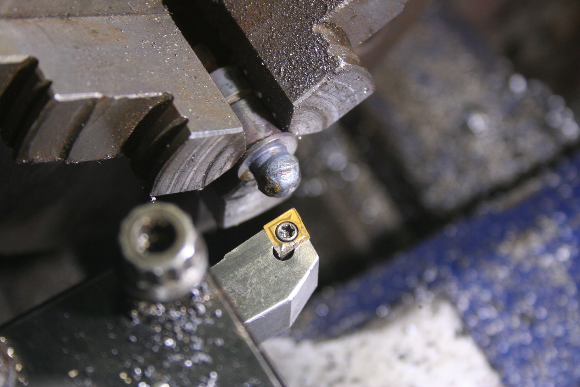

    Thought I might as well see if I could fix it.
    The lock pin is not hardened, it files ok and the gear head isn't marked.
    A couple of dabs of tig and a run in the lathe had it sorted.
    Really easy, quick fix and a lot faster than looking then waiting for parts.
    However I think there could be a bit of chicken and egg here.
    I'm not convinced the lock was the first problem, it might have been wrecked because the discs were so tight.
    It's too late to be running a 9" grinder to see if this is the case, so it will have to wait untill the weekend to give it a workout.
    One of them wee jobs I should have done long ago but when you have other 9" grinders it gets put on the long finger.

    Just to update on my troublesome Bosch grinder.
    With the repaired locking pin I've had no issue getting discs of.
    I am wondering if not having a secure lock was the issue, but I haven’t the original nuts any more.
    I’ll put it on the tool board and use it as my go to 9 inch and see what happens.
