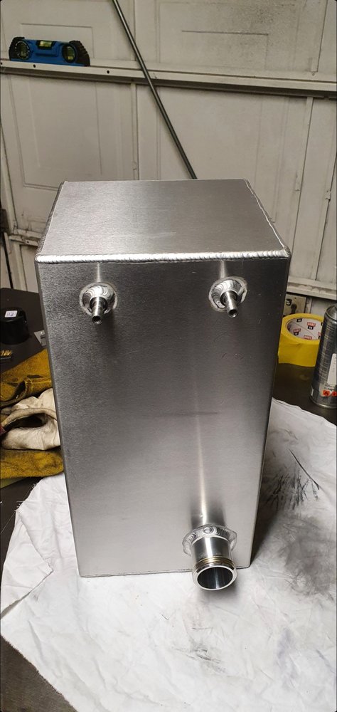

Harder to get than I thought8mm (5/16") is difficult to find. Is that OD or ID?
https://shop.useful-tools.co.uk/hand-beading-tool-4-p.asp (does not go small enough, but they might make you a special)Small Tube Beading Tool, 1/4" and 5/16" O.D. Tube — Graham Tool Company, Inc.
Designed in the USA during WWII for aircraft applications. This is a proven tool with a long history. Available to the public by popular demand. Manufactured in California using 100% USA materials. Useful to form a bead on rigid tubing for hose and hose clamp applications. Works on tube from 1/4&quowww.grahamtool.com
https://www.earls.co.uk/earls/accessories/tools/beadingtools.html (does not go small enough, but looks possible to copy)
https://aeroflowperformance.com/af98-2019-pipe-beading-tool-suit-5-16-or (correct size; no UK dealer. Nearest is in Holland or buy from Australia)

The Aeroflow one is available in UK here: https://www.b-gdirect.com/pipe-beading-tool-5-16-inch but out of stock.
Honourable mention to this: http://www.roadraceengineering.com/eclipsetech/icpipebead.htm
The grahamtool one could be made out of a pipe cutter (e.g. https://www.toolstation.com/monument-pipe-cutter/p17299) but an older one with a steel body that you could weld to would be better as you'd need to replace the lower cutting wheel with a cantilevered axle with the bead profile on it.
