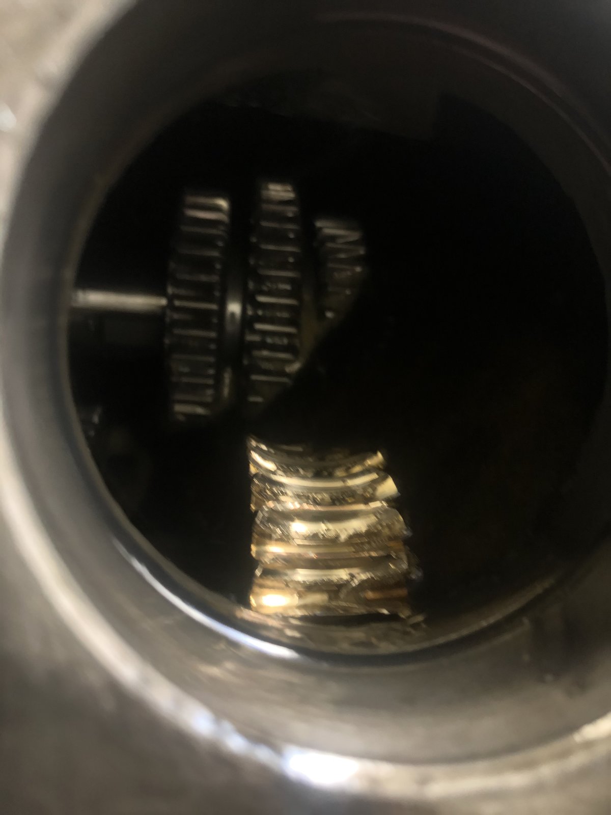

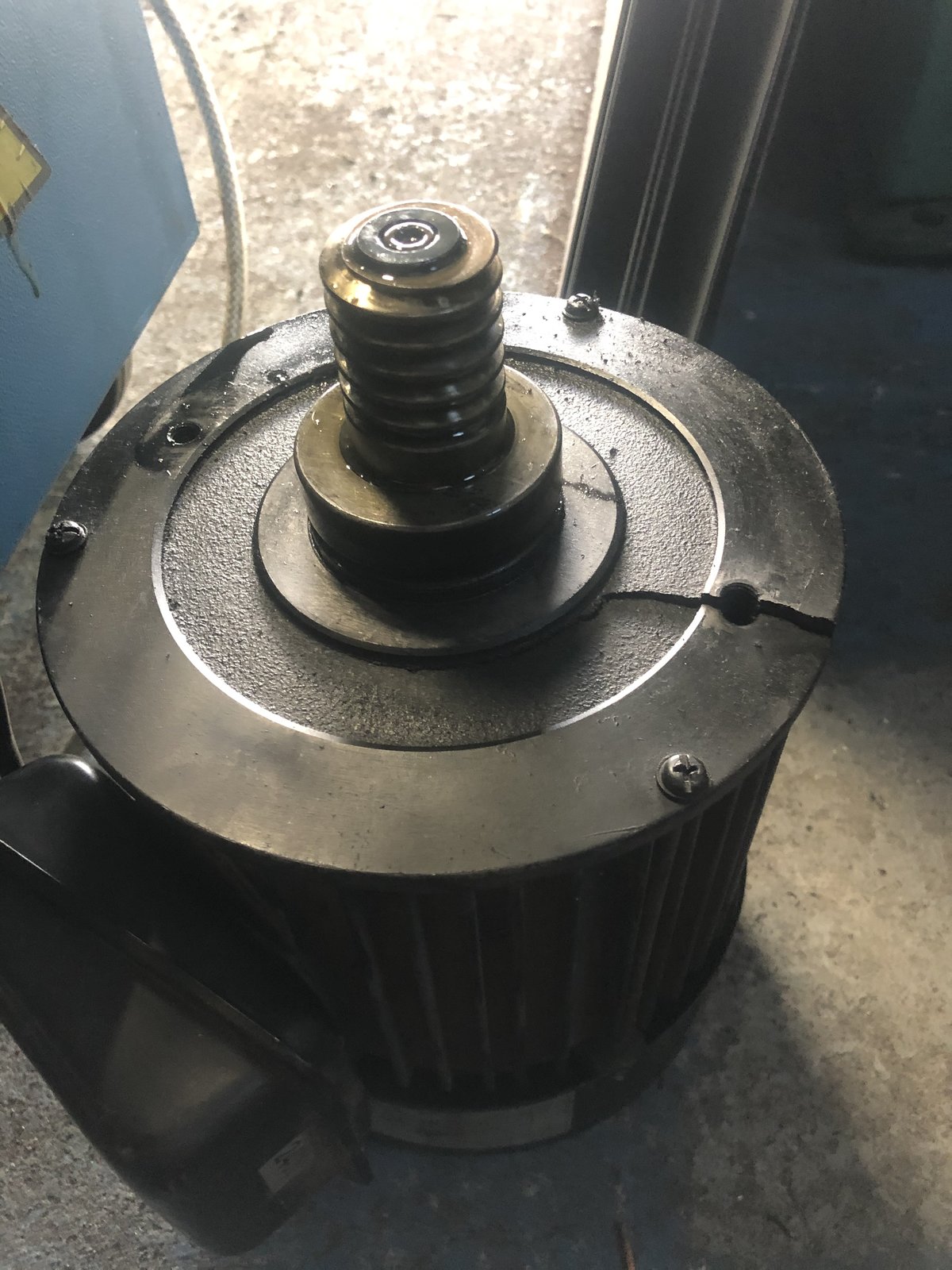

Just went to use my bandsaw today and it’s not playing ball I’ve known that the motor mount was slightly cracked.
It looks like this has spread further and probably some manky Ali cast so no way I can weld it so I can only think a replacement motor is the only way to go.
looks like now it’s affected the brass gear inside!

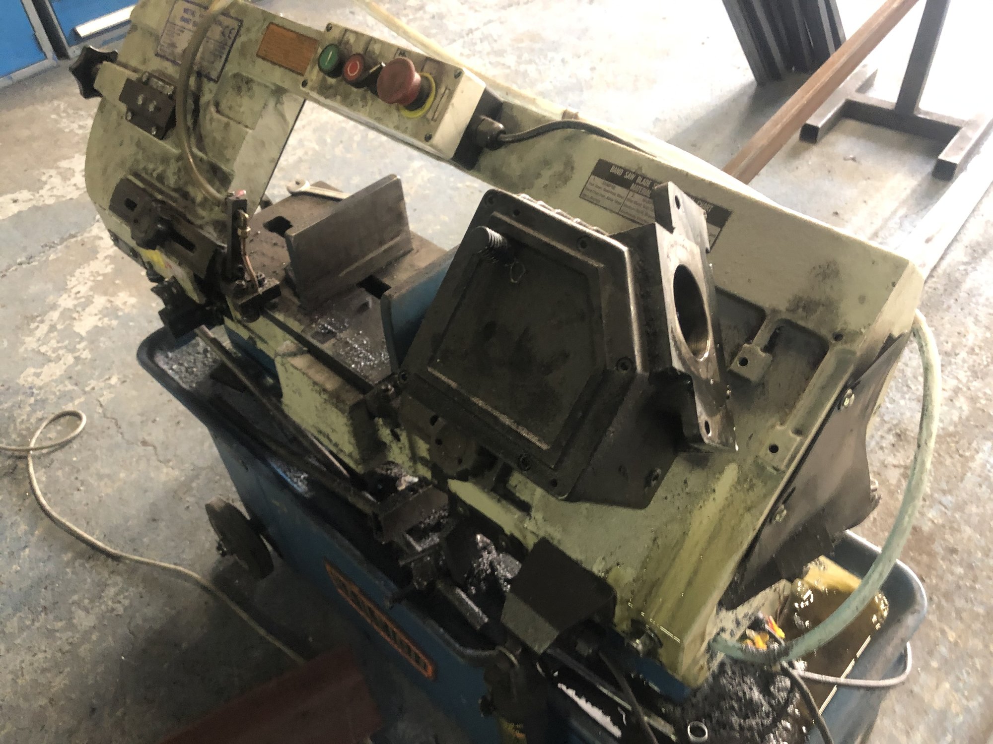

it’s a baleigh 7x12 sized bandsaw. Can anyone suggest anywhere I can get parts from? Going to baleigh themselves Isn’t really an option as they are useless for after sales.
if not I’ll cut my losses and get rid of it I’m currently rebuilding a cold saw so was planning to replace with that and sell this on.
