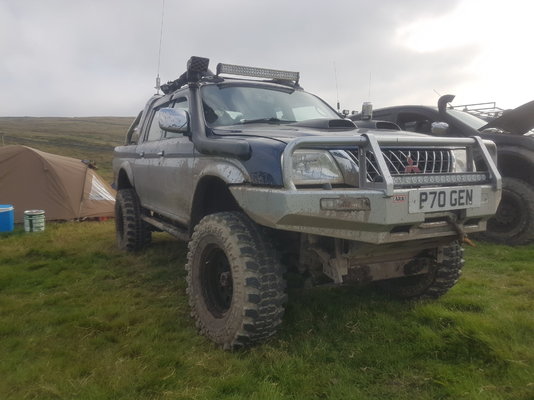

Did you have a flag on that??? Wouldn’t be much to see from behind!

Completely off topic, can you get me some measurements of that front bumper please? Been looking to make one so I can add a winch etc to my pick up. Not paying daft prices they want on eBay for one though!!
Sure pm me what measurments u need and I will.get the rule out
