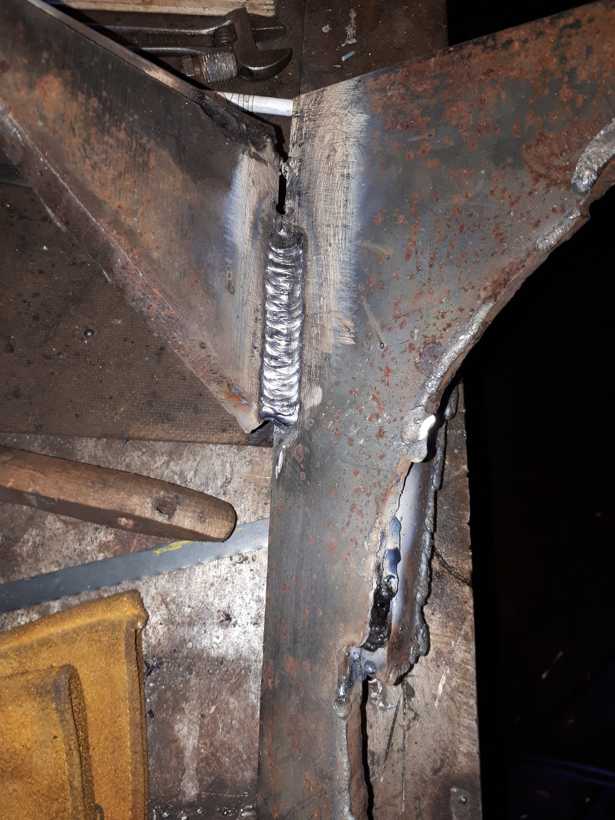

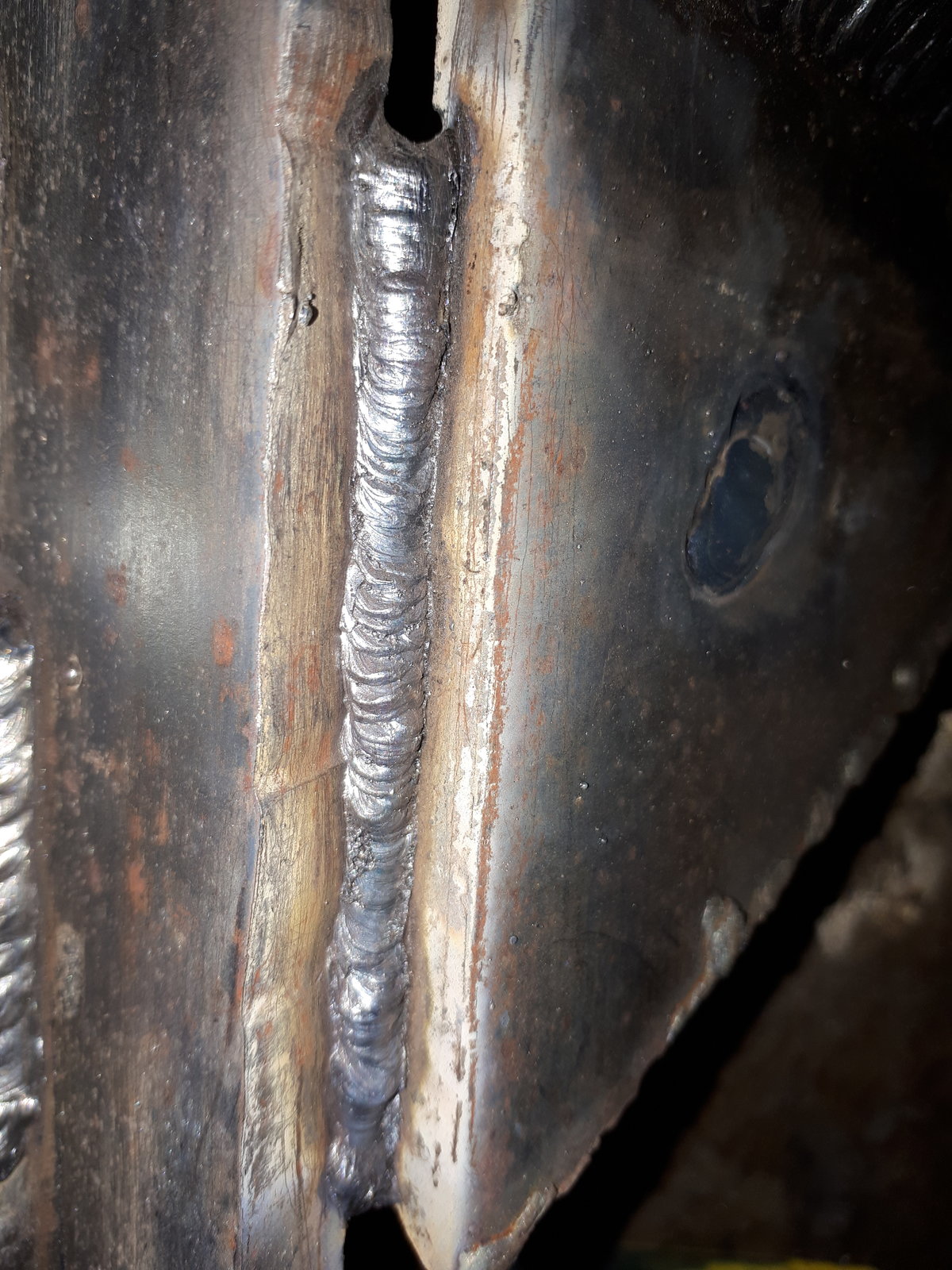

A vertical up weld should look like a flat position weld or as near as keep a tight arc 90 degrees rod angle and slightly osolation of the rod or slight weave moving forward. Do you stick weld lots and in the flat position
