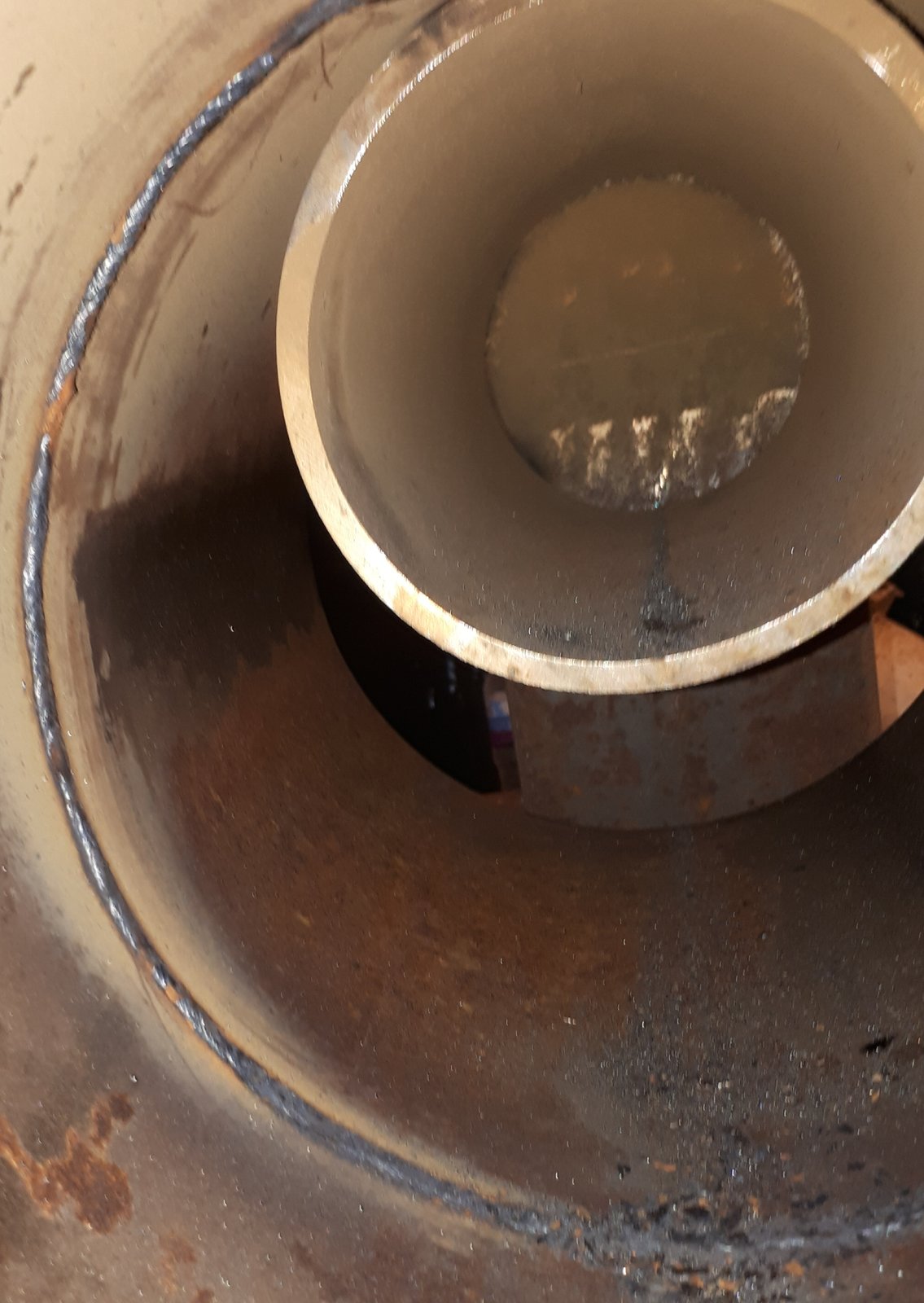

V Vambo Member Messages 50 Location Kent England Oct 24, 2018 #21 Update: Had another go and found that if I literally touch the rod to the workpiece it fires consistently with no stuttering or going out. Have to say its fascinating to see how deeply the rod penetrates the metal.
zeppelin builder Member Messages 2,124 Location peoples republic of scotland Oct 24, 2018 #22 thats why you can root with a 4mm downward with a 1 mm gap if you have the knack
