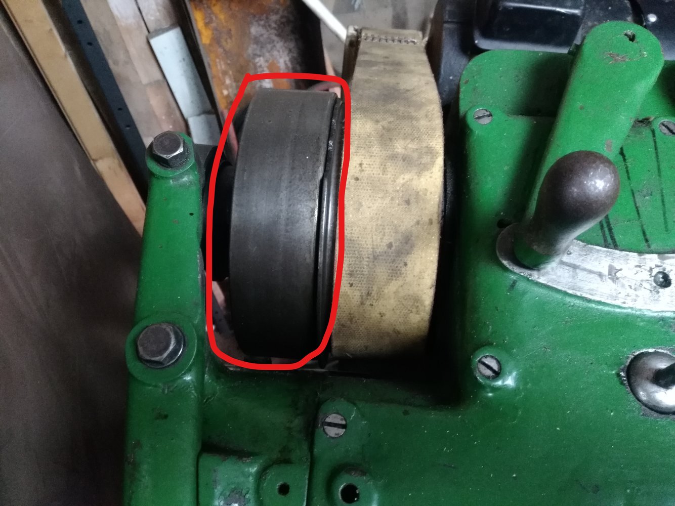

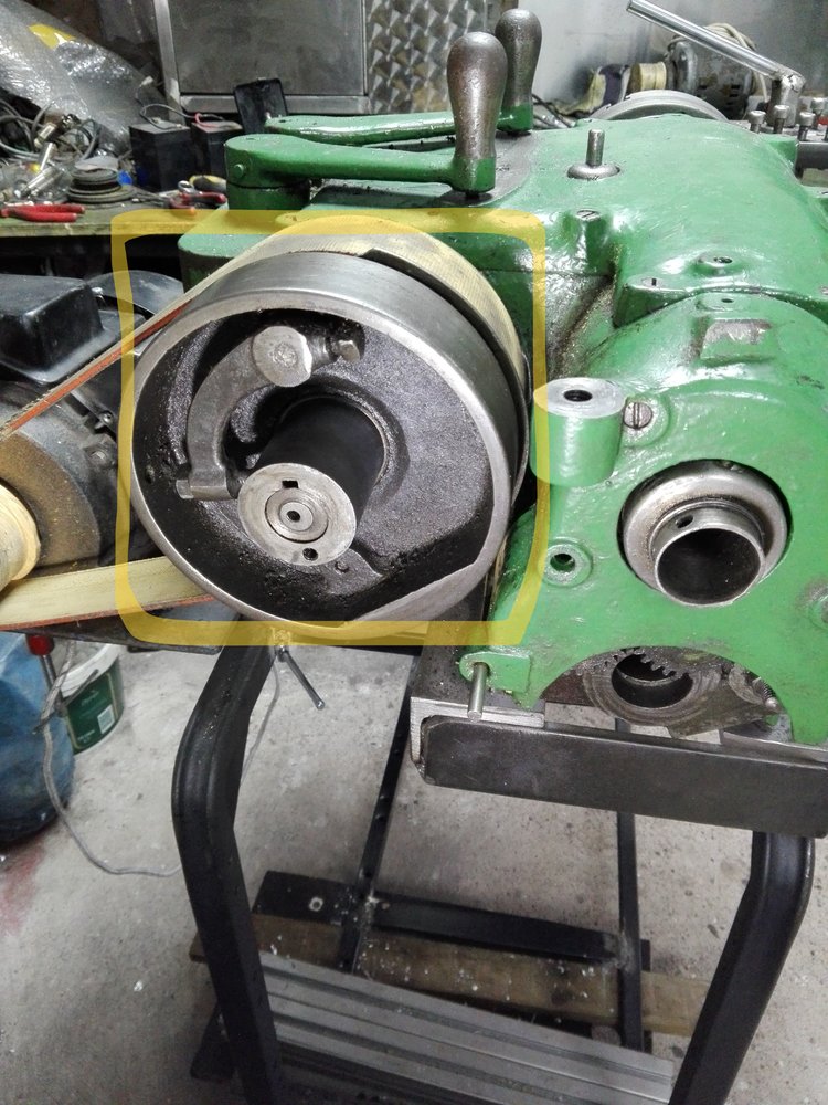

I Ido New Member Messages 5 Location Derby, UK Oct 10, 2023 #1 Hi, I have 6" Leader Lathe and would like to know how to dismantle part highlighted in red - in the second photo. Thank you

Barking Mat Cuddler of hedgehogs. Messages 12,310 Location France, Brittany. Oct 10, 2023 #2 Some photos taken from the left hand side might help. Dismantle bit on left, some pullers ?

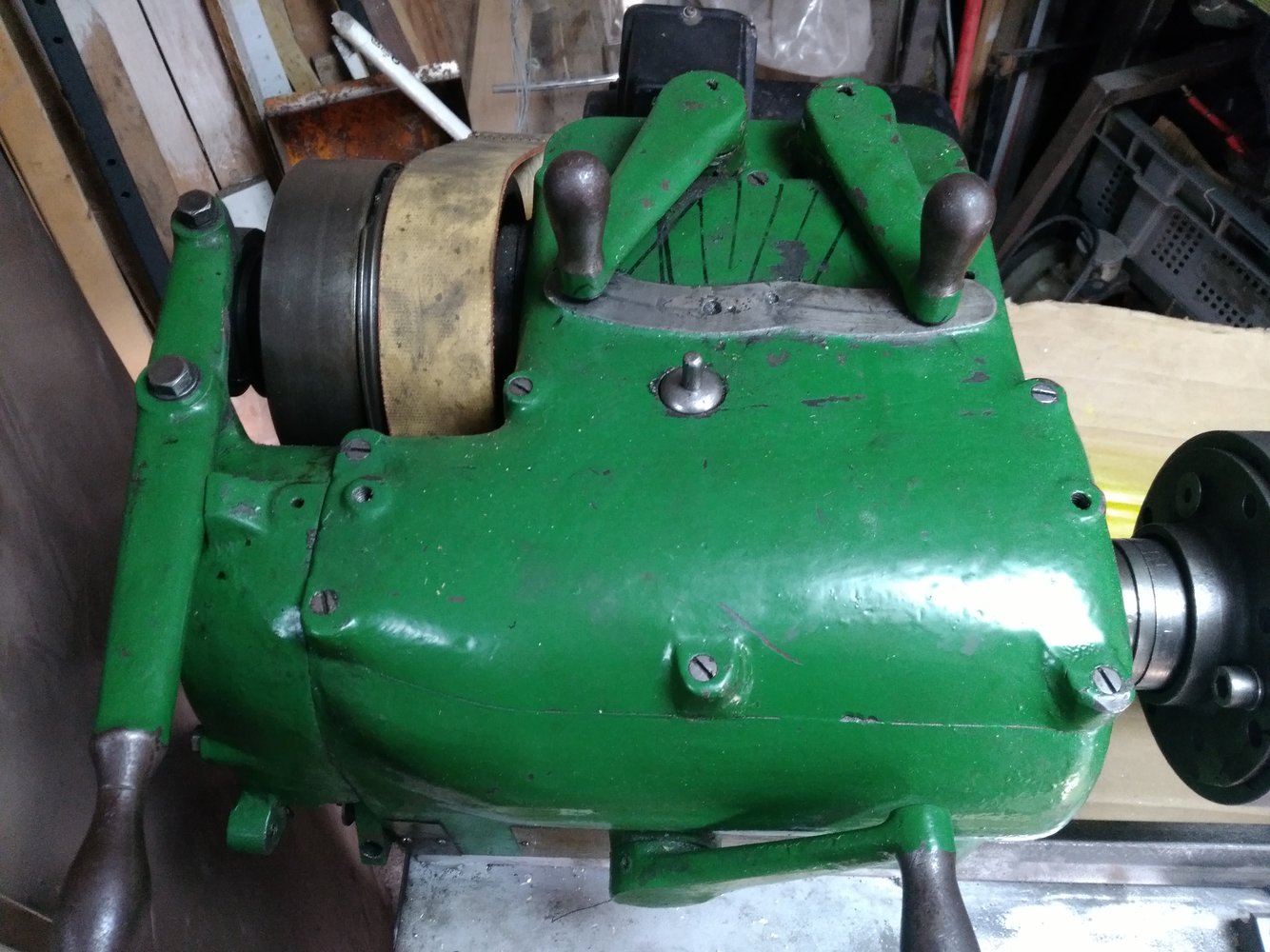

I Ido New Member Messages 5 Location Derby, UK Oct 11, 2023 #5 Hi, here are the images from the left side. Thank you.
Barking Mat Cuddler of hedgehogs. Messages 12,310 Location France, Brittany. Oct 11, 2023 #6 I'd start by removing or slackening the two hex heads on the rocker arm thing, if it's attached ? That round bit is on a keyway / wood ruff key, anything in the round hole, setscrew ?
I Ido New Member Messages 5 Location Derby, UK Oct 12, 2023 #7 Hi, there is nothing in the round hole. Also could not see any hex heads.
Barking Mat Cuddler of hedgehogs. Messages 12,310 Location France, Brittany. Oct 12, 2023 #8 Two bolts, attached to that rocker arm. Try a puller on the cylindrical bit.
Seadog Save the planet. It's the only one with rum! Messages 11,459 Location NE London - UK Oct 12, 2023 #9 No grub screw opposite or on top of the Woodruff key?
I Ido New Member Messages 5 Location Derby, UK Oct 14, 2023 #10 Hi, there was no screws but I managed to get the job done by using a hammer and hitting it in the middle. Everything separated then. Thank you for your help.
