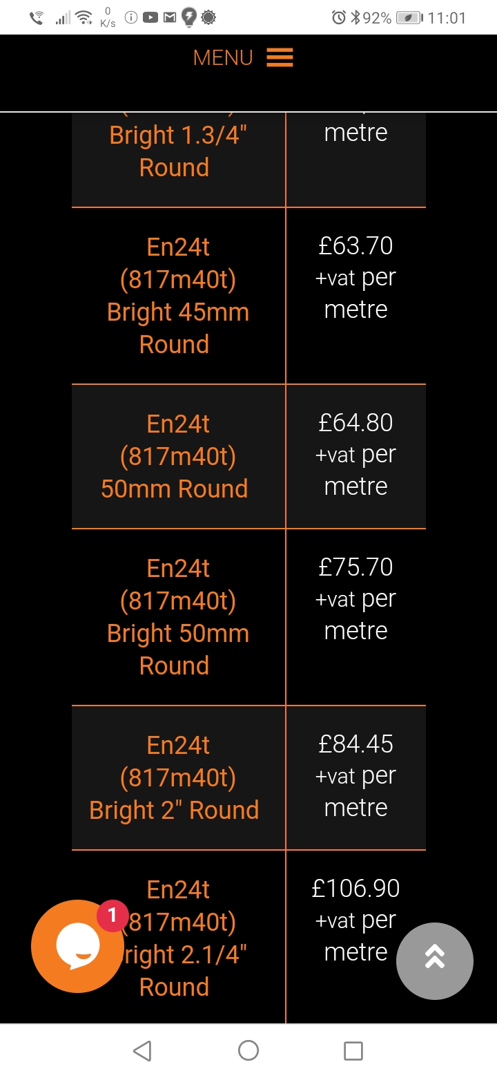

Is hot rolled worse or better for my application, that's the question.Looking at the price list, m-machine metals have 40 x 60 hot rolled at about half that? Also have 40 x 50 bright flats, but they're similar to the price you already have..
Wouldn’t use mild steel, mild steel I’d call mild steel for a reason. Or put it another way I’d use mild steel if I had a bit in stock but if I was going to spend money I’d get something more suitable.Is hot rolled worse or better for my application, that's the question.

Just checked them out. It would seem logical to buy it ready cut as they add 5mm to the size to allow for out of square.
Yeah it does seem like round is cheaper but I don't know the different use of Bright or the other listed.Wouldn’t use mild steel, mild steel I’d call mild steel for a reason. Or put it another way I’d use mild steel if I had a bit in stock but if I was going to spend money I’d get something more suitable.
Sometimes it’s cheaper and easier to source round then cut it into square
40 X 50 x100 is £11 plus vat per chunk. And does not seem to go down in price for extra quantity.

...EN16 as a minimum, EN24 would be better, then they could be hardened...
...was trying to price 50 X 40 versus 100 X 40 as the larger stuff is less prevalent on eBay
Yeah I like the sound of that. Let's discuss ease of machining.What advantage does hardening confer on a toolholder please? They will need a lot more attention to preventing stress risers on the internal corners of the tool clamping pocket if they are to be hardened. Possibly the critical surfaces will need to be ground after hardening to remove distortion. For anything other than production work, it probably is not worth it.
It might also be useful to discuss the machinability of EN16 & EN24 compared to a lesser steel and other available heat treatment processes (e.g. nitriding) if a tough skin is thought desirable.
