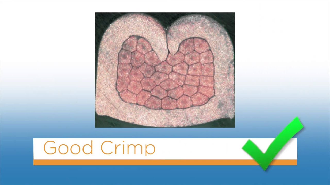

what i do is get some flex and strip the insulation off it and wrap it round the cable end if its not a tight fit in the lug then crimp it jobs a gudunThat's down to poor crimping, the lug should match the cable size and the crimp tool should form lug tightly around the cable, if you sectioned the joint there should be no voids which is what creates high resistance.
What do you mean sectioned?That's down to poor crimping, the lug should match the cable size and the crimp tool should form lug tightly around the cable, if you sectioned the joint there should be no voids which is what creates high resistance.
Going to have to give that a go and see what the Chinese crimper does, won't be as easy to see as that diagram due to the strand sizes but will still be interesting. I cut one off a cable the other day, not sure if I threw it in the skip or not but I will have a look and see.A different type of lug, but it shows what to look for, no voids between the strands once crimped.
thats how i came about the 10mm-16 lugs that i use, bought some from here and there until i found one that looked good inside.Going to have to give that a go and see what the Chinese crimper does, won't be as easy to see as that diagram due to the strand sizes but will still be interesting. I cut one off a cable the other day, not sure if I threw it in the skip or not but I will have a look and see.
