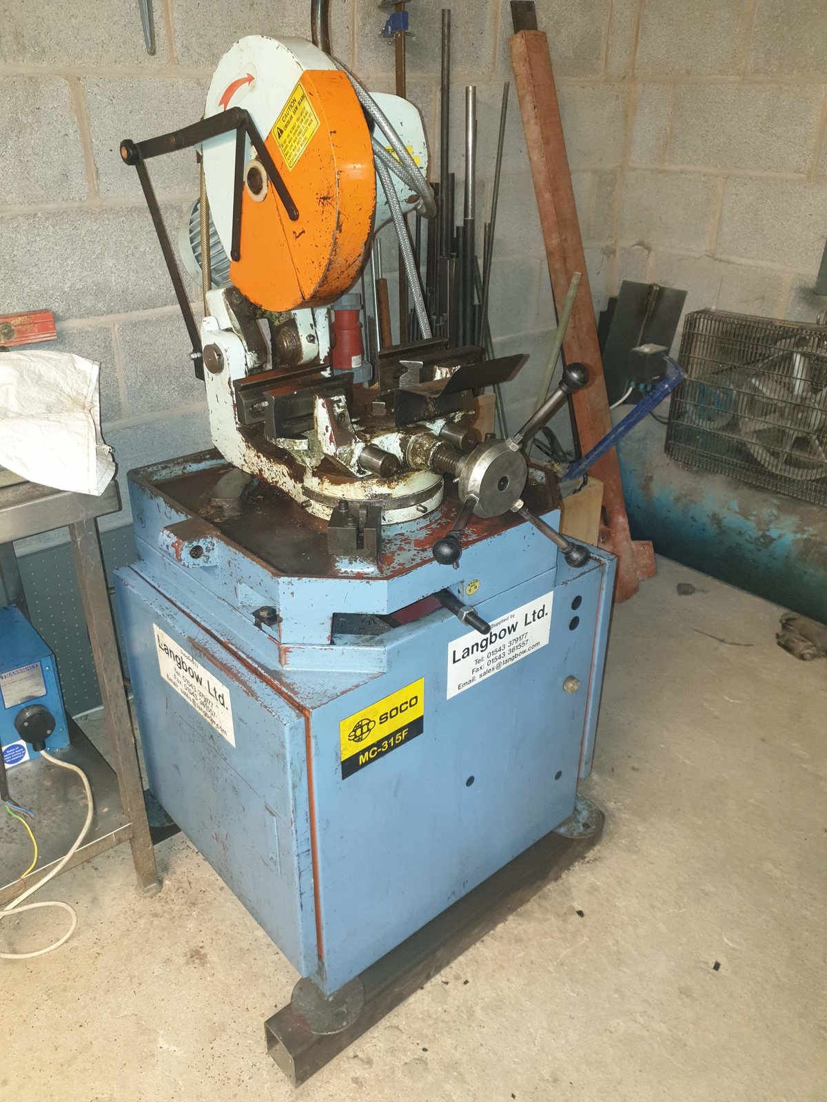

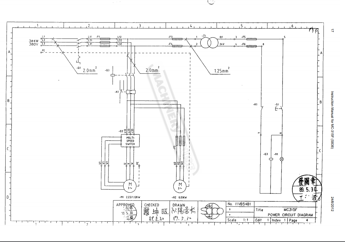

Hi - I have just bought a cold cutting saw which I intended to run off my static convertor.
The issue I have is the saw is 5 pin. 3 supply, earth and neutral.
I guess the neutral is being used as a return to run the coolant pump.
The coolant pump is 230/440v so if I took this out the circuit can anyone see an issue running the saw on a 4 pin plug?
