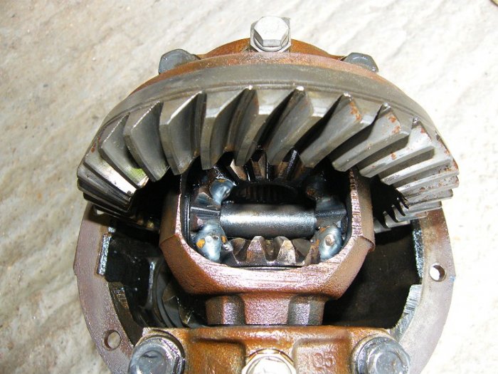

if u are just locking the diff and welding the gears up just ark weld them up with steel rodsif it has cast parts use arc with cast rods
just make sure the crap doesnt get in the bearings and on the face of the crownwheelHello Pommy,
that reminds me of a clip somewhere on the net of someone who welded his differential. He couldn't understand why his vehicle wouldn't go, he'd welded the crown wheel to the pinion!
