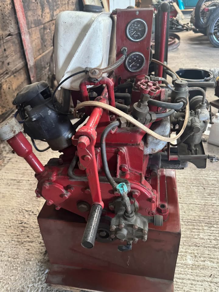

I've got an old 1940s Lifeboat engine that uses a 4VRA Lucas Magneto but the cap was cracked and the innards a little corroded. Does anyone know where to find a new cap? No sign of them in Google etc. Were they used on any other vehicles? Military or Agricultural?
Bonus poinrs if you can name the engine or say where else you could find that block.

coventry climax fire pumps used them, I frigged mine to run of a battery and coil until I sourced the parts. ebay could be an option.
