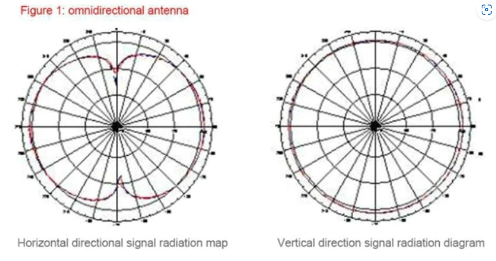

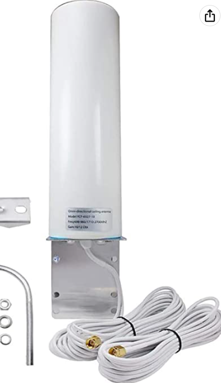

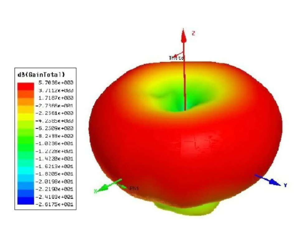

Can you use both types of aerial?
Not at the same time. You can use two or more Yagis in a phased array, but if you mix and match different aerials, it will give rise to all sorts of relections and cancellation effects. If the omni you have is doing its job, it's fine. Otherwise get it up higher in clear LOS for the maximum benefit. You can put the router just inside the roof space to avoid having to extend the input cables. The wireless signal may well be better then too. I have the Ethernet output of mine brought down into a cupboard where all my network distribution is, which then goes off to other wireless access points and a feed to the garage.
