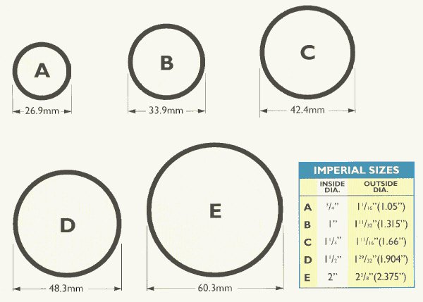

That might possibly work, any idea where I could buy about 6‘ from?42.4OD handrail no good? Aka Tube Clamp size C.

I thought the same initially, but any steel tube 43 OD by 3 mm wall thickness has to be of a minimum strength, no matter how chinesium its metallurgy, also to even be certified as suitable for handrails.Knowing nothing about the spec of the tube used for handrails, it wouldn't necessarily be my first choice of material to keep me off the ground at anything over 5mph

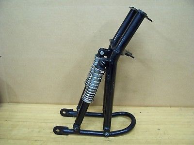

that aside….for a leading link front end you could have the yokes cut by water jet or plasma in steel then weld in legs,

If your going to use new tube your probably going to have to buy fractional sized tube?
1-3/4" tube into a 43mm hole sounds like a non starter.
1-5/8" tube only needs few thou removing to get it into a 41mm hole, removing the few thou should be OK with no machines.
You could fabricate the leading link legs from random tube and some 43mm fork leg?
Or make the forks from smaller than 43mm tube and bush the yokes?
