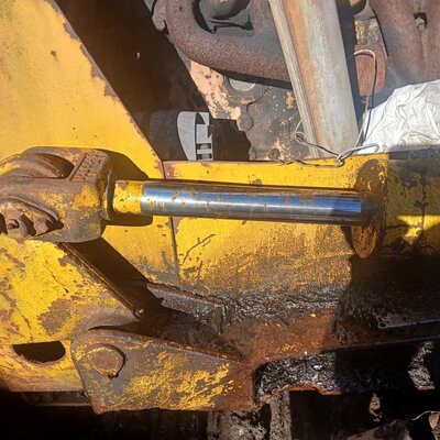

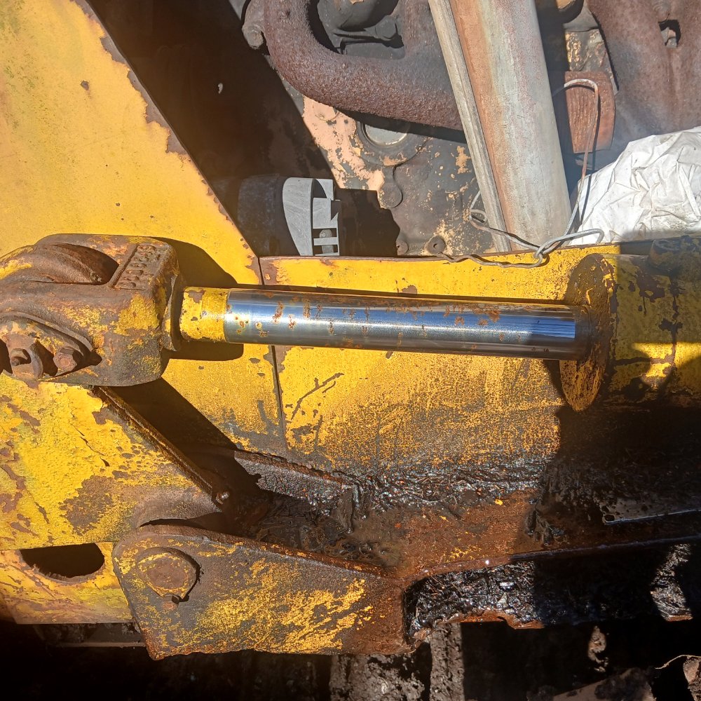

would it need to be sent for re-chroming?I have 1M of 50mm ram here if it would work, dont know if you could reduce its girth to tollerence
I know weverything is expensive there....
but in all fairness it really doesn't cost that much to have it repaired / rebuilt properly even with a chrome rod....
Ok if u have a machine shop to get everything to size but over the years when the rod is damaged better to get it rebuilt.....
it will last another 50 years....
I watch that channel too...have you seen the one with the massive shapper ?would it need to be sent for re-chroming?
i dont know a great deal about hydraulic rams but watching cutting edge in australia he send a lot out to be chromed after he has worked on it
yeah, some of the stuff he has and the stuff he works on is mind blowing.I watch that channel too...have you seen the one with the massive shapper ?
It would cost a absolute fortune to turn down, grind and chrome!would it need to be sent for re-chroming?
*hsl*I personally use hss / hydraulic supplies Ltd as recommended by @Agroshield for chrome bar and continuous cast iron rod.
