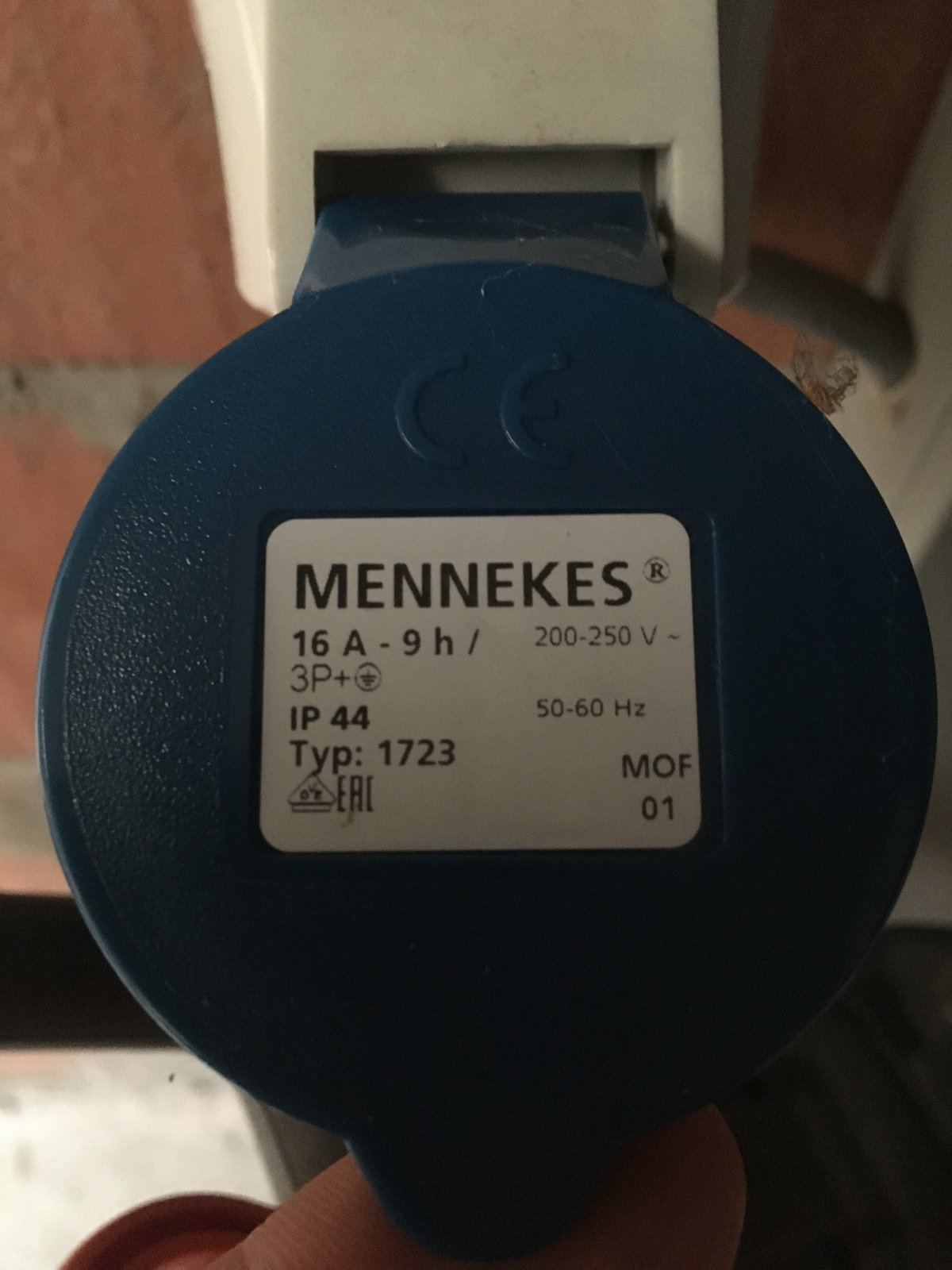

I am leaving my job as an engineer/ fabricator, and so will be losing access to an R Tech 320A Digital Tig (415V). I'm moving to Belgium, and in my home workshop I will have a 3 Phase 16A Supply.
