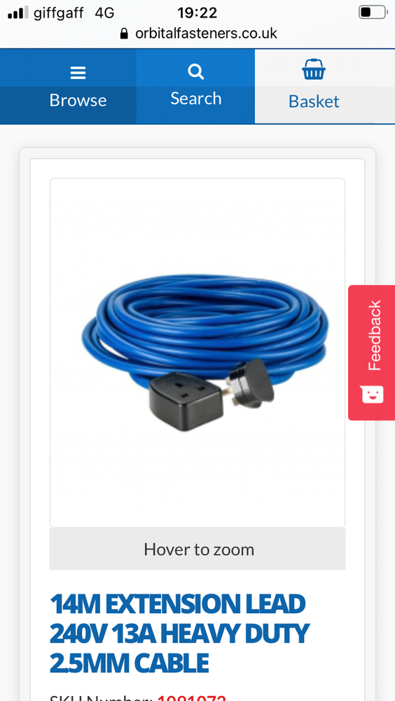

Do extension leads transmit electricity differently to the cables in the walls?
mmt.tr,No I just meant one of them to the compressor thanks
Only if it is a ring main, where half goes one way and half goes the other way - an extension lead can be considered as a spur, from point of connection?
Josh3312,
I can’t see a 14m extension cable reaching more than 14m. Can you? Couldn’t possibly stretch it to 50m!
If your current extension cable is rated at 3.12kW, it should be OK for 2.2kW? In my book that is only a little over 2/3rds of the available capacity.
