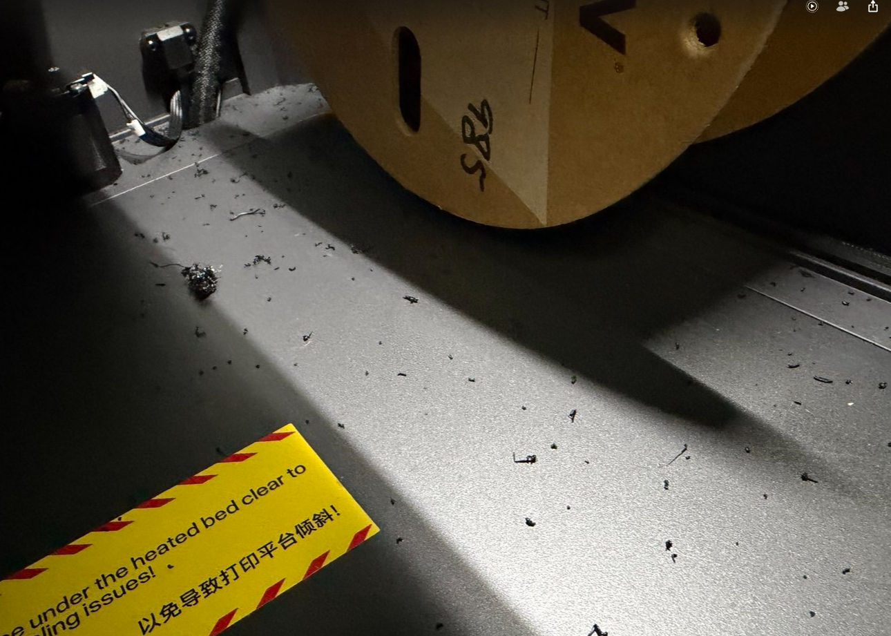

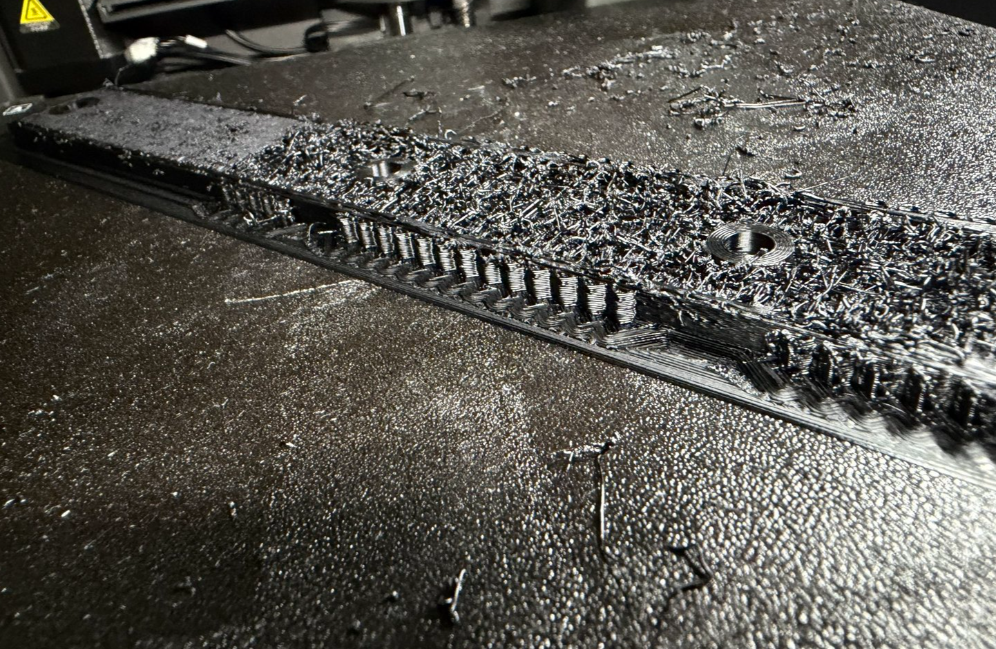

Printing PETG on Saturday and got this:
Crapped out bits of shrapnel all over my poor printer:

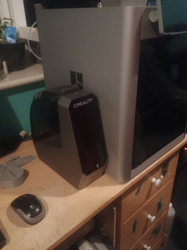

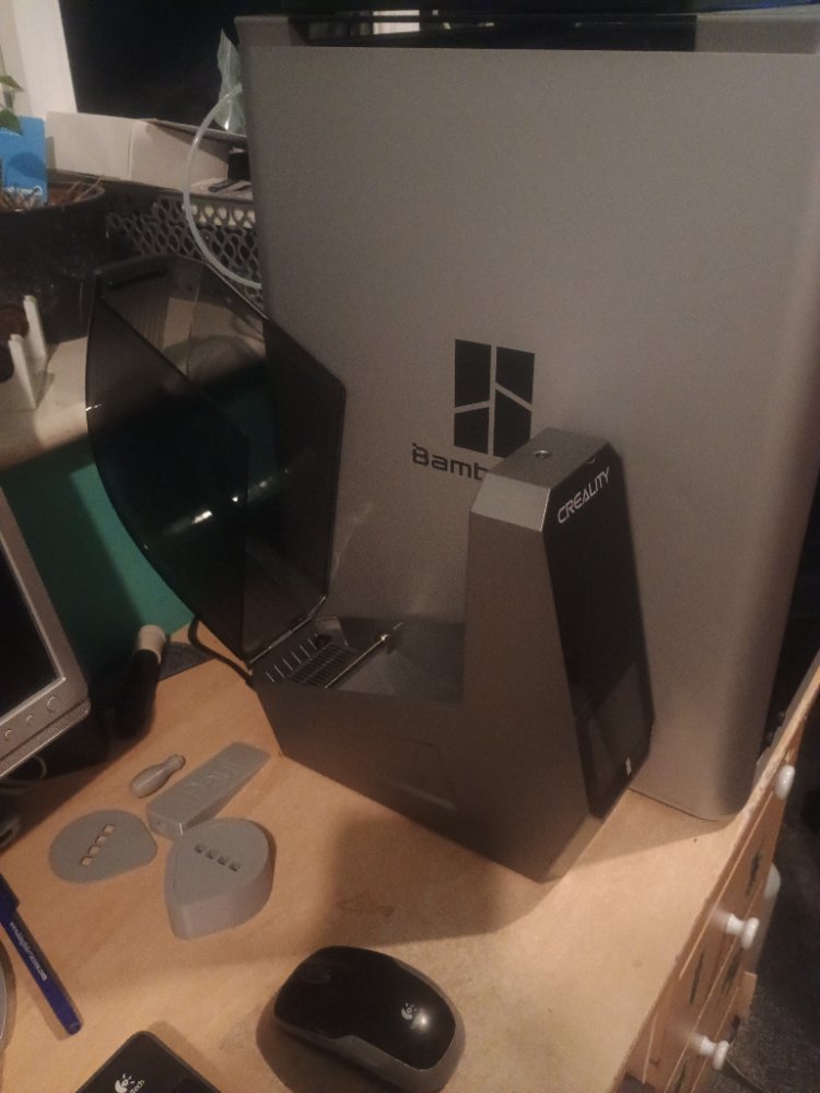

The spool has been in the printer for 3 months so figured it had sucked up all of winter's moisture, so ordered a Sunlu dryer and some ultra special storage tubs.
Dried the spool for 6 hours yesterday but was slightly bemused that the before/after weight was only 5g different...
Tried the print again, and same result.
Then I spotted the print file name "dro_mount_plate_PLA_202601261518"... PLA....? Yep - was using a PLA profile to print PETG - fixed that and, of course, it's printing like a champ!
The 6 hours of heating for 5g of moisture removal should have been the giveaway.
