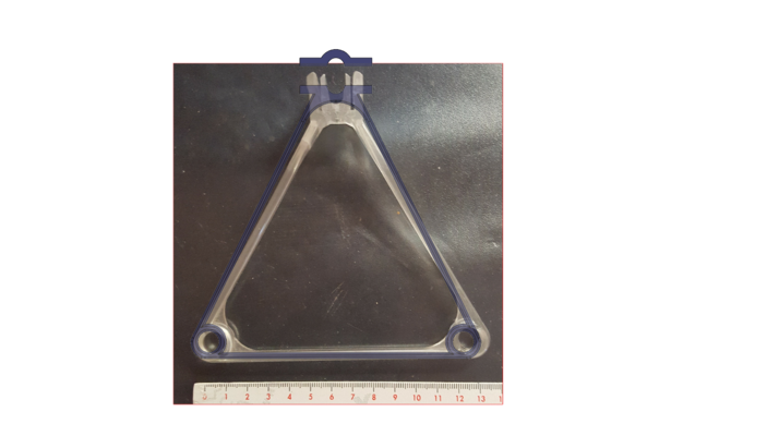

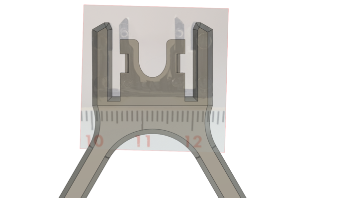

    yeah that’s a quick model based on your photo and a couple of assumptions - estimated the distance between the eyes as 120mm and the eyes themselves are 9mm, I think, maybe 10 - I can’t remember and I don’t have it front of me.

    If I measure the item more accurately would you refine the drawing?

    Sure. I don’t expect any of the dimensions are actually critical other than the clamp onto the shaft... mast... sticky up bit.
    But I can tweak it to whatever.

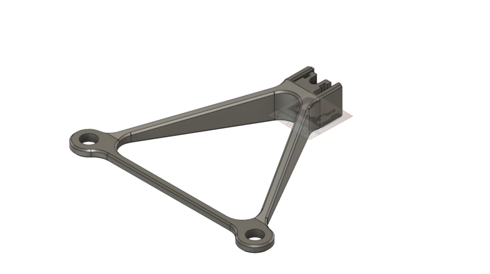

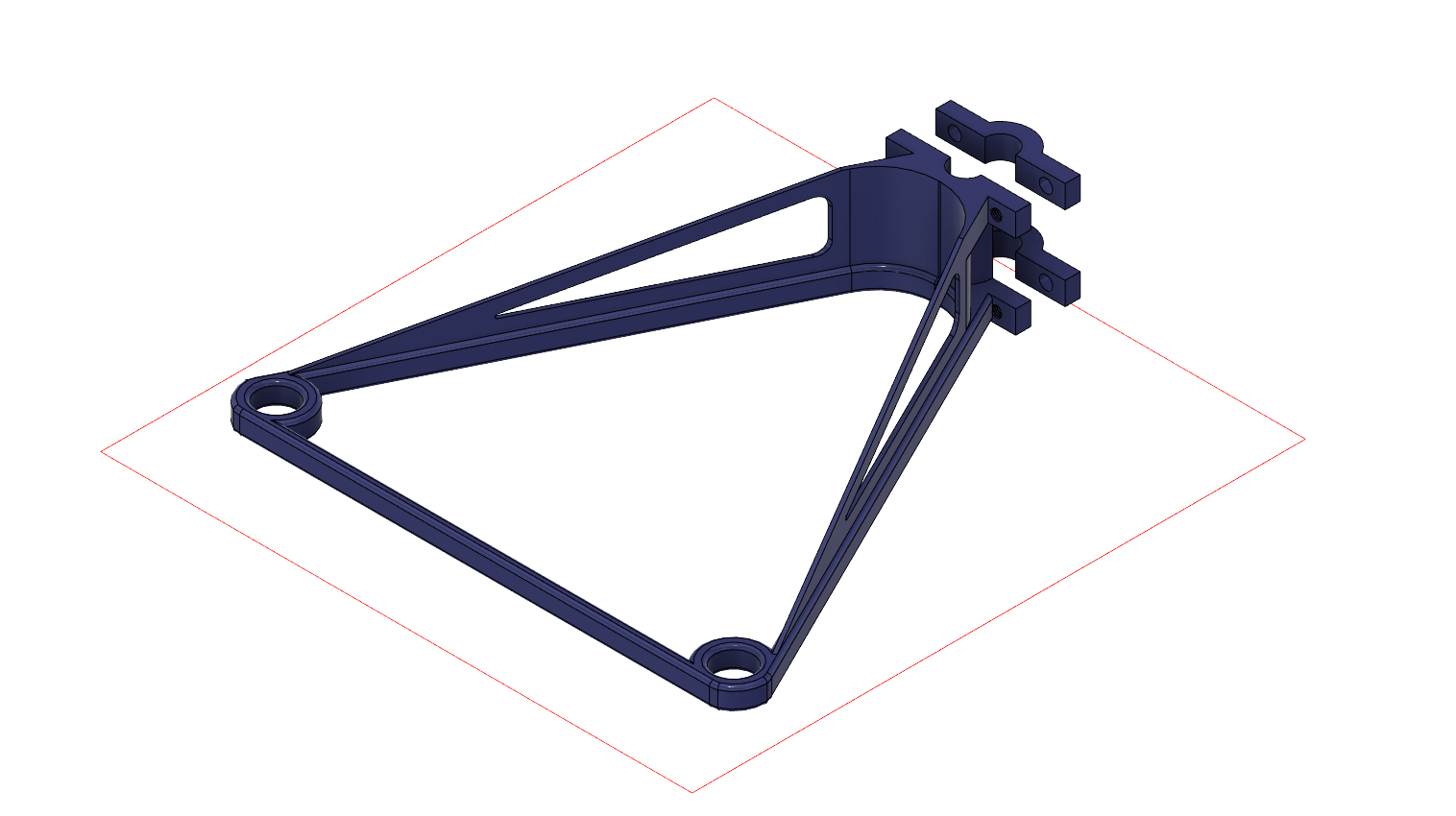

  10. Dev
    Dev 8th generation, Weyland type
    Messages:
    721
    UK

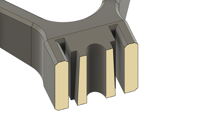

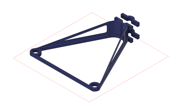

    I don't know where the forces are on this part or where it failed - I'm guessing the weakness is the attachment point.

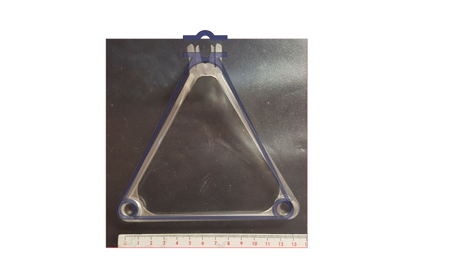

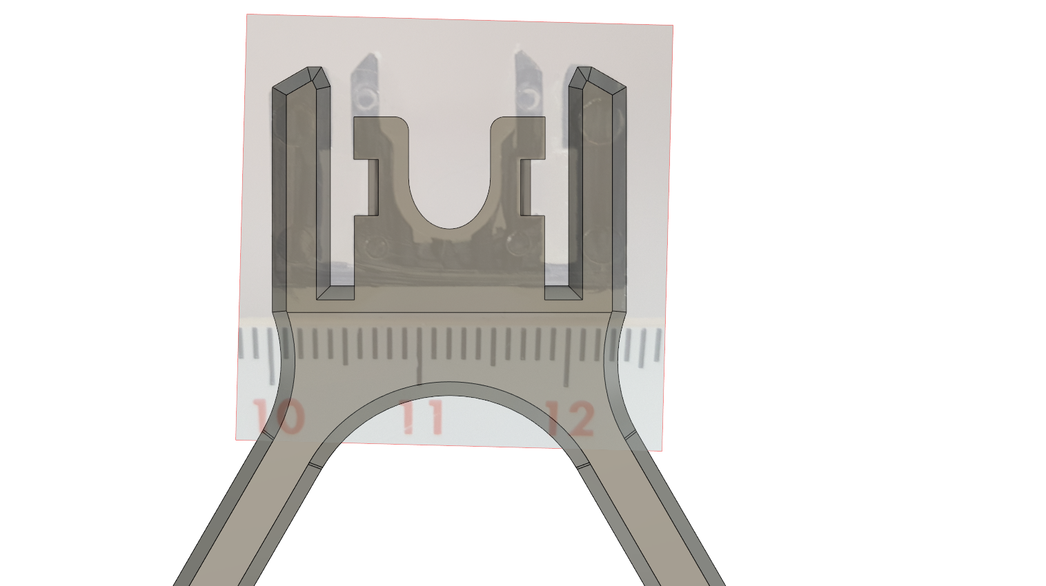

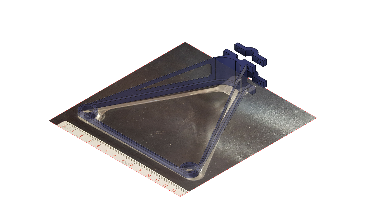

  11. rtcosic
    rtcosic Member

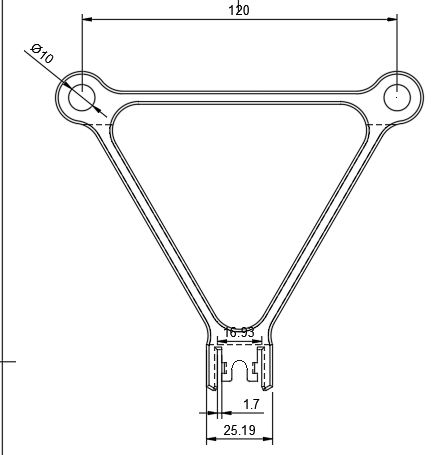

    Some Photographs and my effort at a dimensioned SketchUp drawing:
    Cross Section. Black marker on clear plastic, looking at the underside:
    The Mast. A U shaped extrusion c. 1.2 mm thick. Pressed lips to engage in the slot on the plastic:
    A loose cable runs inside the extrusion :
    An attempt at dimensioned drawing:
    The slots to engage with the lips is 18mm deep measured from the bottom. The centre line of the legs is also at 18mm from the bottom. The triangulation runs underneath.

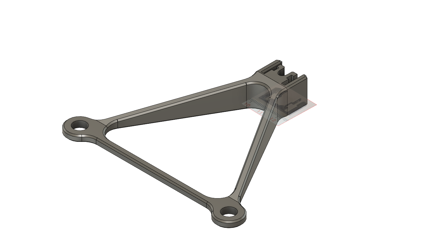

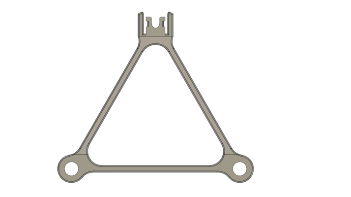

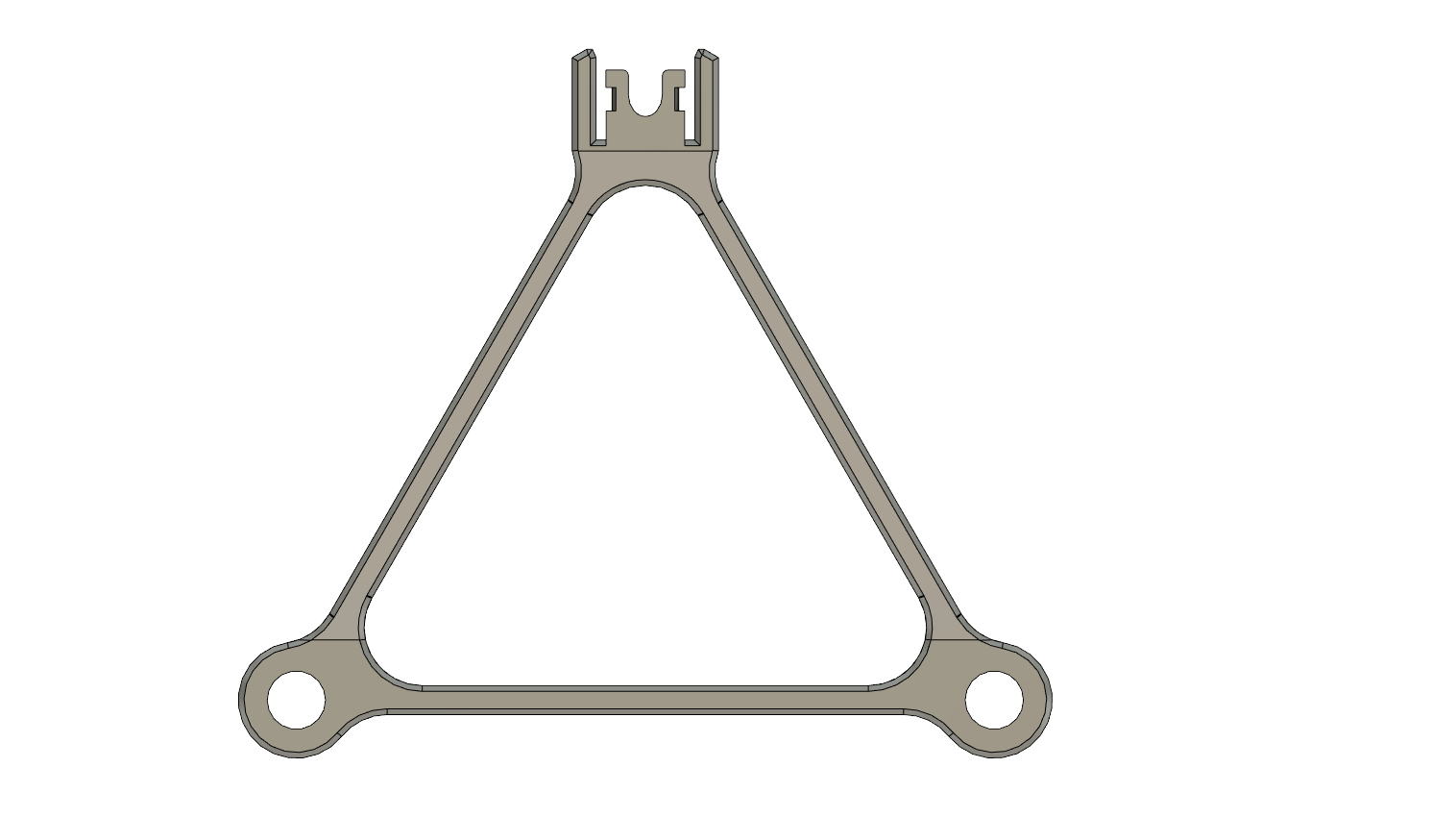

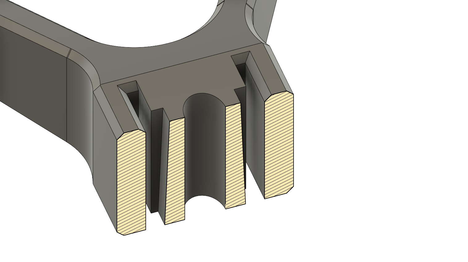

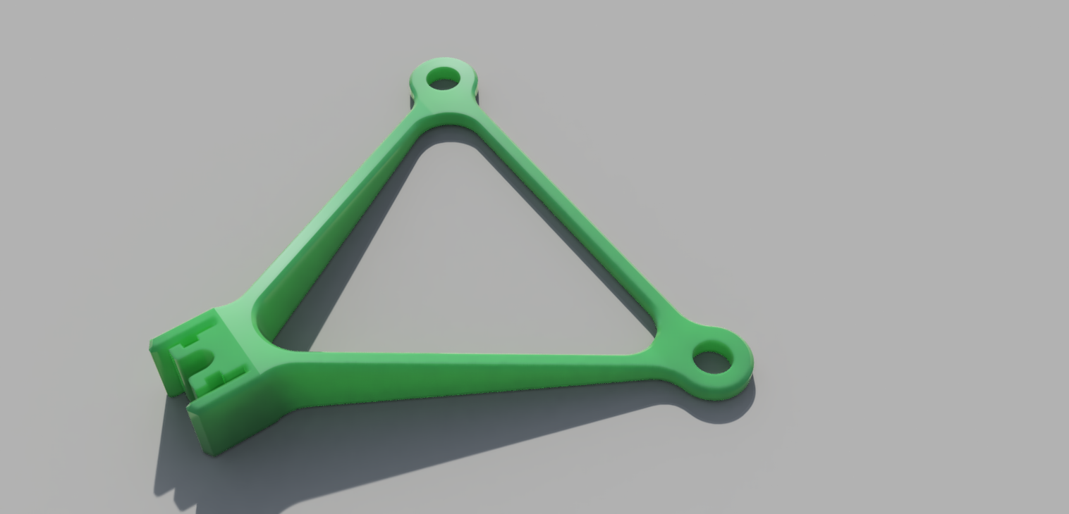

  13. Dev
    Messages:
    721
    UK
    Alright here's an attempt - The weakness is still the internal clamp but I've made it thicker, hopefully the cable still fits. If it were me I'd do away with holding it internally and clamp on the outside of the mast - less elegant, but less fragile too. I've made the gap 1.7mm but put a 2 degree taper on the inside of the part that makes with the lugs. What do you reckon?
    mike os likes this.

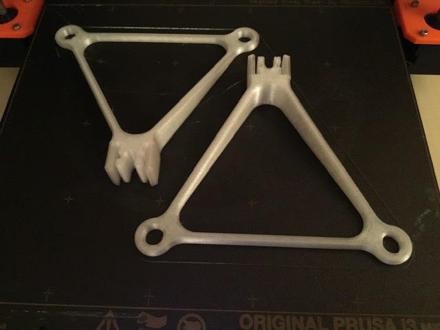

  15. rtcosic
    rtcosic Member
    Is that actually printed?
    I'll drop you a PM for exchange of addresses
  16. garethp Forum Supporter
    Messages:
    1,049
    sw scotland
    Where are the originals breaking? No point in copying a weak point if they are breaking in the same place.
  17. rtcosic
    rtcosic Member
    The originals break their 'arms' due to 'impact damage' - they get knocked about when moving the machine, walking past it etc. They are also over 30 years old and UV gets to them eventually even indoors.
    They don't fail due to any in-service loads.

  18. rtcosic
    rtcosic Member
    The slots should be 'blind' and be about 18mm long with about a 10mm closed length to sit on the projections in the mast, but the printed arms are an 'interference' fit, aren't under any material load other than their own weight so.......................
    they work fine!
    Happy SWMBO, except having washed the jumper - as is normal - it's shrunk. It's quietly 'resting' with a little tension on it to try to persuade it back to the planned dimensions. The knitting equivalent of percussive persuasion of a distorted weldment.
    Edit: didn't 'proofread' the photo - the clever phone has focussed on the wrong yarn guide.
