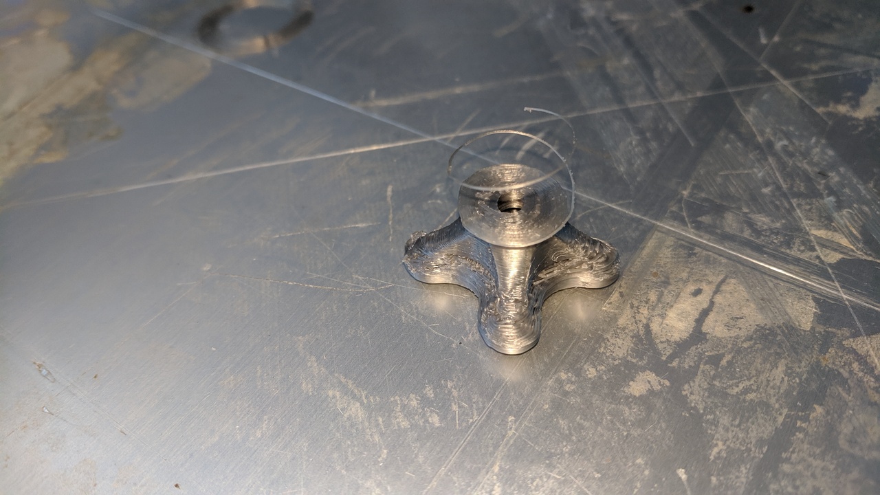

The nozzle is supposed to torque up against the heatbreak *not* against the heater block, that's probably why it's rotating.
heatbreak being the m6 tube with the ptfe liner which runs through the heatsink/heater block?
