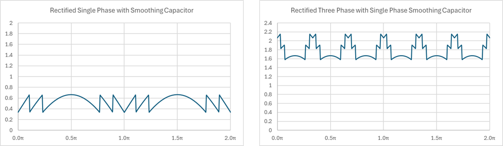

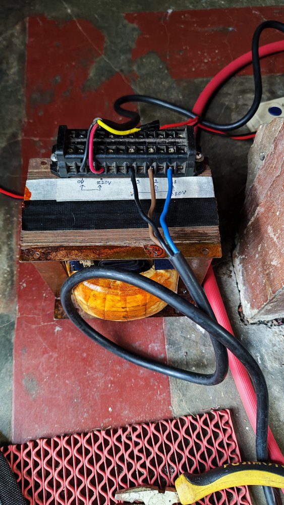

Without seeing a circuit diagram you can't assume the rectifier design will be happy with a single phase input, because it may actually be combining the output of three (smaller, cheaper) units.If it were a transformer machine, it would not work properly without all three phases. As it is an inverter, it only needs a DC supply (rectified AC supply) of the correct voltage. If the transformer can supply enough power (11kW), the inverter should be happy. As it stands, the transformer is not big enough.
