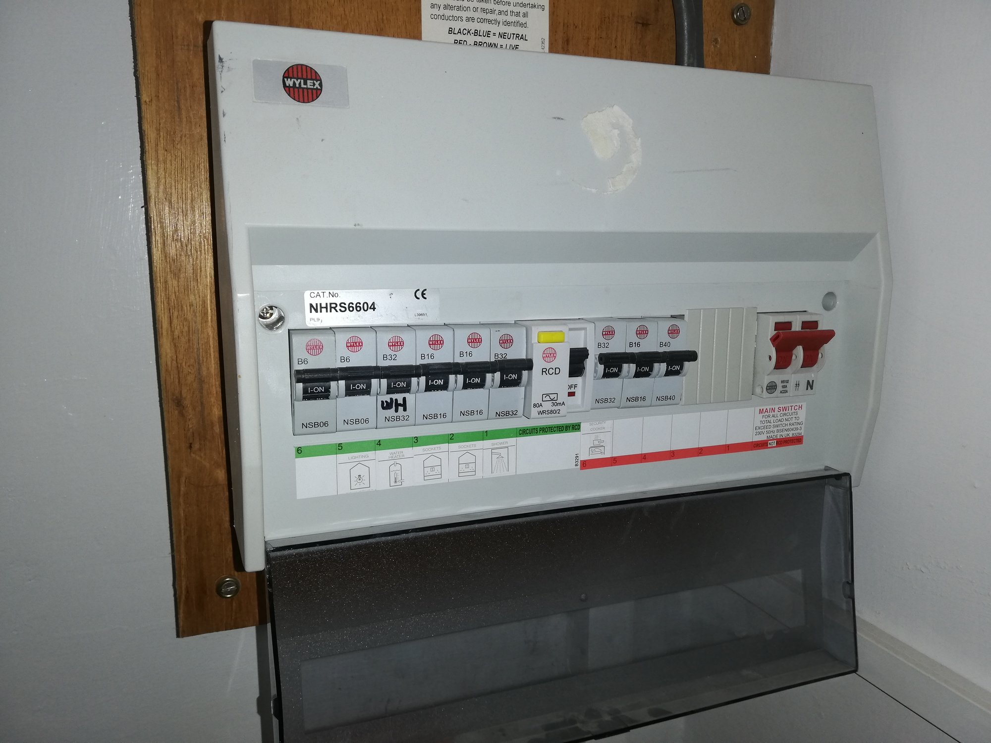

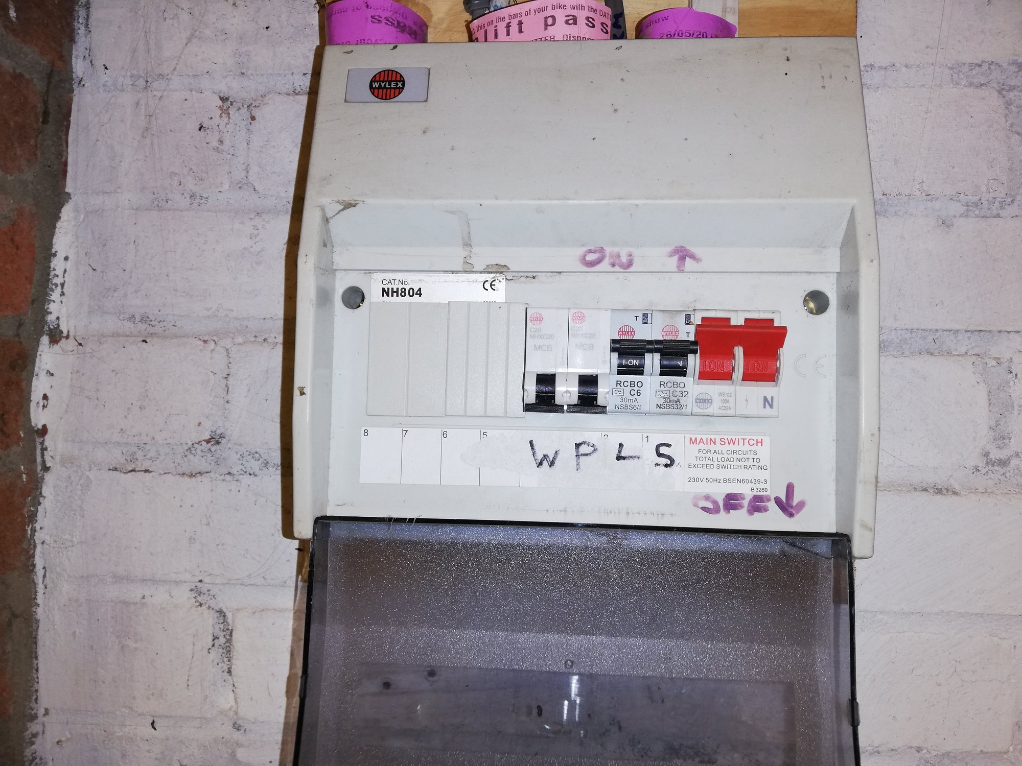

Possibly have the opportunity for a larger plasma cutter which requires a 32a supply.
This is my current install. Would it be simply enough to add a socket in garage? Want some idea before I get an electrician in.
House consumer unit. Garage is 40a on the right
Garage consumer, have a couple 16a sockets, one of which can go as no longer required

just fit the socket and a 32 a breaker . the only time I have seen a problem with cable getting warm is on a 10kw shower on 10mm cable . that is a constant full load and it was in insulation in wall and attic its not going to happen on your set up
