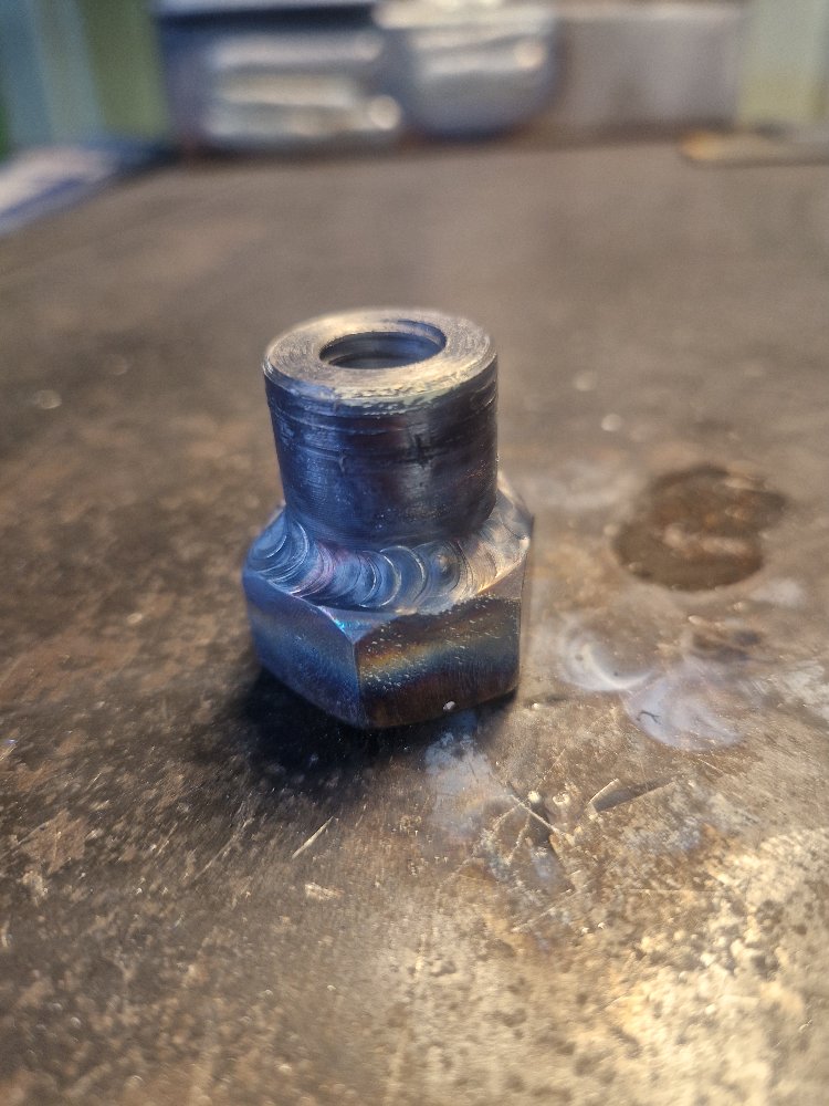

So, following my 304 to 304 thread, I need to remake the same part...well almost the same...the nut is still A2 (304) but the round bar its welded to will be en16t as thats now all ive got left large enough to use. Will be 20mm dia with an m12 through it and a small 16.5mm spigot to locate the nut as with the last one.
Again, its an adapter for a slide hammer for the same injectors, so shock resistance is likely the most important factor.
Will 309 do the job? I have er70, 308 or 309 and ideally need to make it this week as the lad its for is wanting the Injectors out next weekend but he is the type that will lose/break/forget to return tools so he isn't having the full stainless one ive made for my father.
I could pop to the local suppliers one day for a small batch of whatever rod needed if 309 isn't suitable. I would say I could tig braze it, but ive no experience of it
