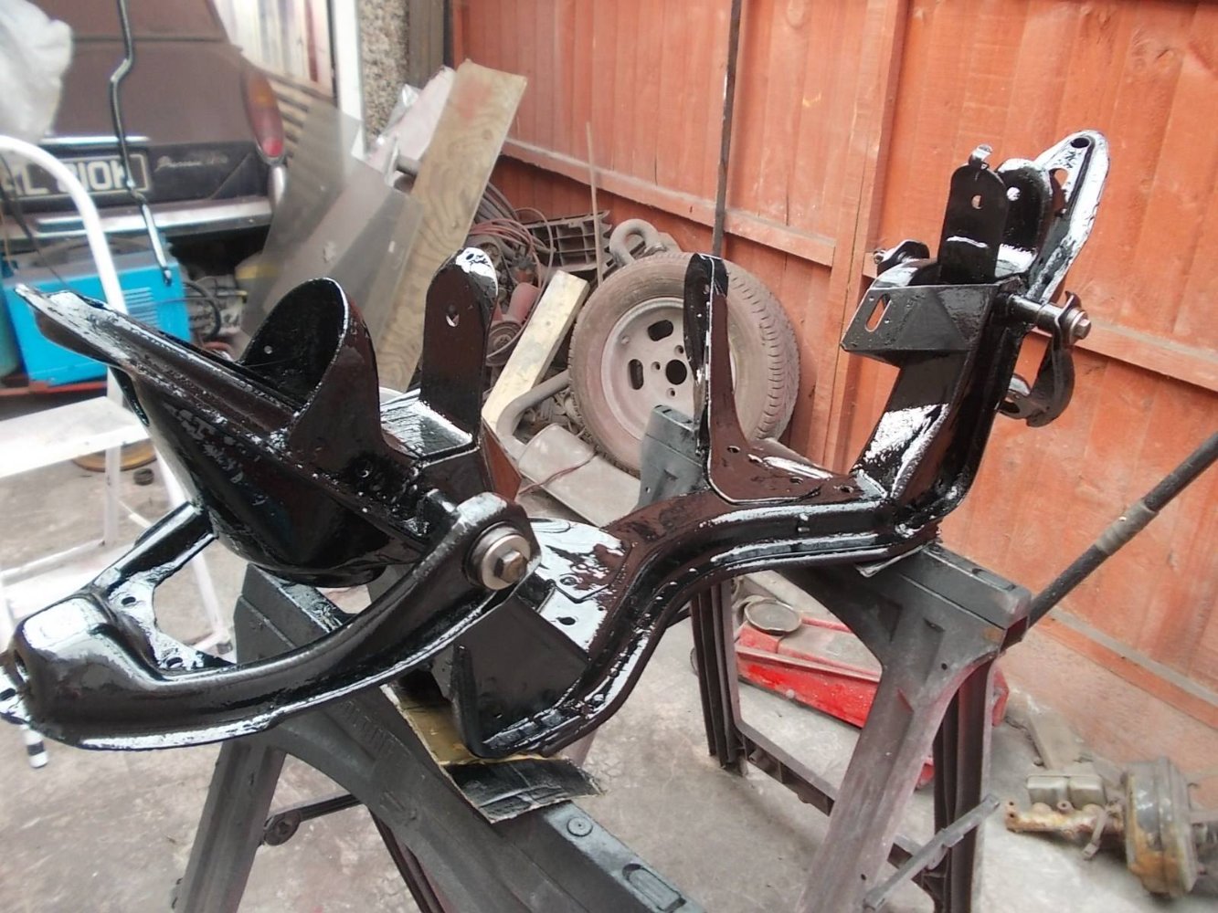

The wishbone bore is 29.5mm and the flange of the bush is 39mm. A 1.5" x 1/4" wall tube would be close enough, that is readily available in mild steel.Would it not be easier to cut them from a length of stainless tube?

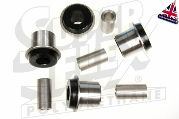

I’ve always given poly bushes a good smear of silicon grease before assembling them. Helps lube, helps keep water at bay.The problem with polyurethane bushes is they aren't bonded so are a bit of a rust trap between the bush and housing/crush tube, then they wear rapidly. Stainless is used by superflex for the cortina bushes pictured above and sold by burton power so I'm sure even with limitations of some grades of stainless in some applications it must be suitable enough, grade depending. I have 0% interest in machining 304, 316 or a duplex grade of stainless for this job, just too much work on a knackered ML7.
I'll look at some other options as the outer bush tube will be pretty thin at about 1.5mm.

think i paid £40 for the set back then! how much!!you could nearly buy a lathe for that price ,,,,look similar to cortina top arm bushes, i changed to these about 20 years ago and checked them during the restoration, they were still good so went back on and are still good seven years later(and having checked the price i hope they last a long time yet)think i paid £40 for the set back then! how much!!

I have Superflex bushes in the rear trailing arms on the Firenza, I believe they have stainless crush tubes in them. I had them out recently to check whether they'd worn down (it's very crash-bang on poor road surfaces, of which there are many locally) but it all seemed fine.

Yes, ease of machining makes it a possible material choice, I don't304/316 wouldn't be worth the extra effort over mild steel.Why have you gone for 303 over 304? Is it purely the ease of machining?
The outer tubes are only 25mm long so not a massive amount of work, welding is an option but I have no filler wire and would probably have to machine up an aluminium backer to get anything like the finish of a machined part, probably a better option for a more skilled and experienced welder, also I like machining more than welding and this is a hobby.The outer housings look like they'd be quite expensive to make as you'll need a fairly hefty bit of bar and there'd be a lot of boring on a Myford, even in 303. Fabricating from 304L tube with a welded flange sounds like a better deal, but again, passivate the weld to retain corrosion resistance.
Coming at the problem from the other end, if a standard bonded rubber bush is available, I'd use that over polybushes. Polybushes are a pain in the **** to live with.
Did you fit the stainless outer tubes same as the ones in the link?look similar to cortina top arm bushes, i changed to these about 20 years ago and checked them during the restoration, they were still good so went back on and are still good seven years later(and having checked the price i hope they last a long time yet)think i paid £40 for the set back then! how much!!
yes, if i remember correctly the bushes don't come out of the outer tubesDid you fit the stainless outer tubes same as the ones in the link?
