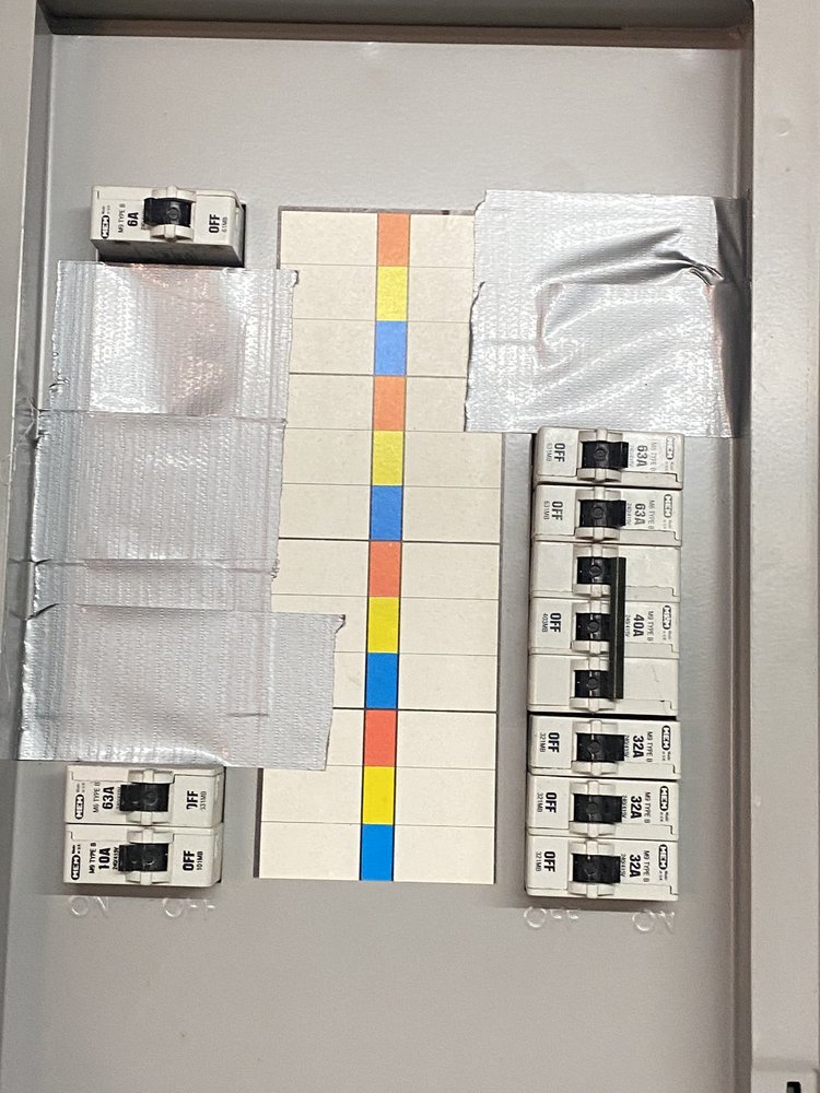

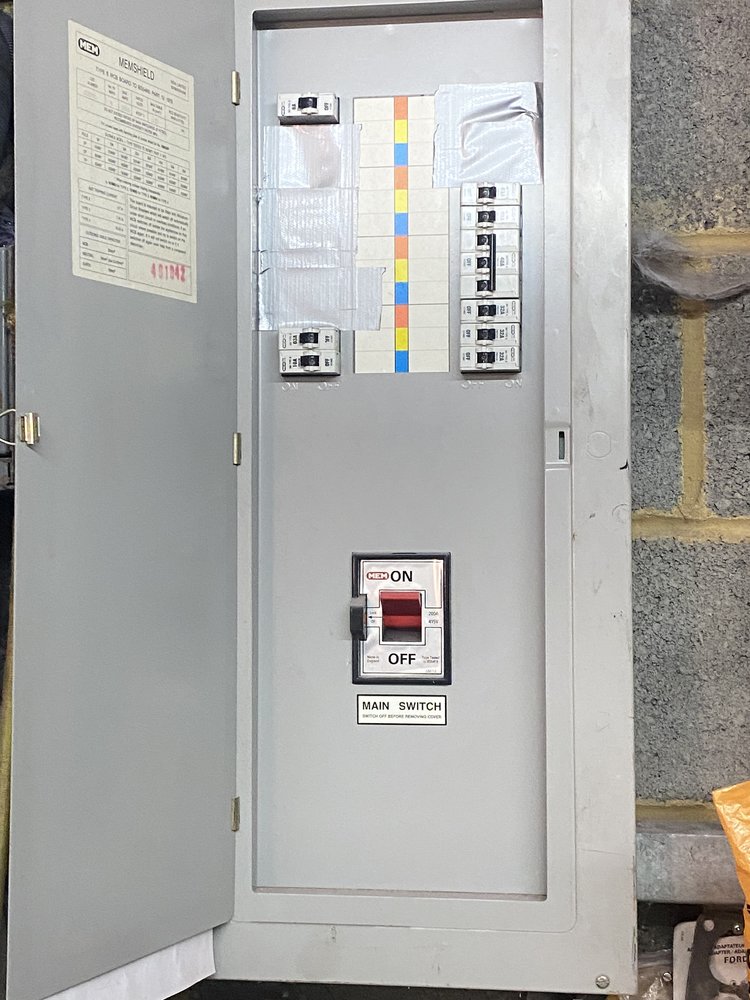

I want to improve the protection in my workshop which is for my private use only. DB is an old MEM Memshield and I was hoping to just fit an RCD to, at minimal cost. However it seems that the correct device is hundreds of pounds, which is not going to happen.

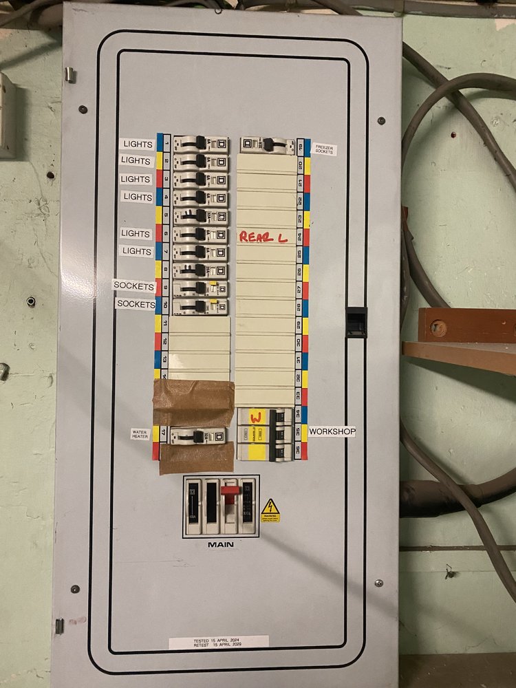

In the absence of other suggestions, I am thinking of a standalone RCD intercepting the 3 phase incoming or the three phase outgoing from the building's DB, which is the Square D Loadcentre.
Suggestions of inexpensive solutions are welcome!
