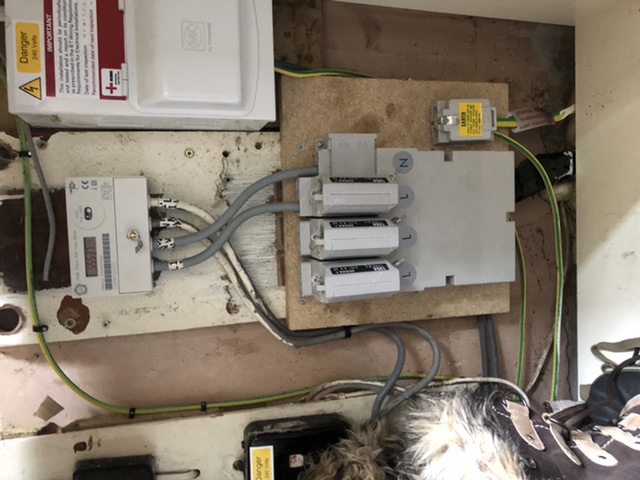

Now if you have a live supply, and you don't want to pay for it, say the garage, workshop or house is empty, you ask the supplier to cancel your supply and they will remove the meter and close down the Mpan (the long number that signifies your supply referance). The DNO will leave the fuses in, unless you pay them to remove the cables etc.
Looks like someone bought that property and downgraded the supply to save money. Ask your supplier to activate the 3 phase and it shouldn't cost you anything.
