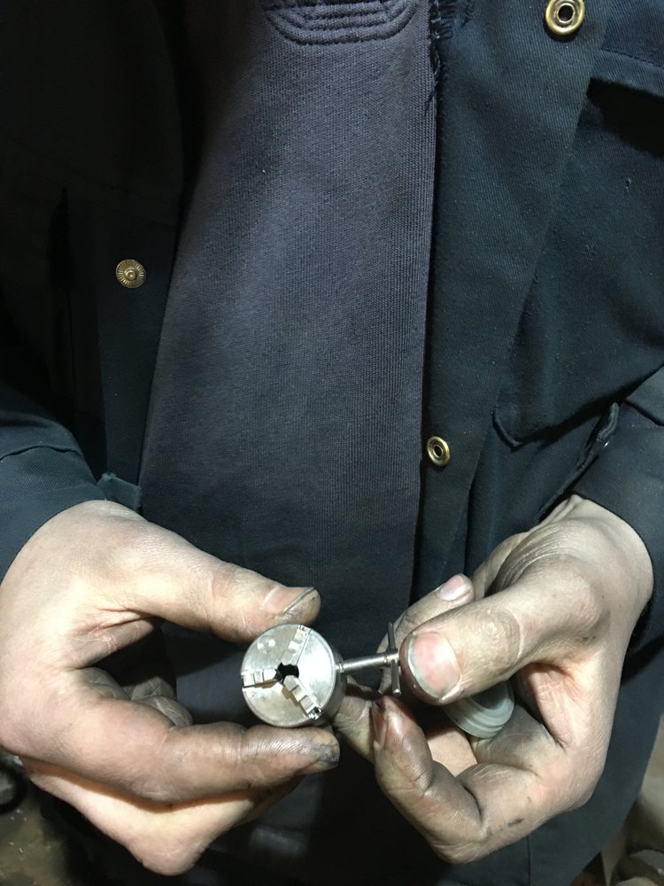

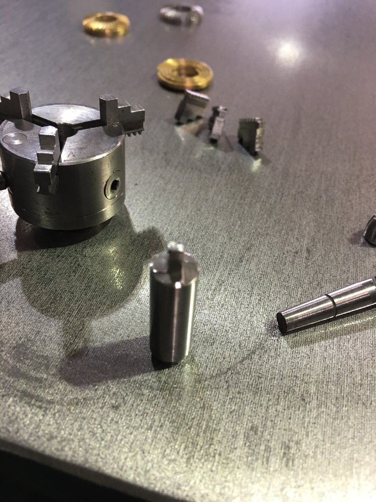

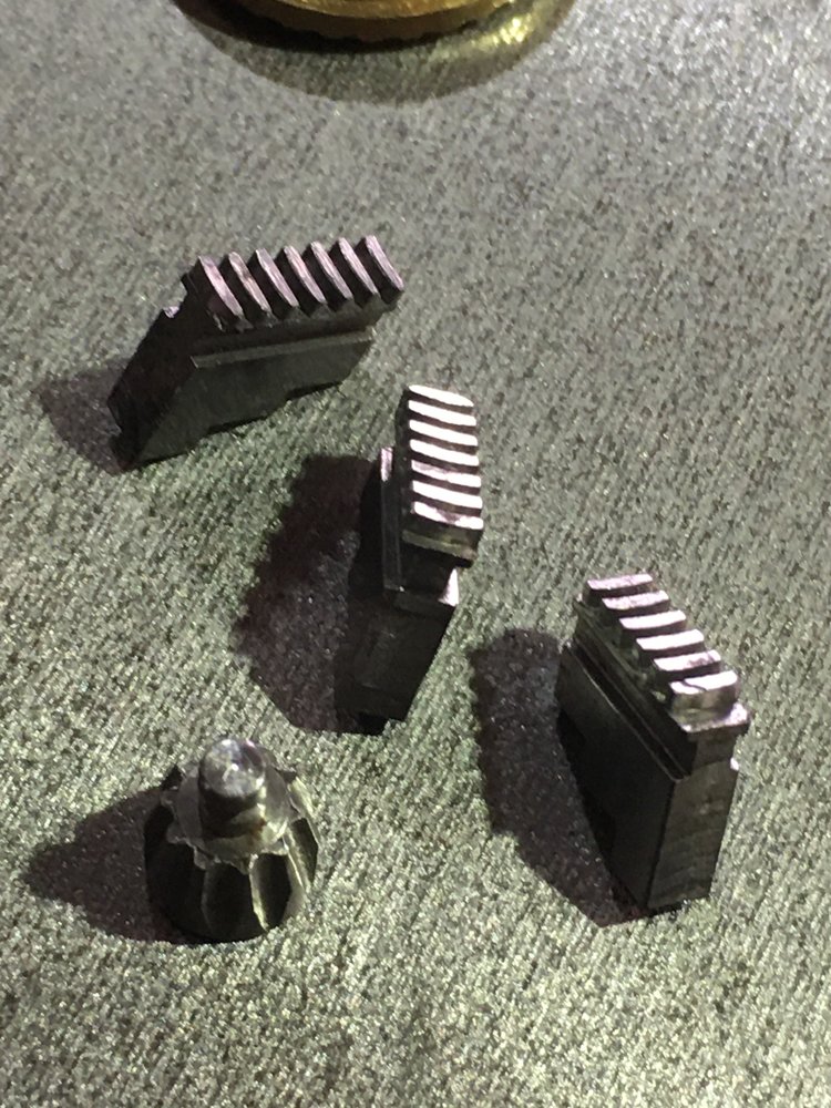

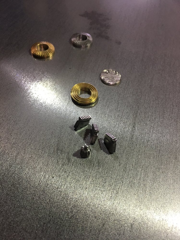

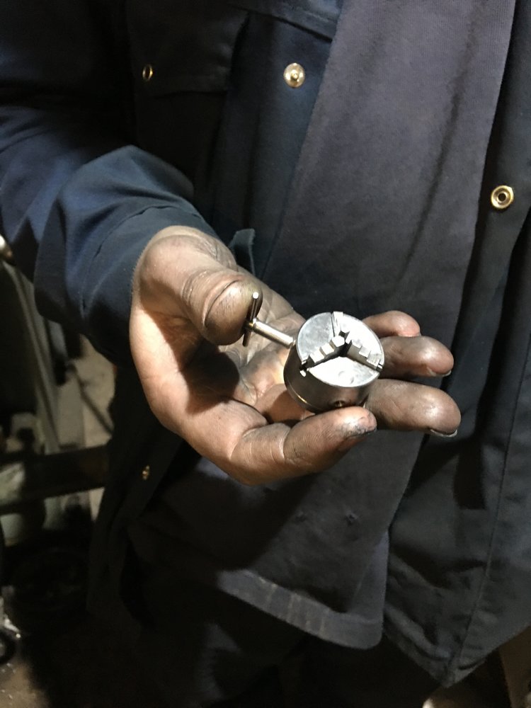

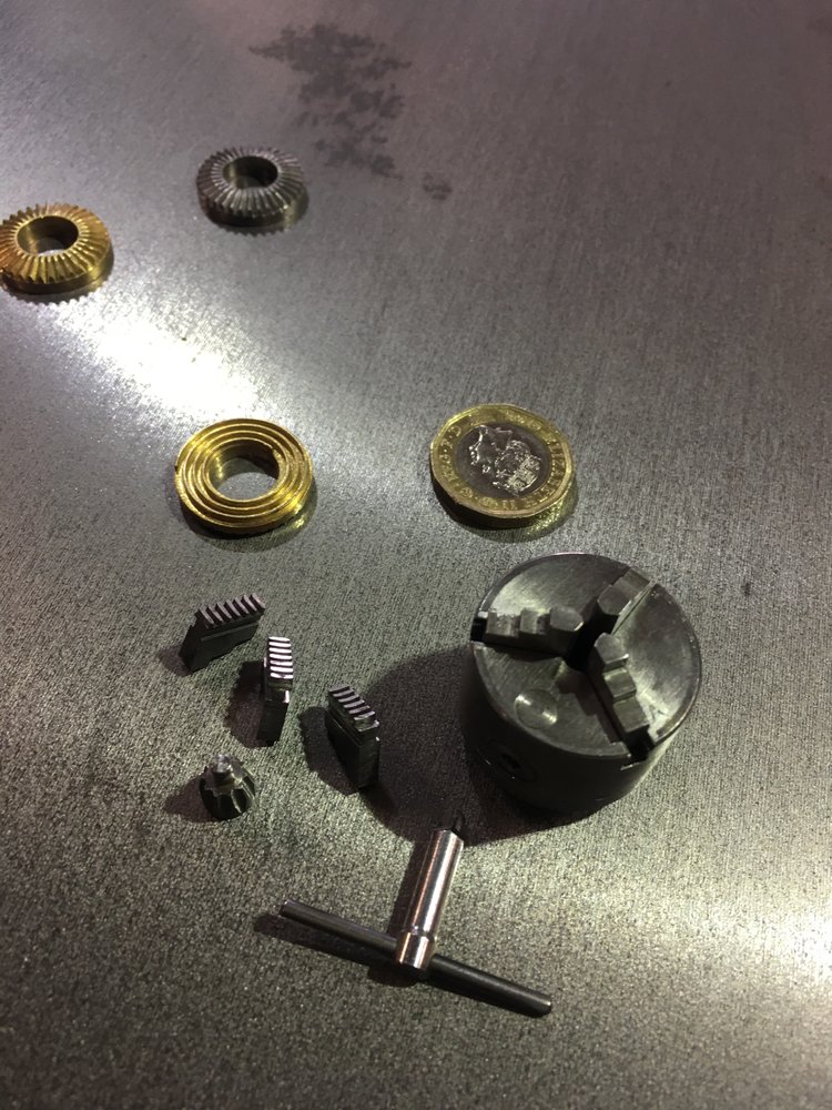

that restores a lot of hope for the futuare eh , absolutly top notch .Had to share these pictures. Lad on the scraping class made this working three jaw chuck with reverse jaws.
Really warmed my heart and found someone to leave my instrument sized stuff to
View attachment 393015 View attachment 393017 View attachment 393018 View attachment 393019
He’s a real micron accurate toolmaker and cylindrical grinder man by profession., very very rare these daysPerhaps you could interest(persuade) him in joining the forum , with that level of skill I am sure we could all learn something .![]()

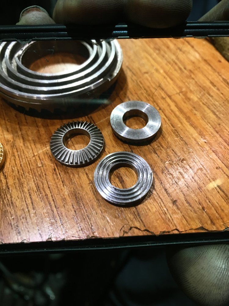

A vertical mill and a dividing head which is gear driven from the table traverse.
With the 1mm pitch I fear that would be a nightmare!A vertical mill and a dividing head which is gear driven from the table traverse.
Chicken and Egg. Needed to make a Scroll, before he can make a ScrollWith the 1mm pitch I fear that would be a nightmare!
He used a Alexander pantograph. You see older Stephan gotteswinter videos and he uses a pantograph for fine work
You use a full size scroll then scale down using pantographChicken and Egg. Needed to make a Scroll, before he can make a Scroll
