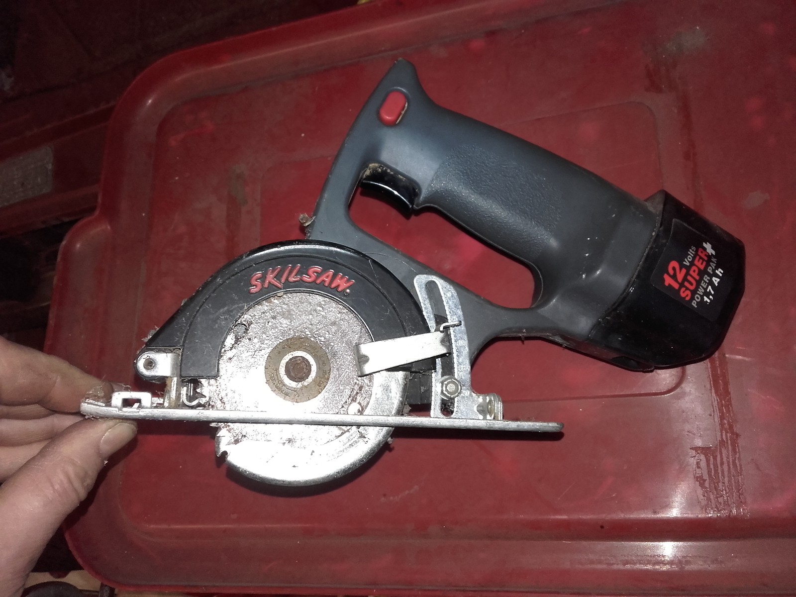

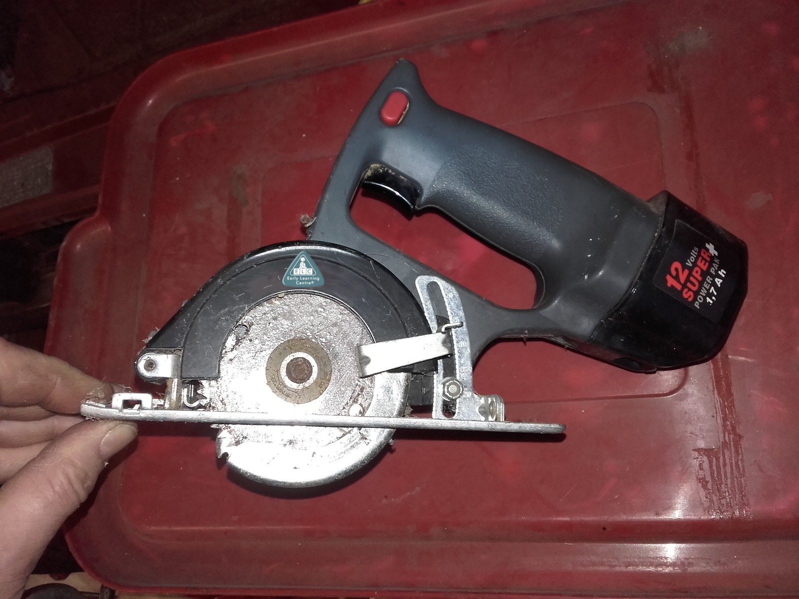

I've got a corded Worx circular saw which takes 3" (76mm) blades. 76 x 1.5 x 10mm centre.
Does real well, up to 3mm mild steel so far, quite accurate too and taken it over 300mm lengths ok, might push it further than 3mm if I can get blades
3" blades don't seem popular and 50 teeth is tightest I have which I could do with replacing or getting smaller. Can only find 44t of the type same on line
Any experience of on line suppliers could ask?
yep that's the one when it did work the blade doesn't run fast on them and I think there only any use on thin sheet materials like plastic Perspex and thin ply etc
