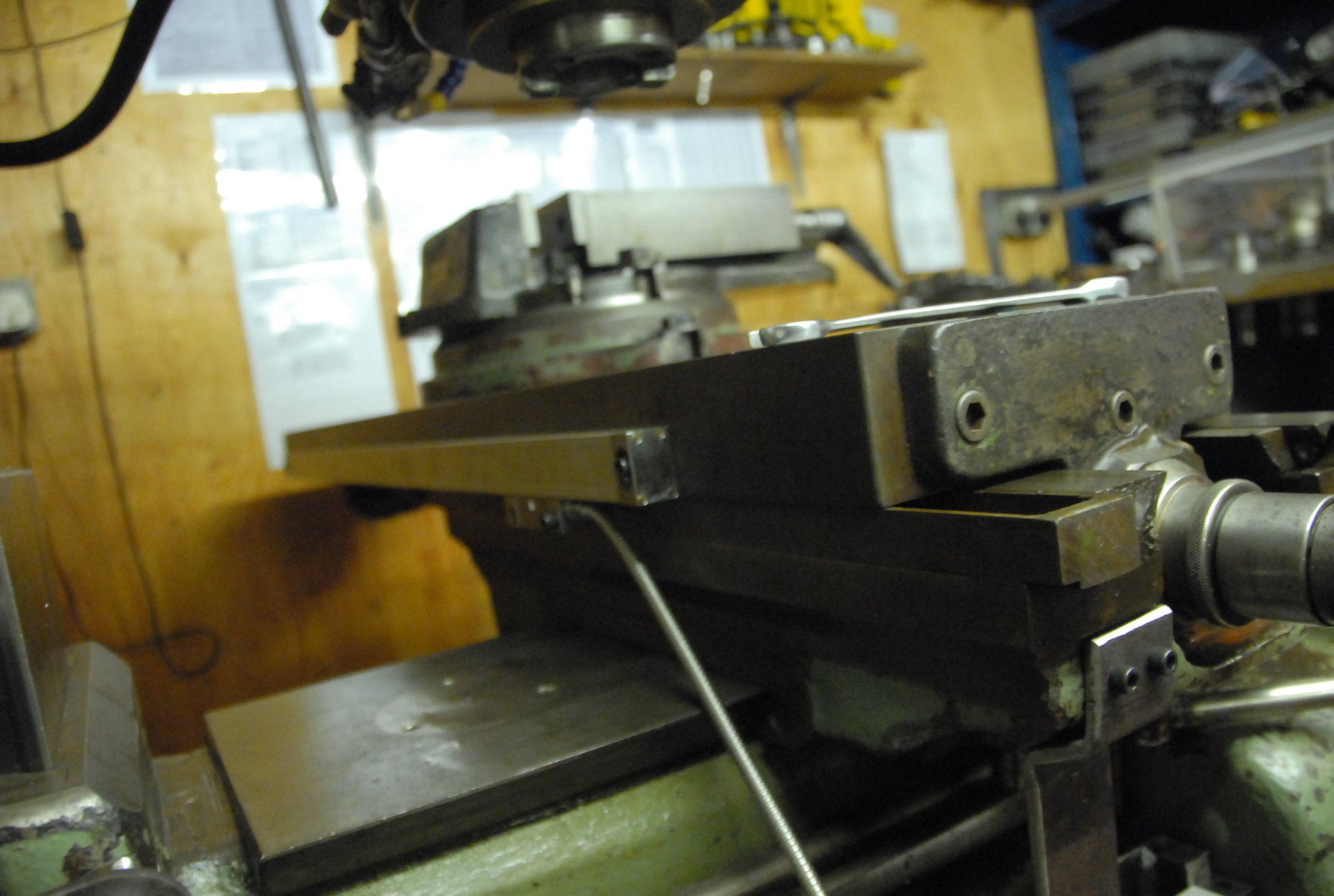

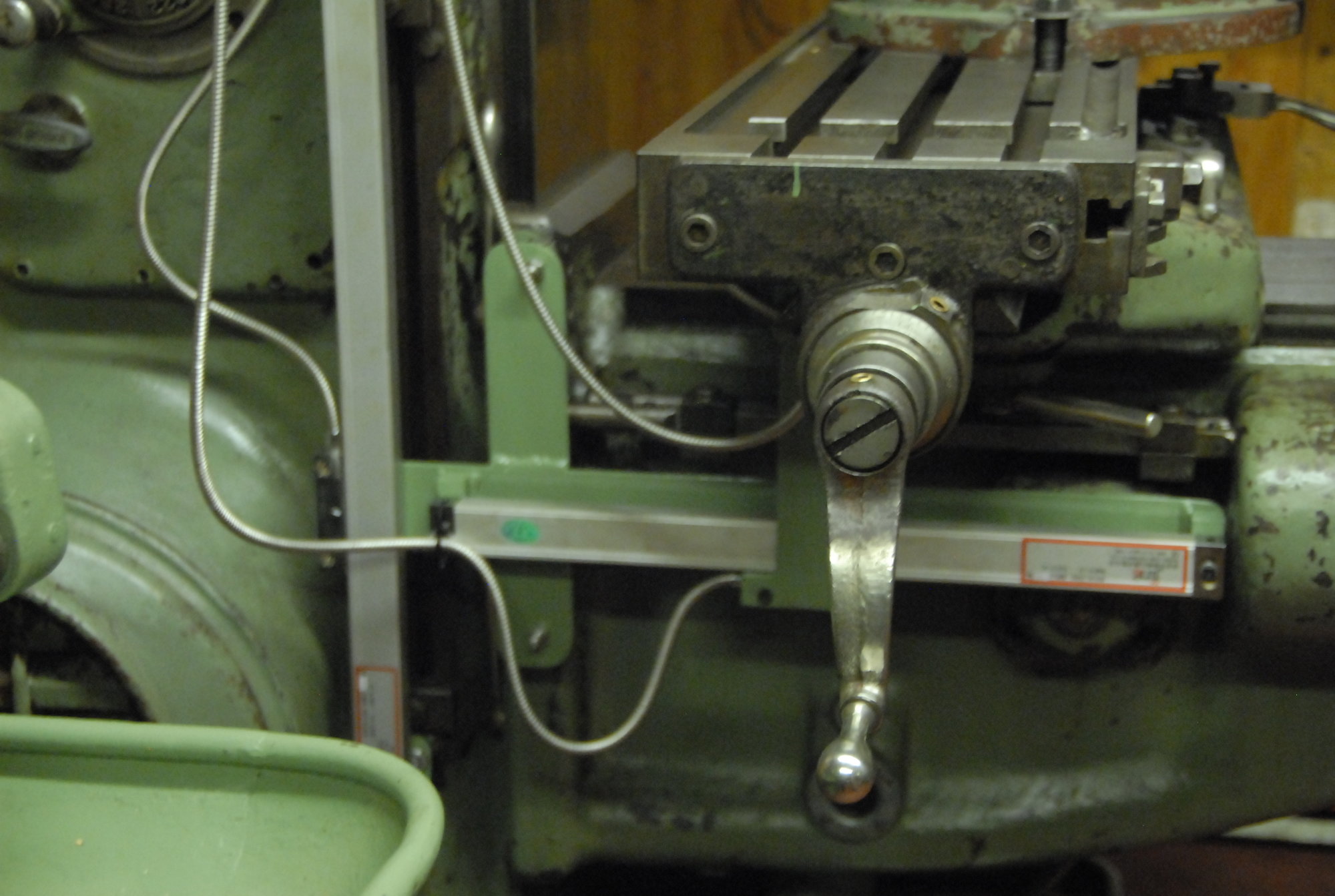

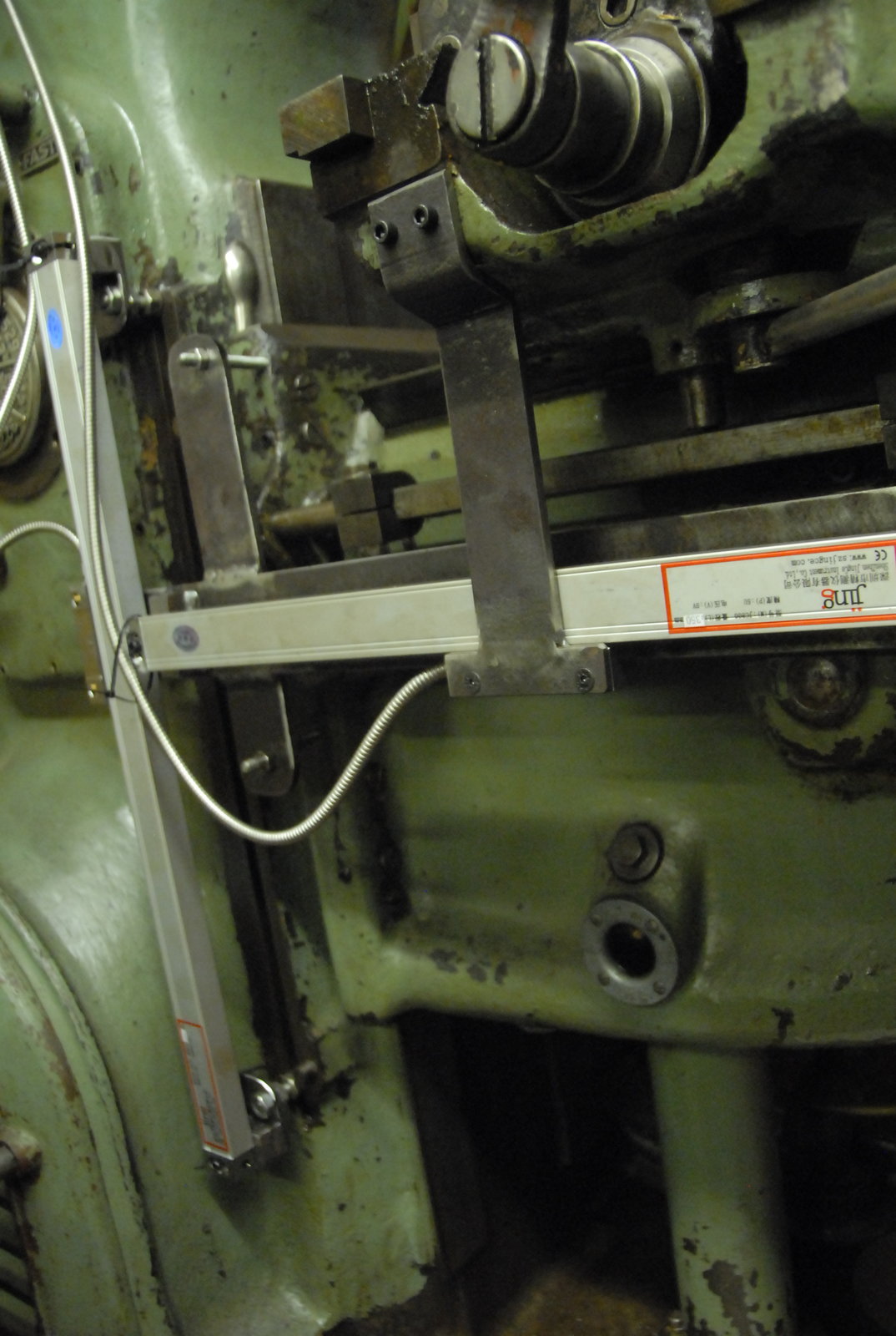

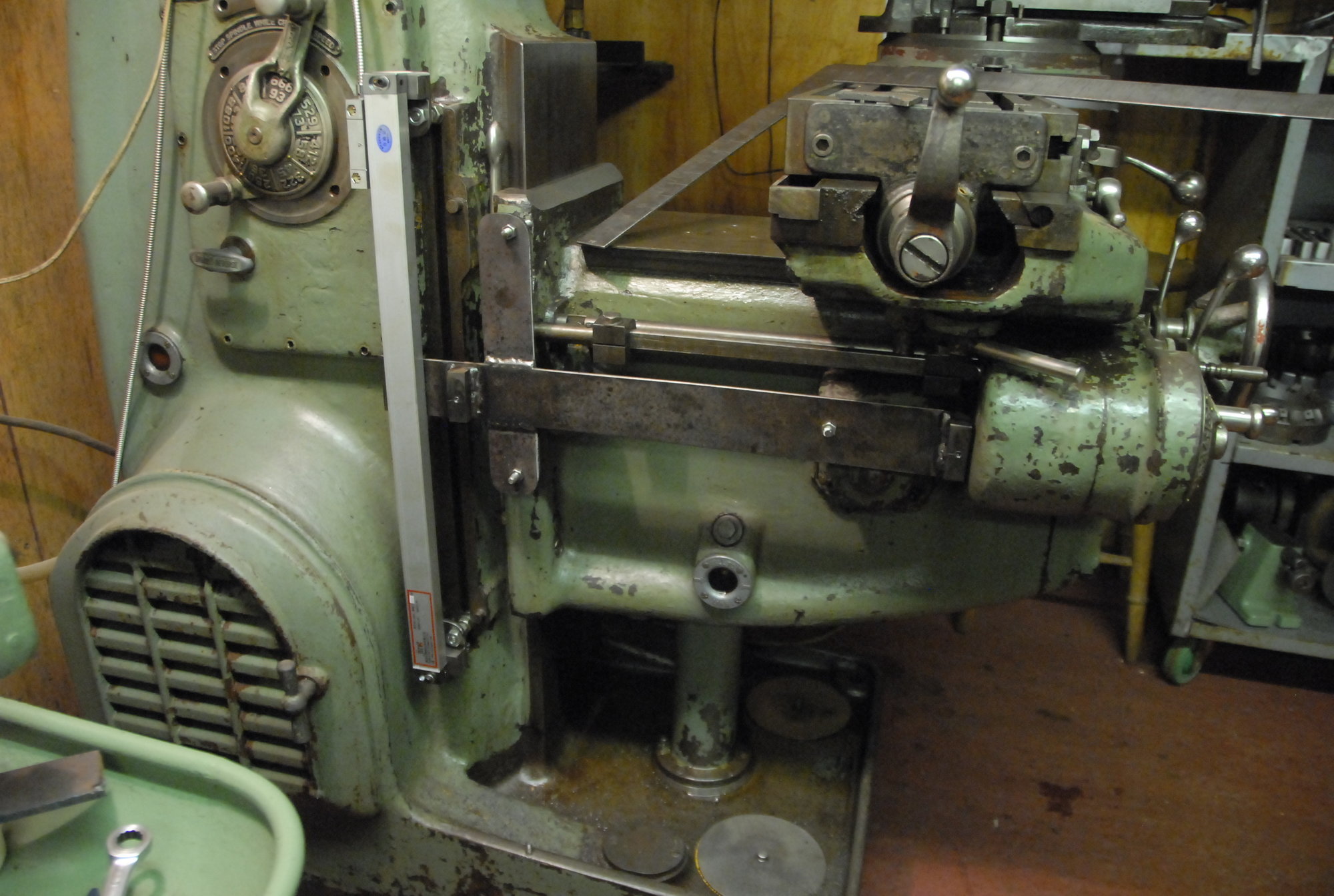

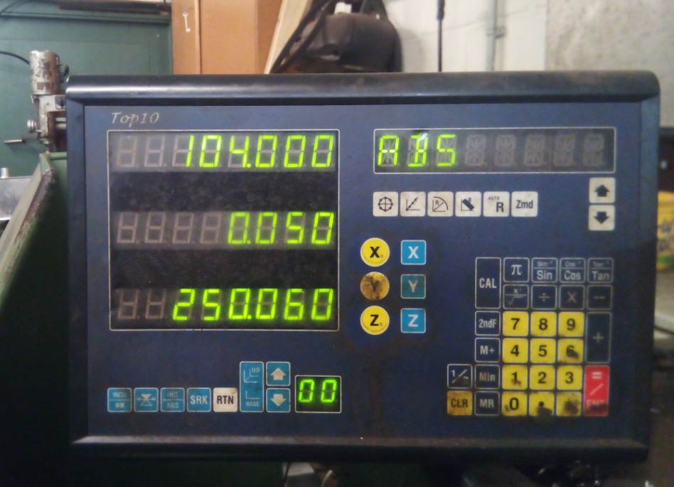

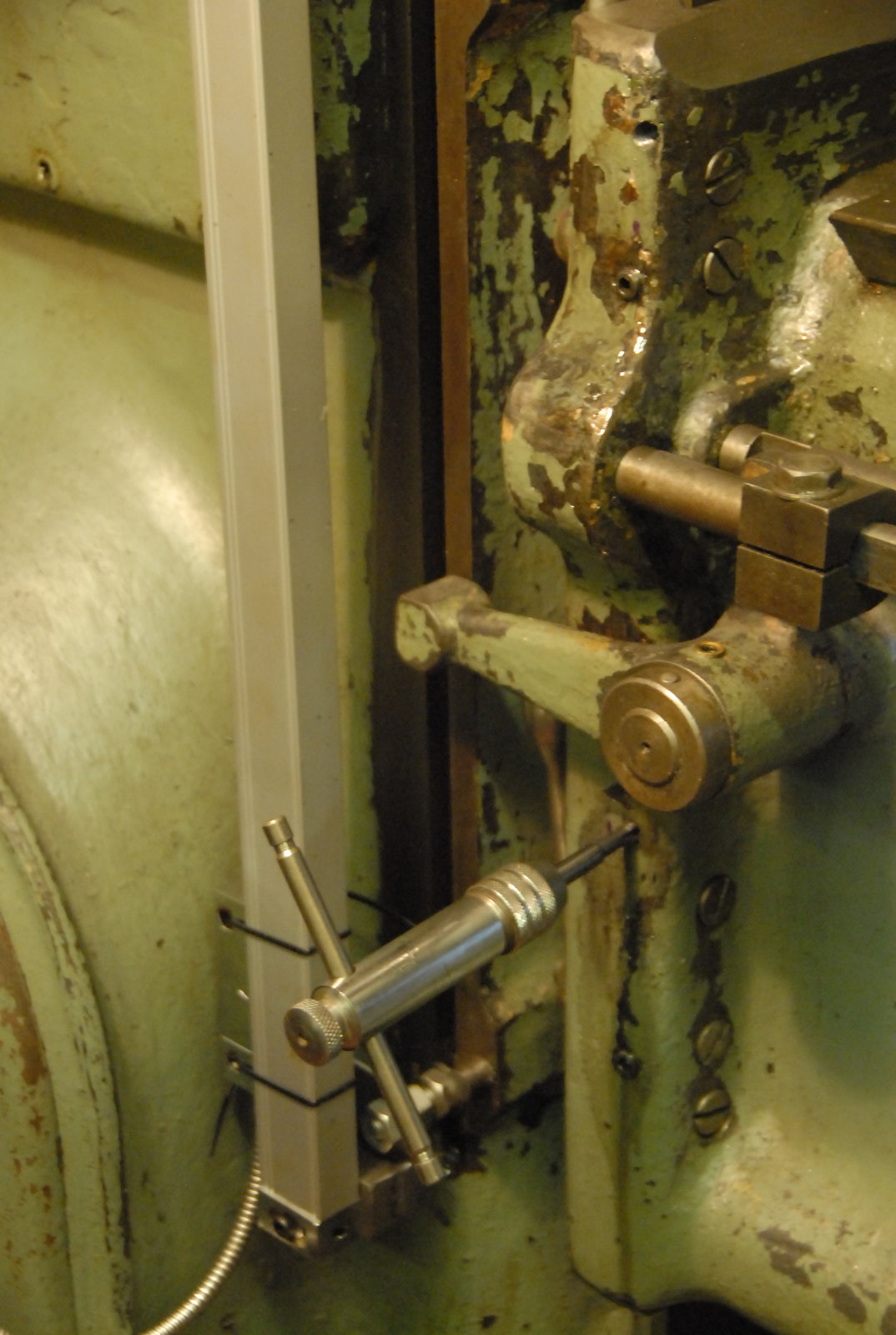

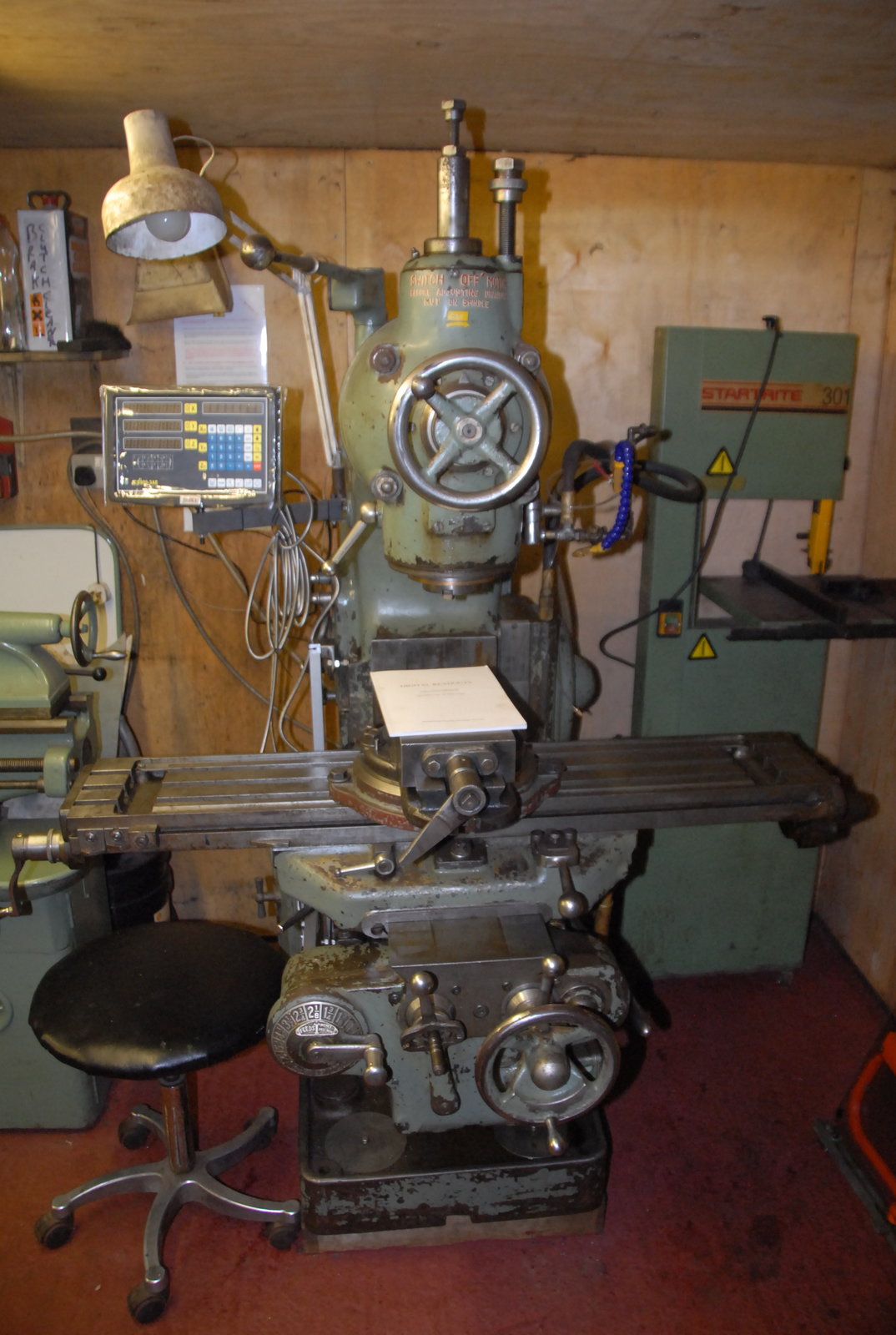

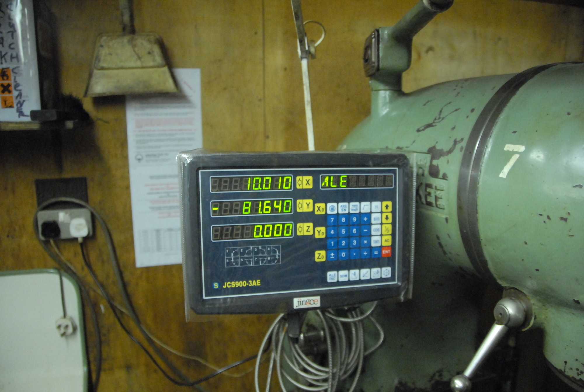

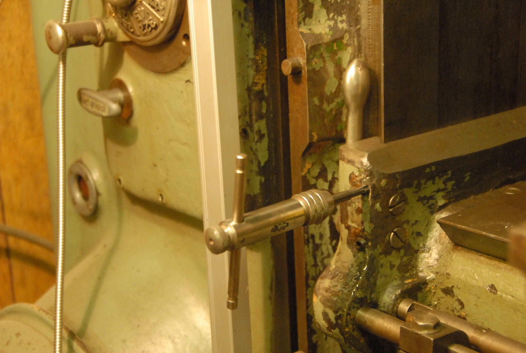

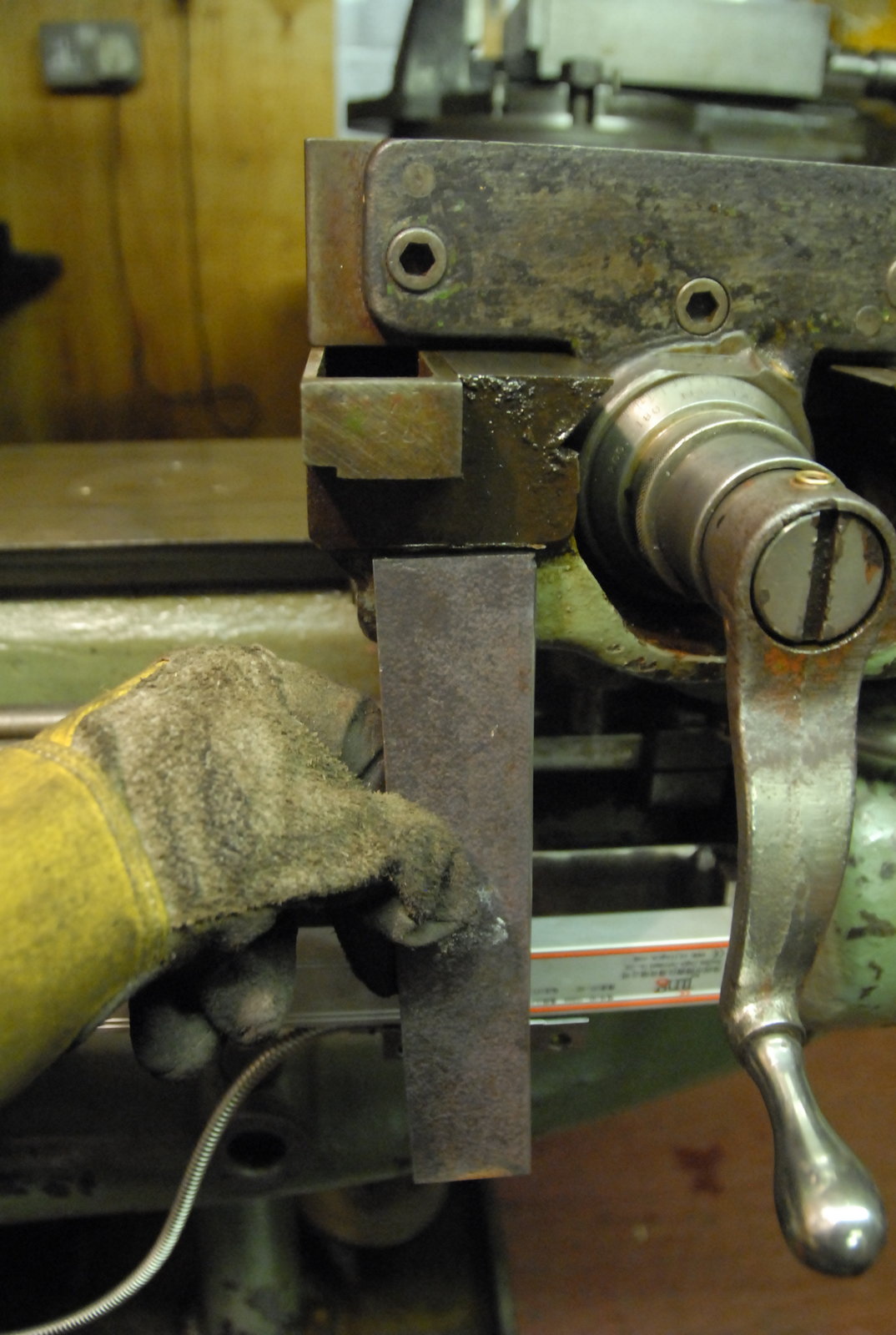

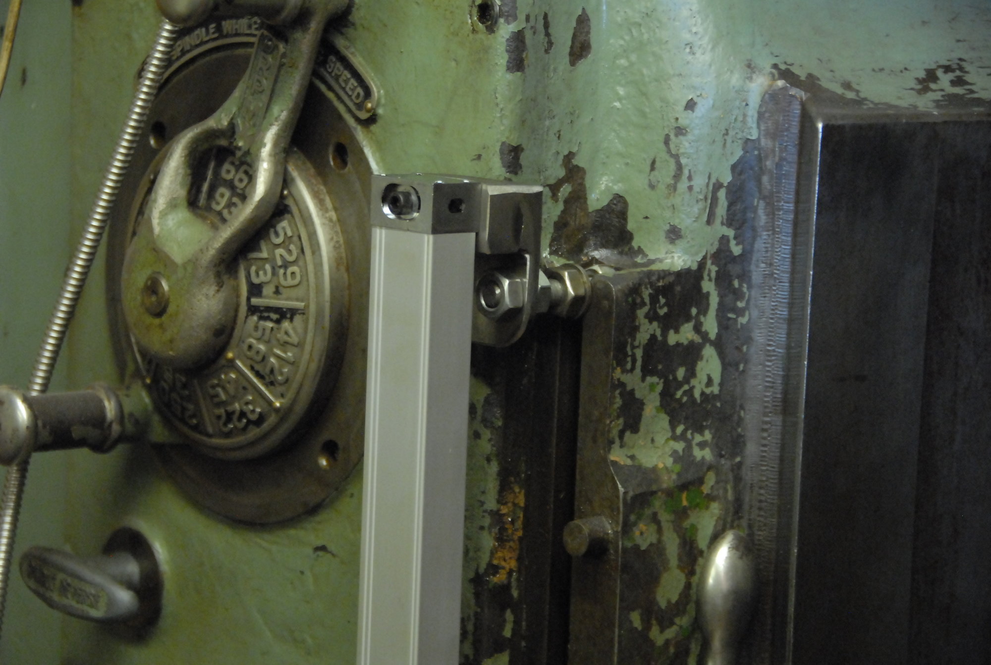

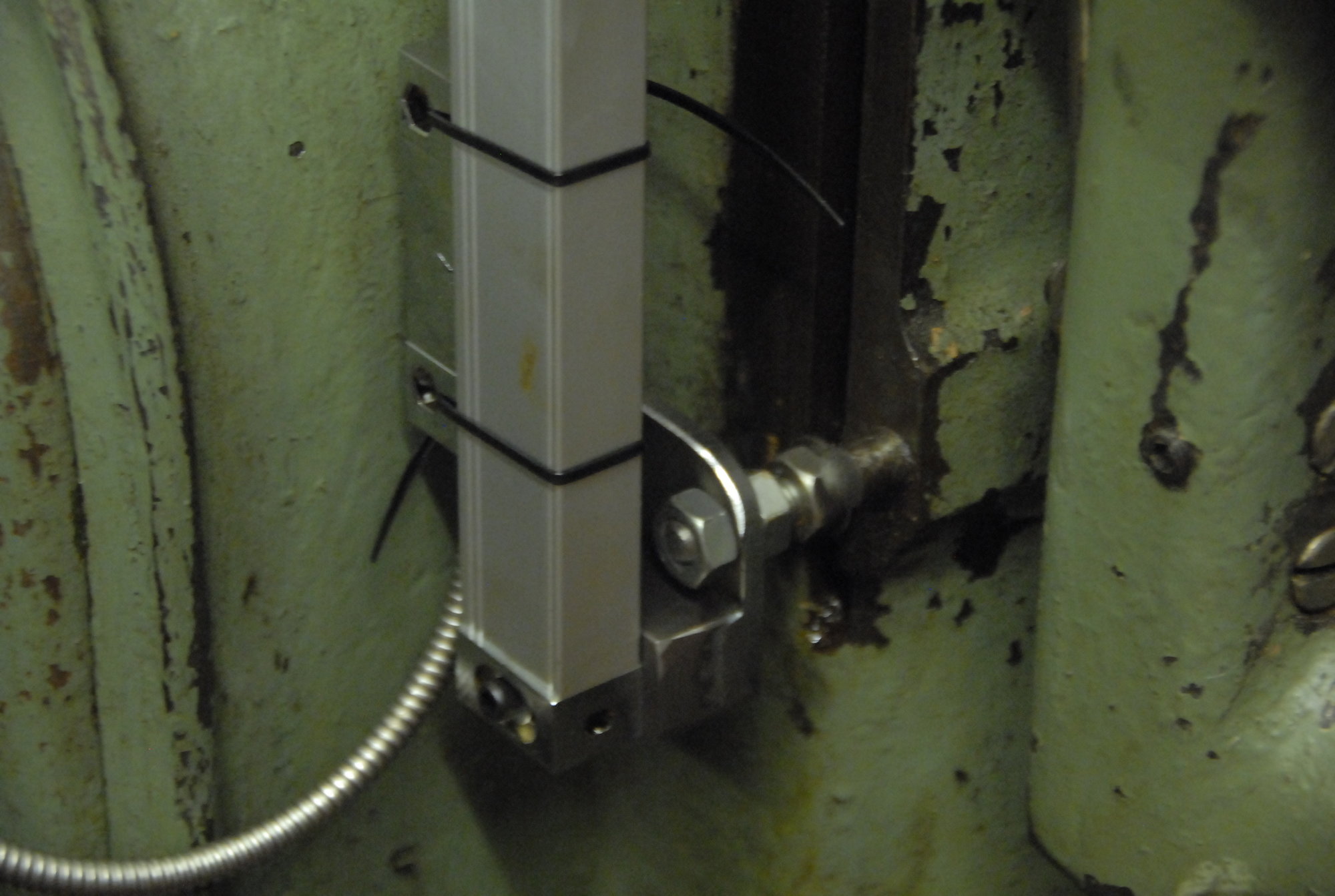

Here is a pic of mine after about 15 years, it is on my lathe, originally it was on a Bridgeport (POS)
The X values entered will double but I can then just press the 1/2 button followed by the X and it gives the correct value
That's very very similar to mine and though I haven't read the manual in a while I'm sure I remember reading that there's a way to switch between diameter and radius reading on the X.
