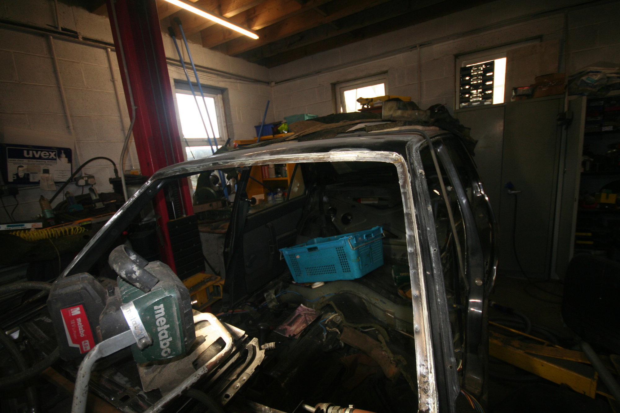

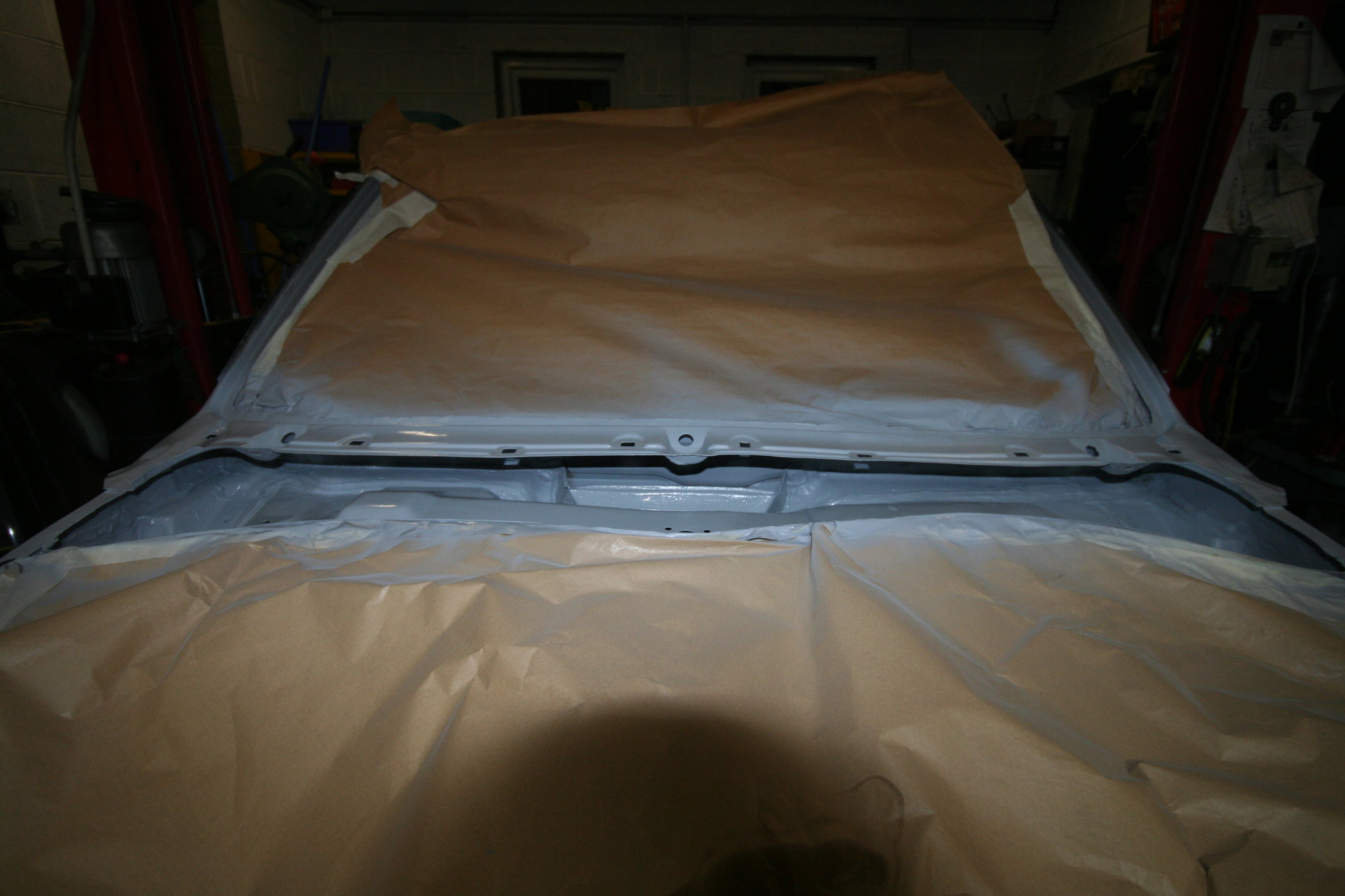

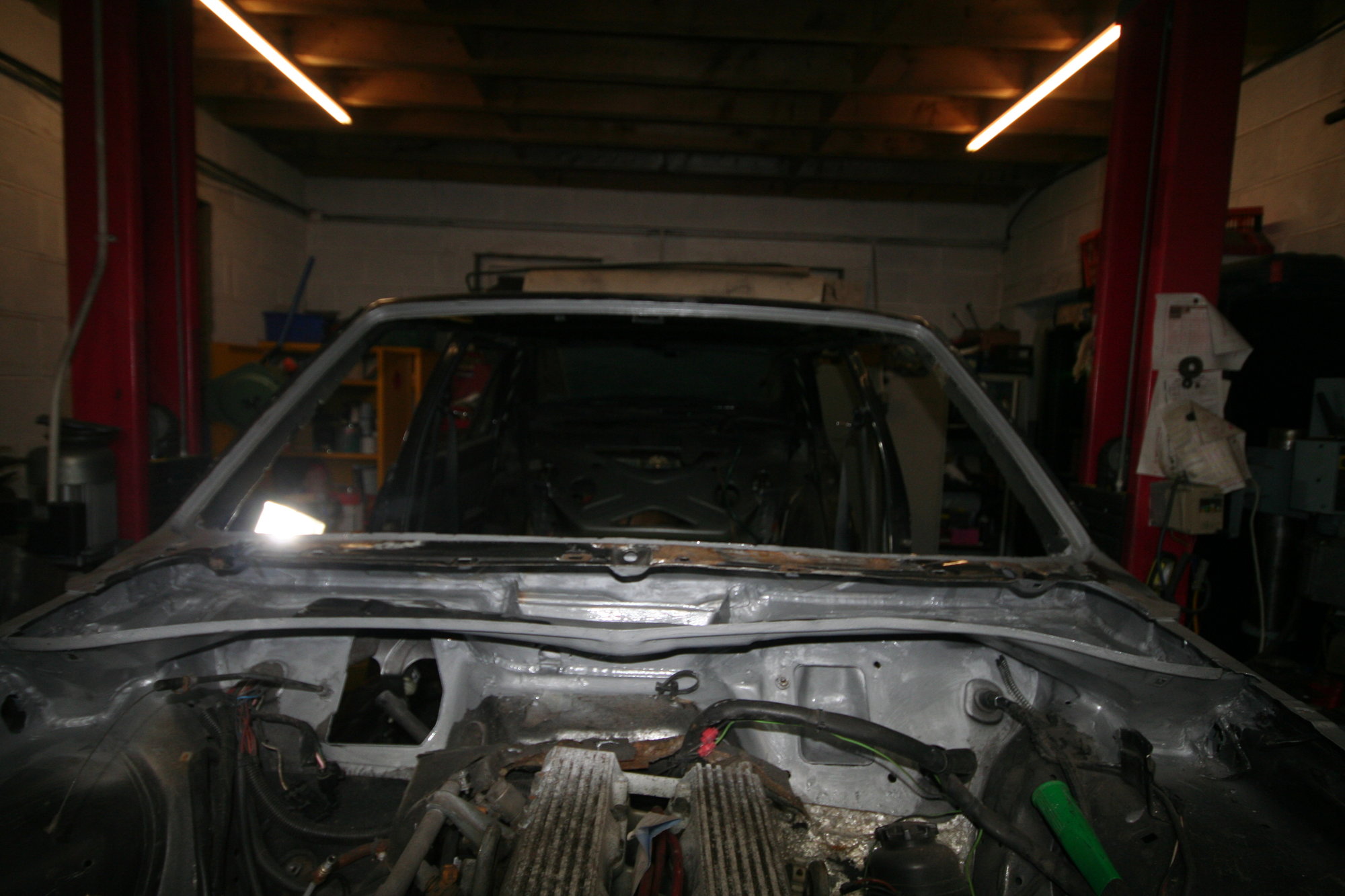

Thanks Exuptoy, starting to see the end of the welding now but was really p****d off that I didn't get more done over the Christmas break.

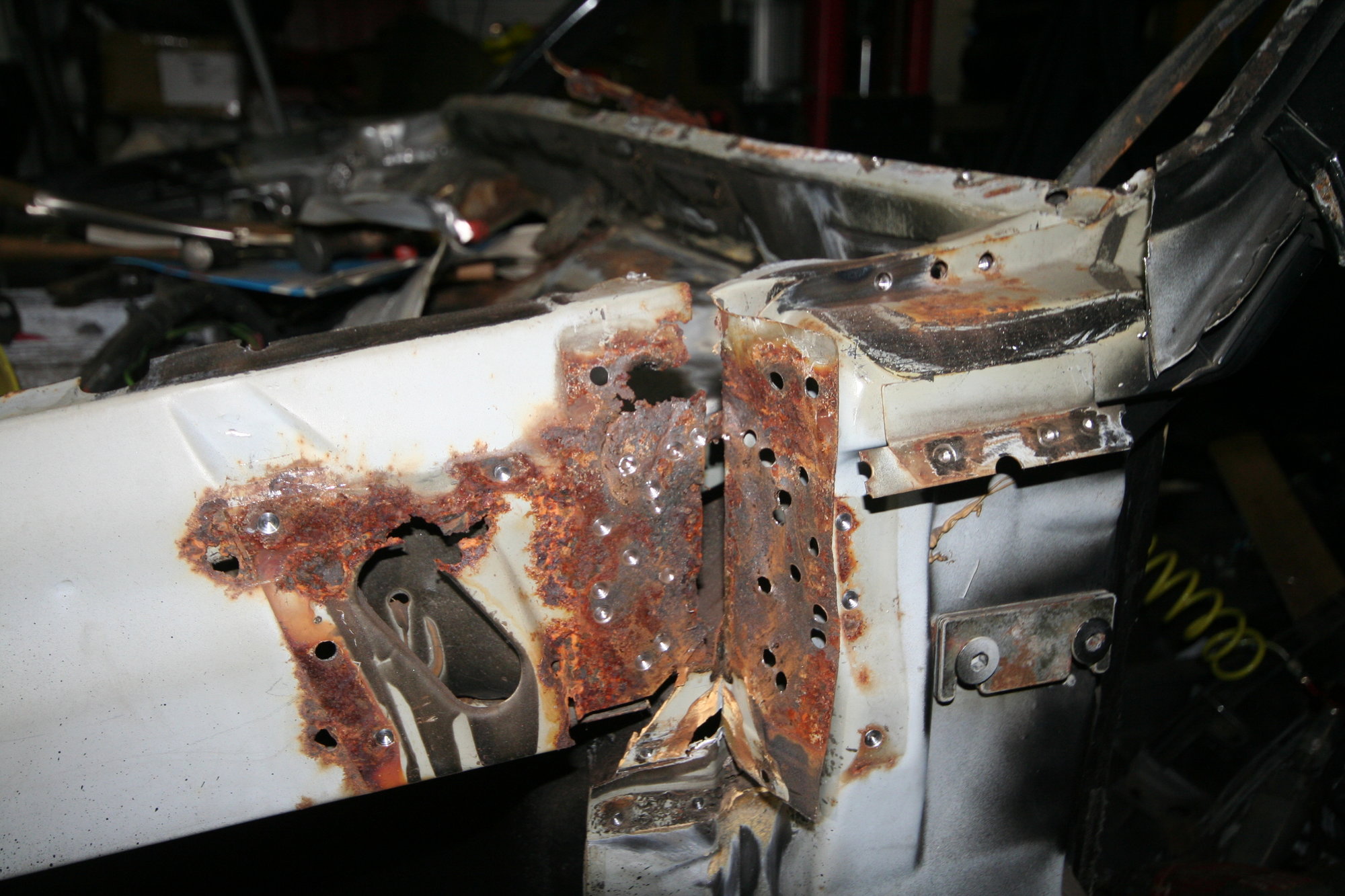

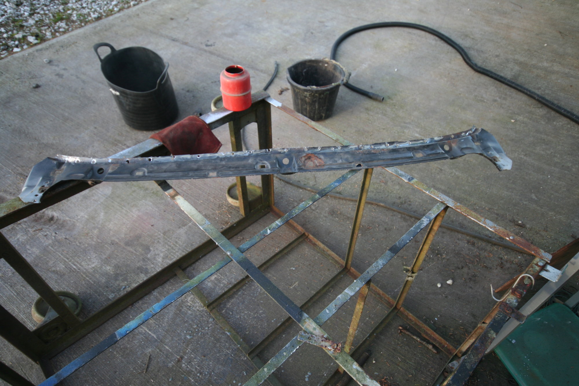

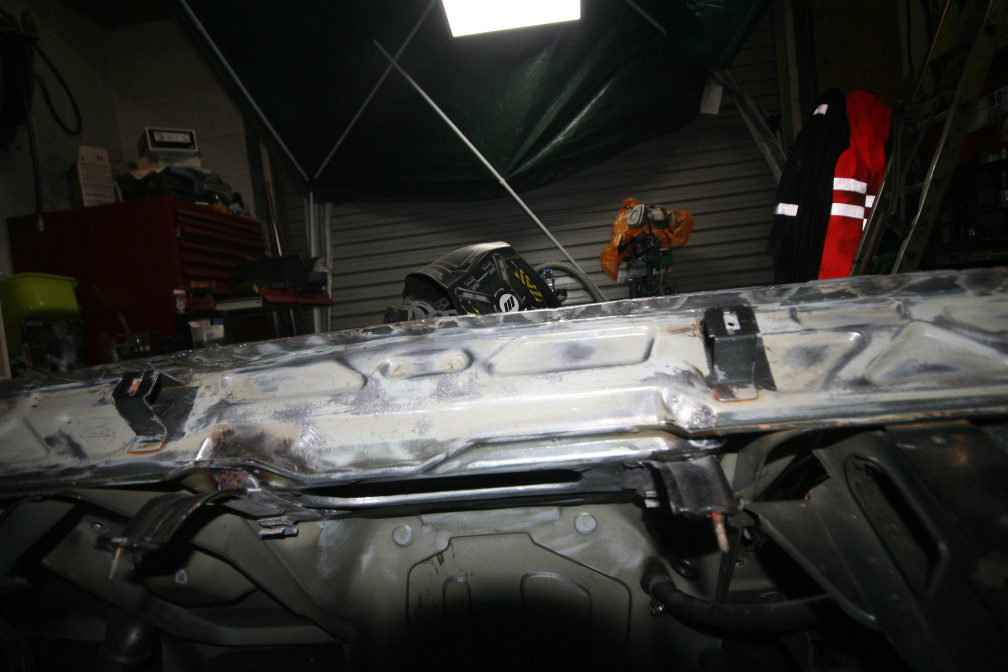

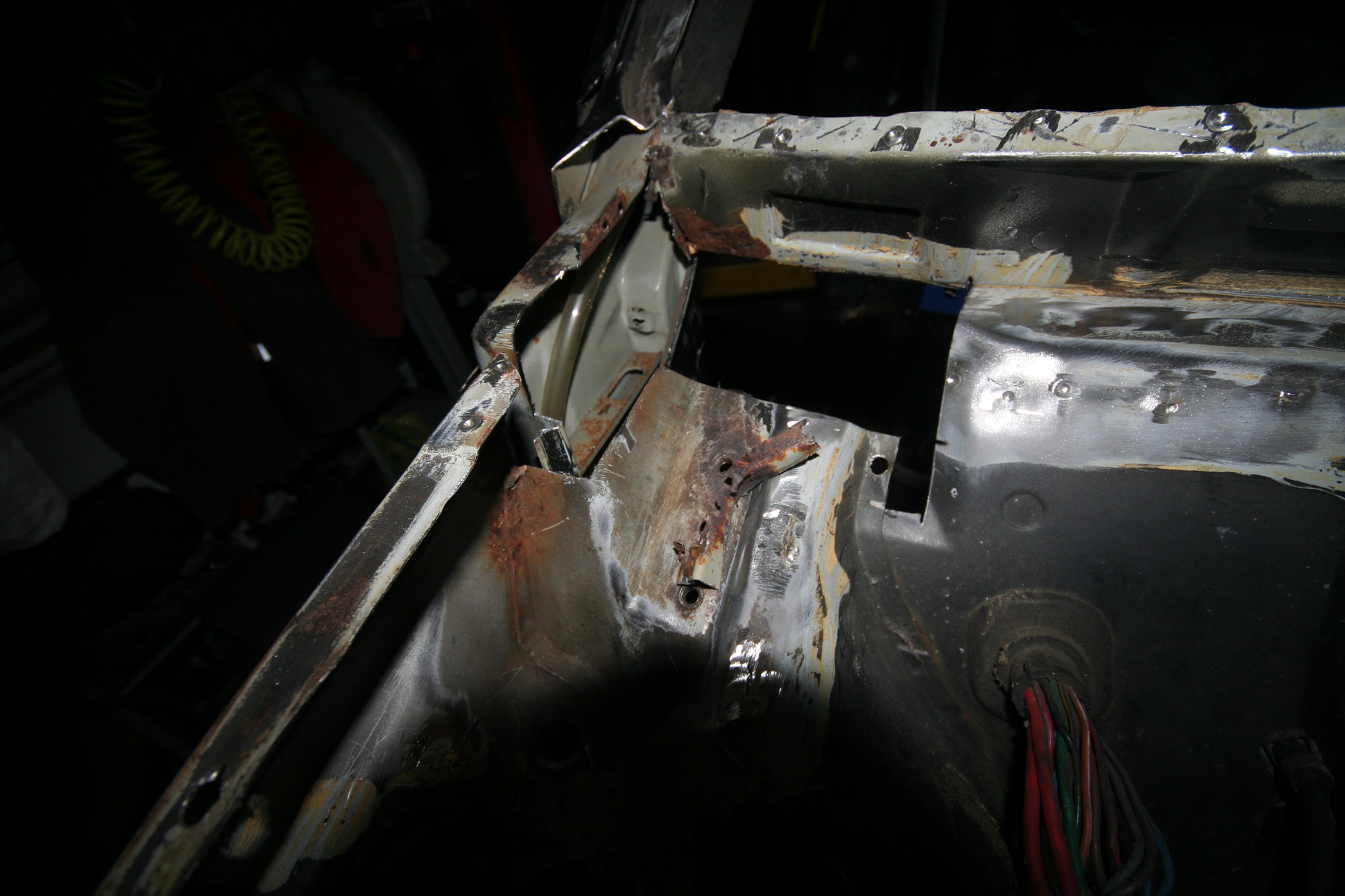

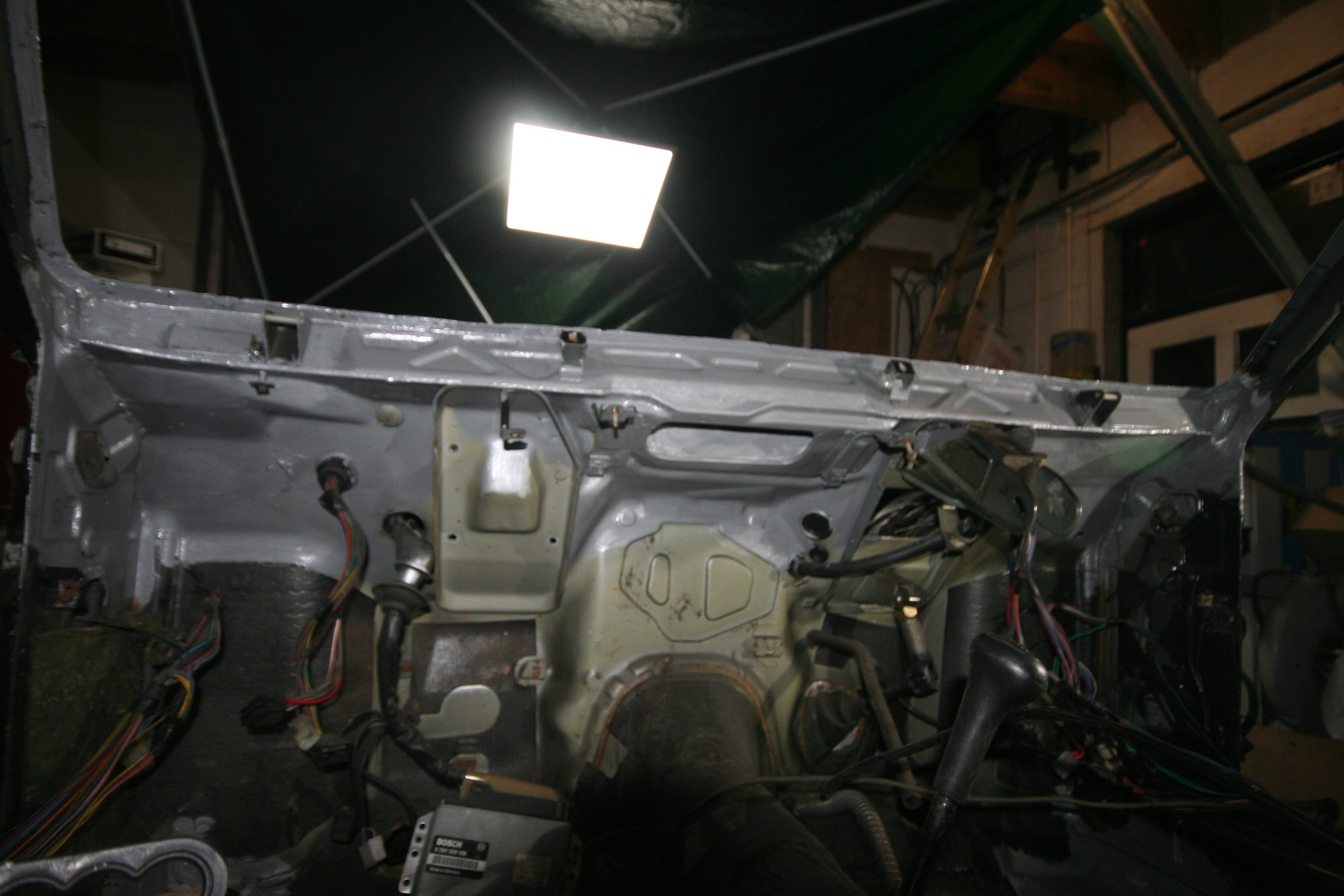

With everything stripped out was glad I removed the screen as the screen surround is pretty scabby in places.

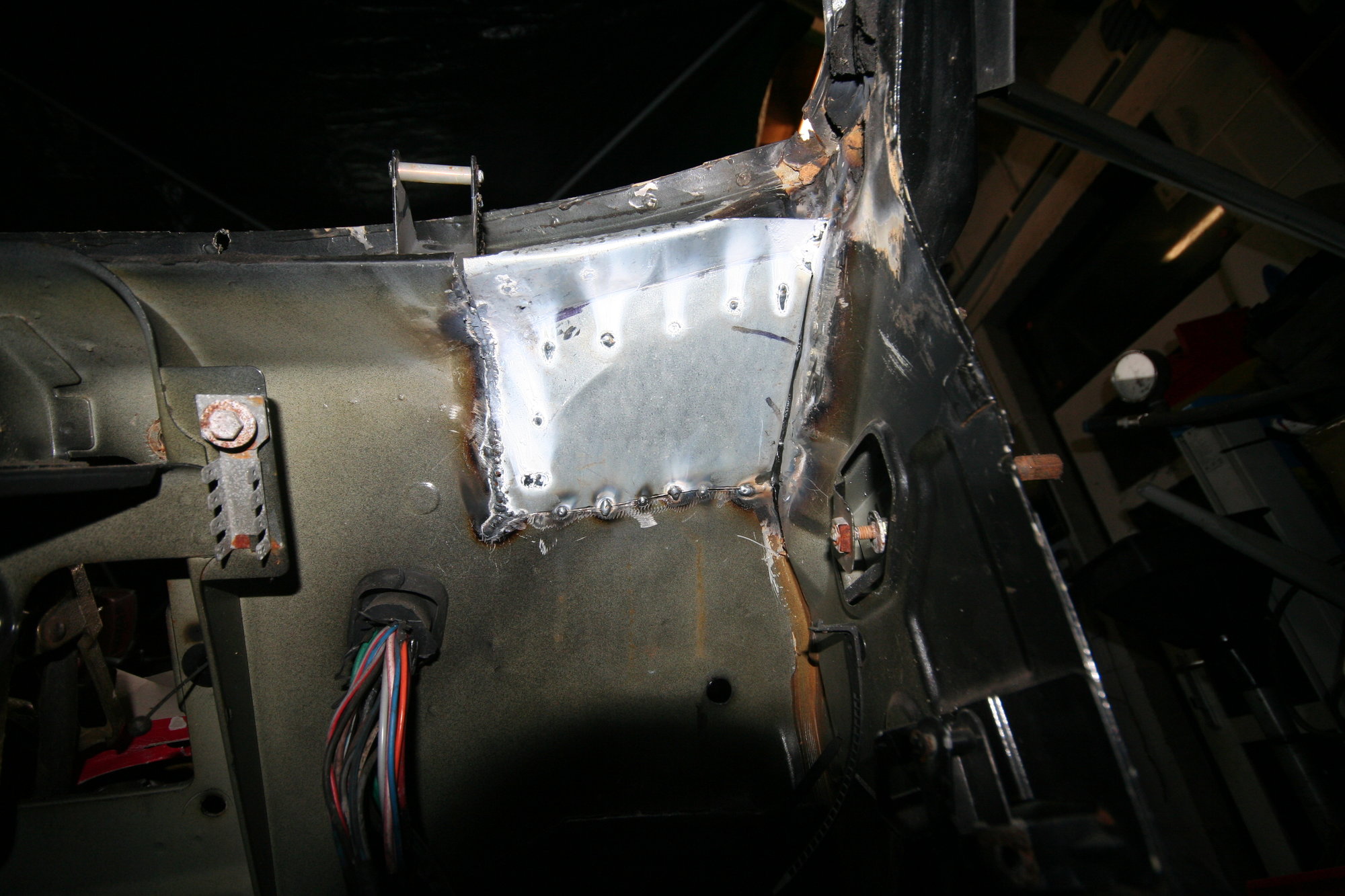

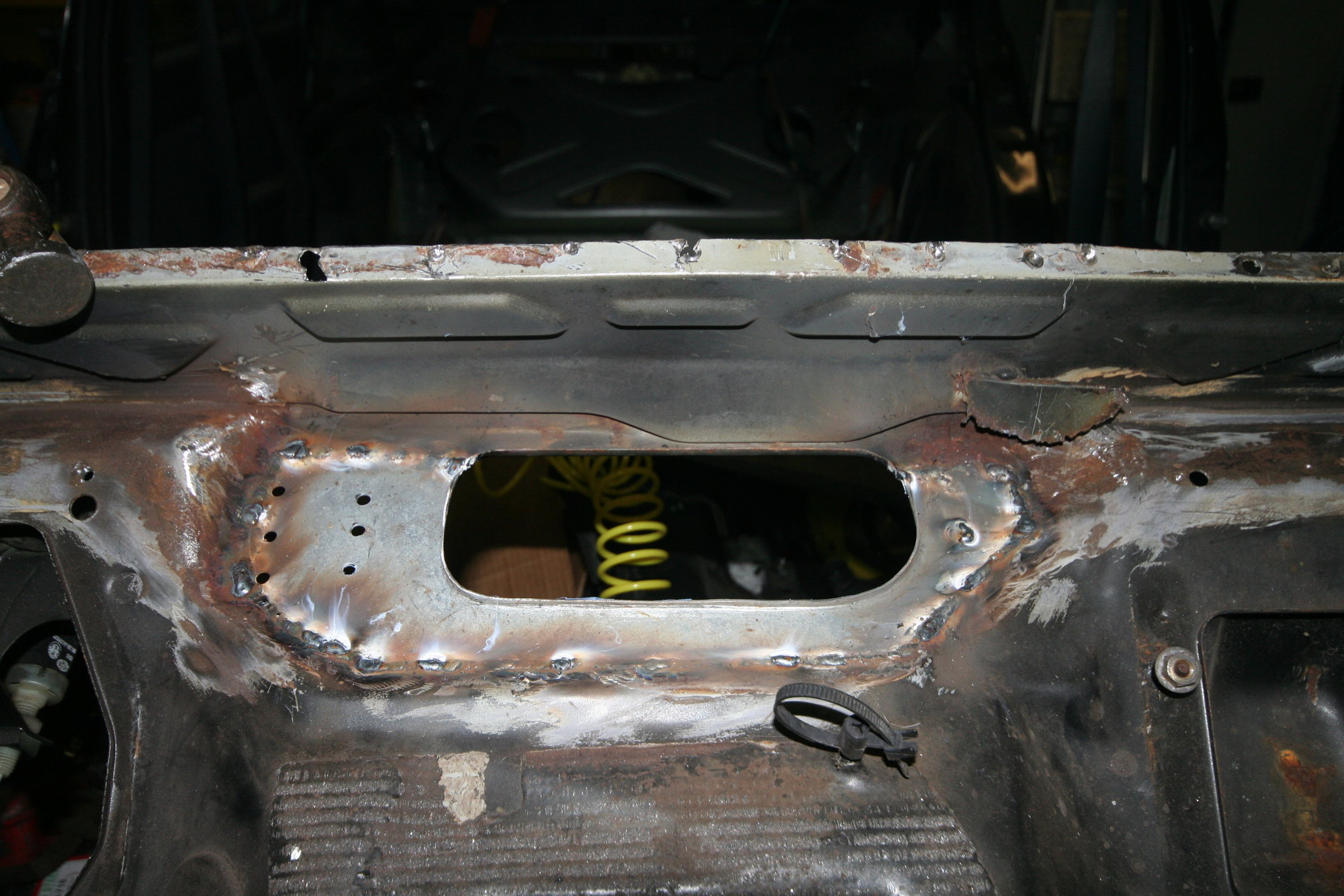

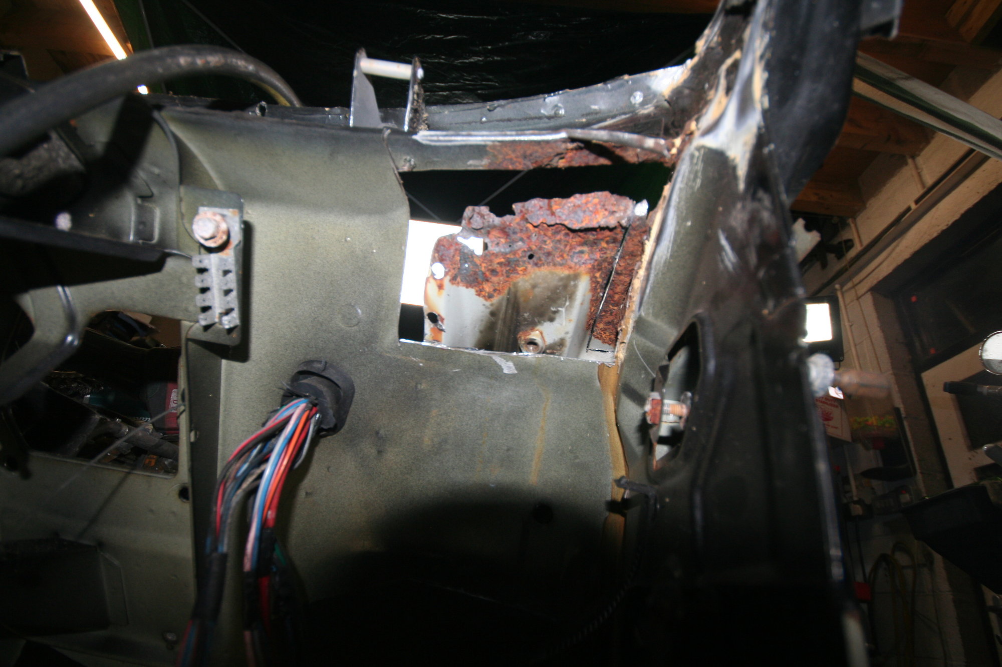

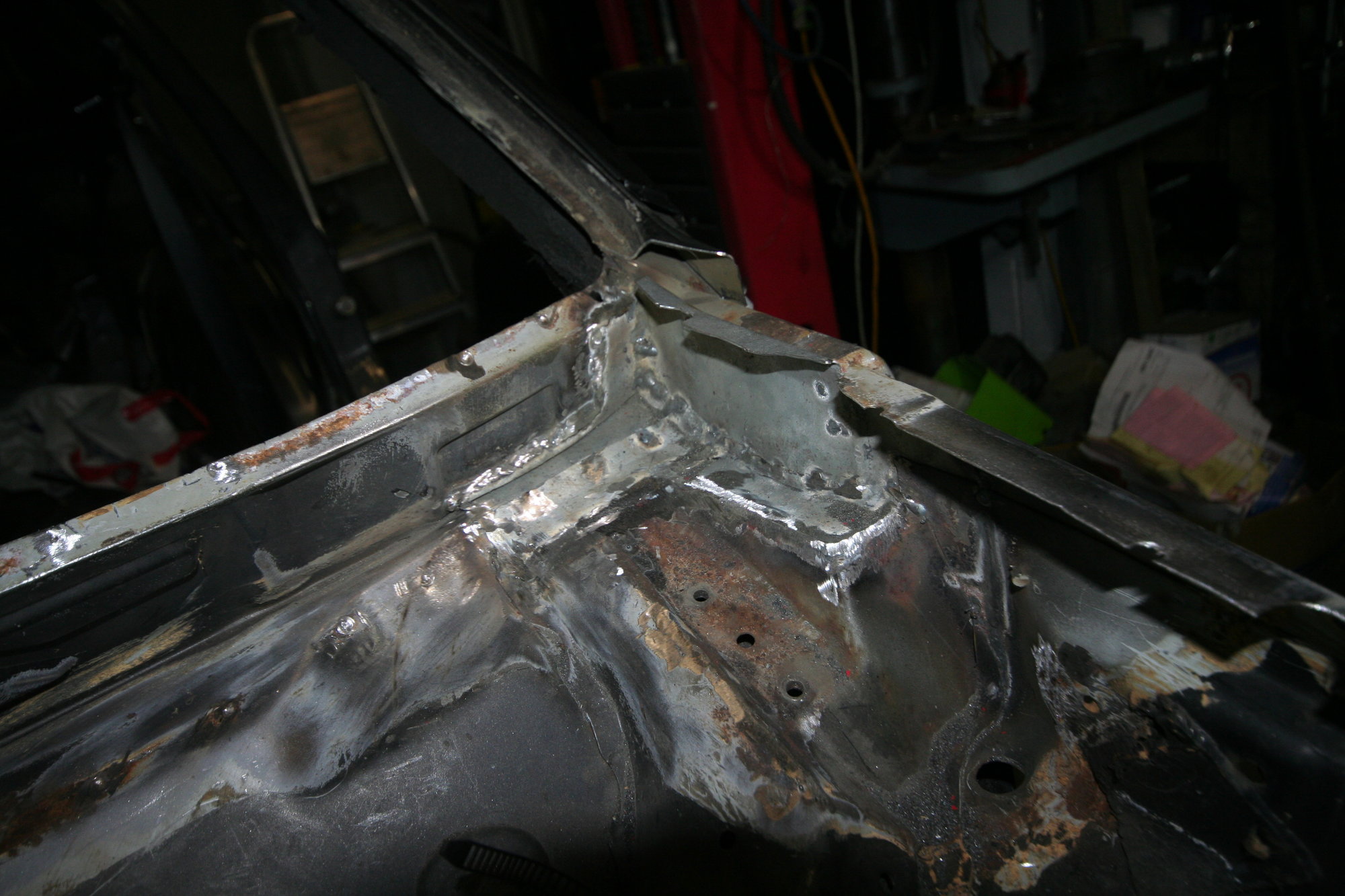

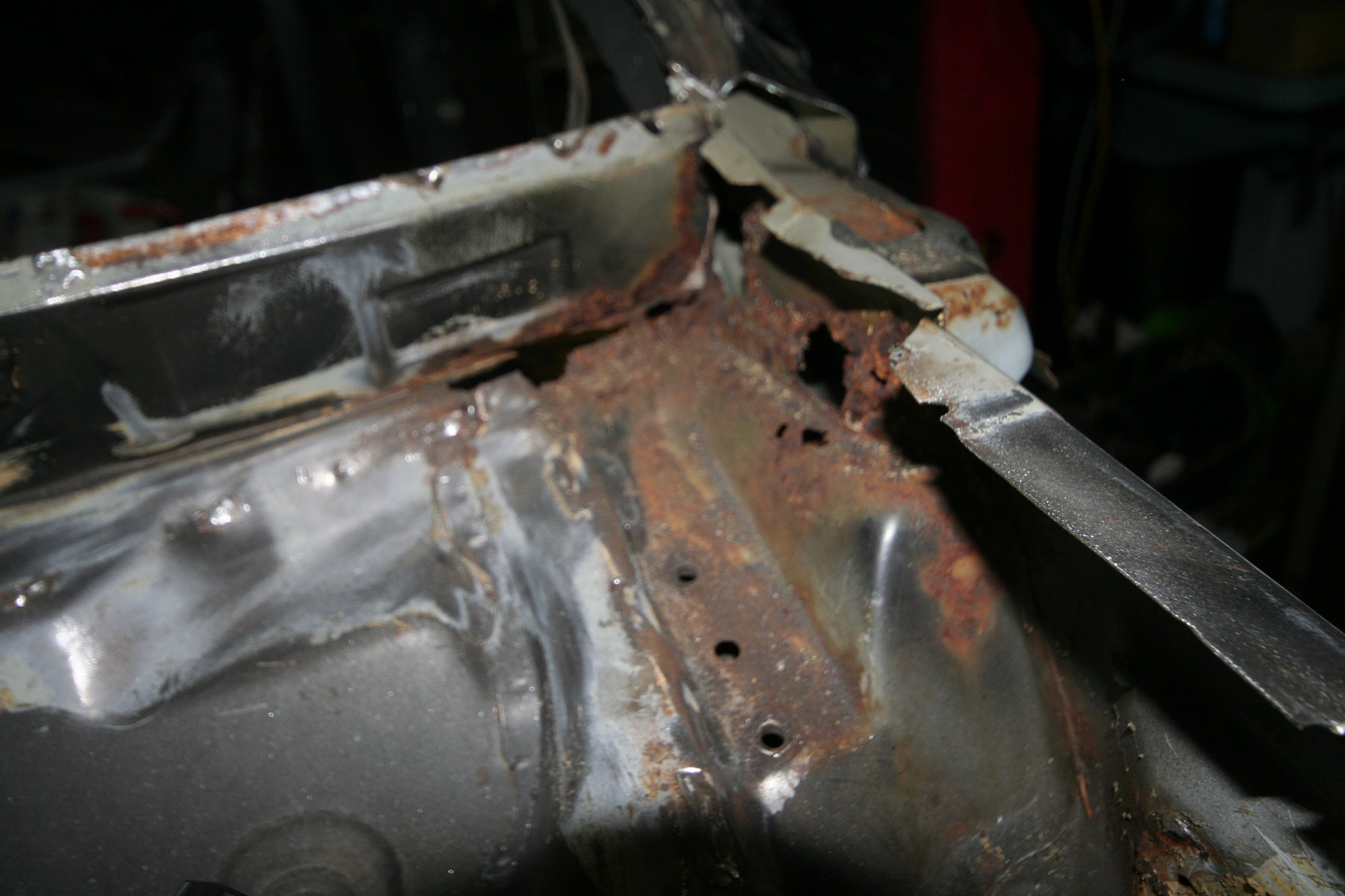

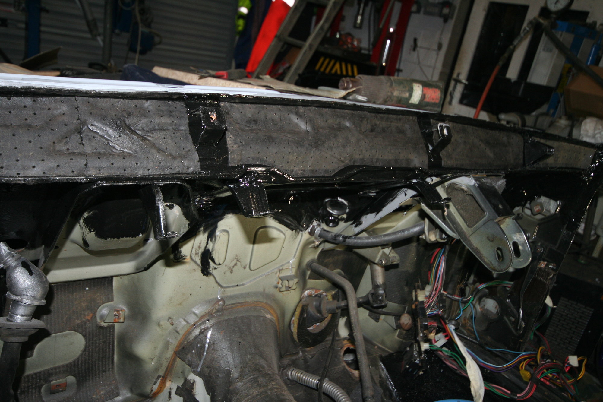

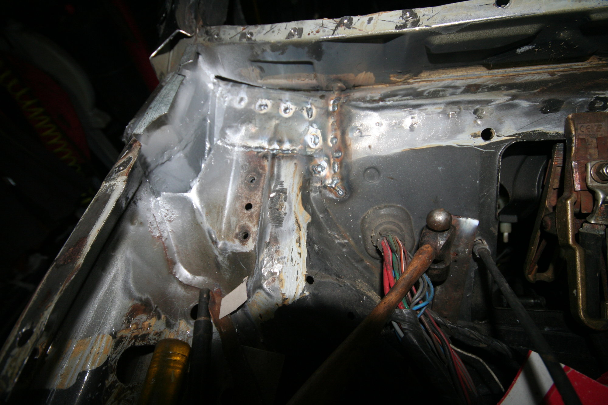

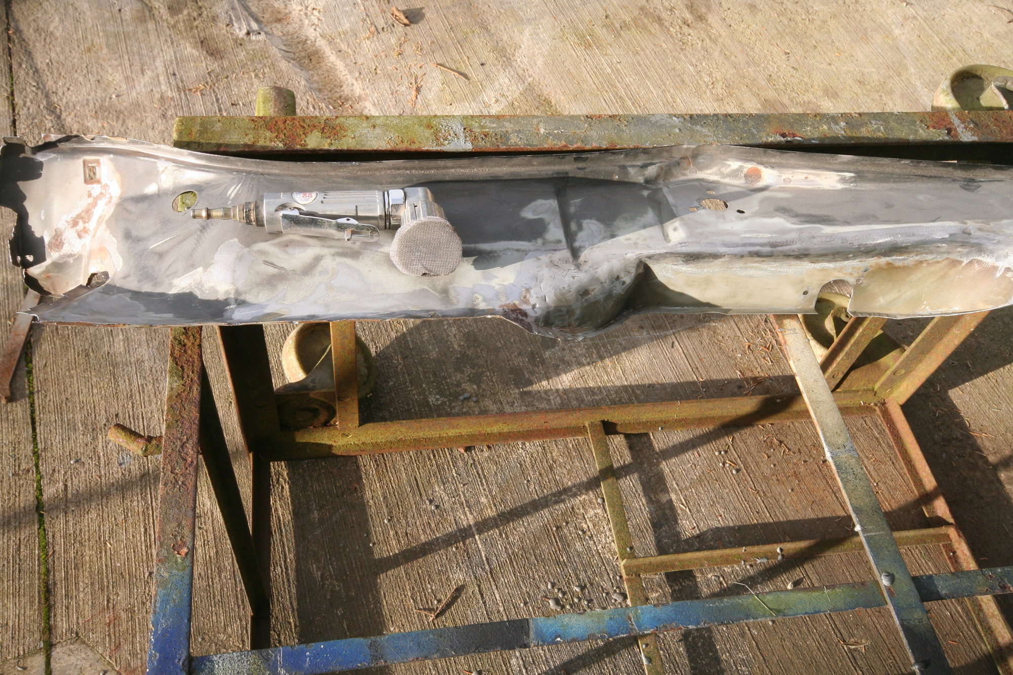

First job was the rot at the bonnet hinges.
Again it's in holes but doesn't extend too far.

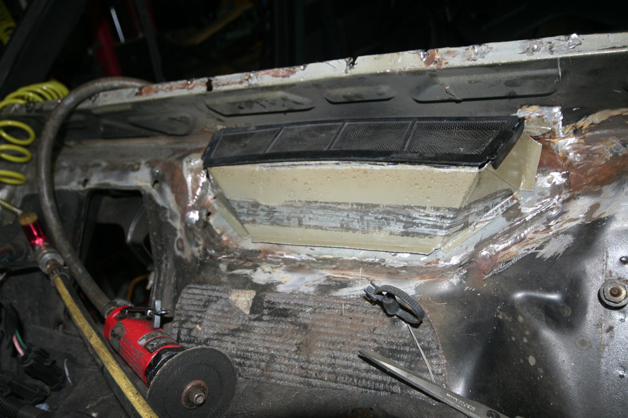

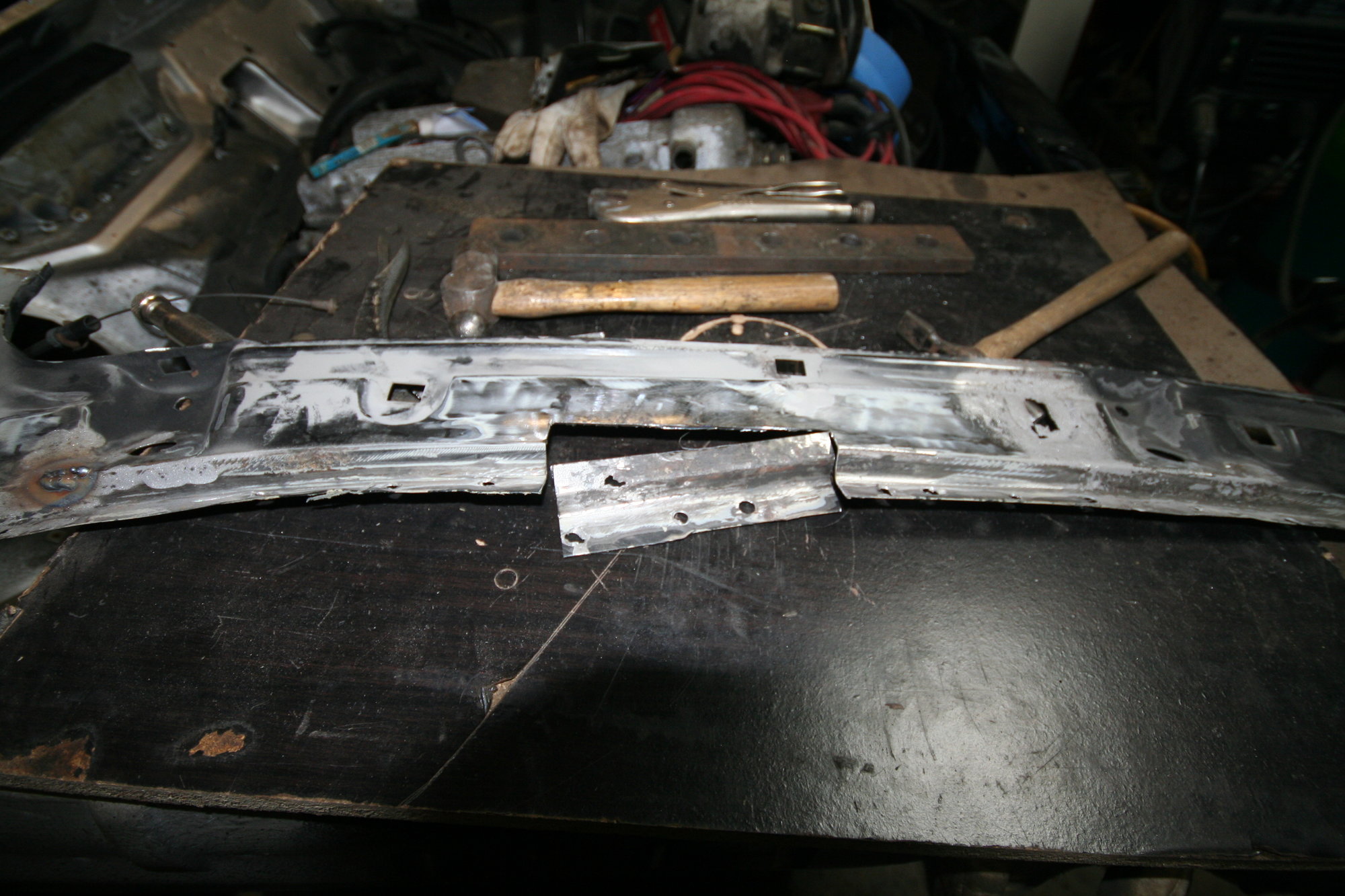

Started by cutting from the inside at the underside of the dash
Then from the top side.

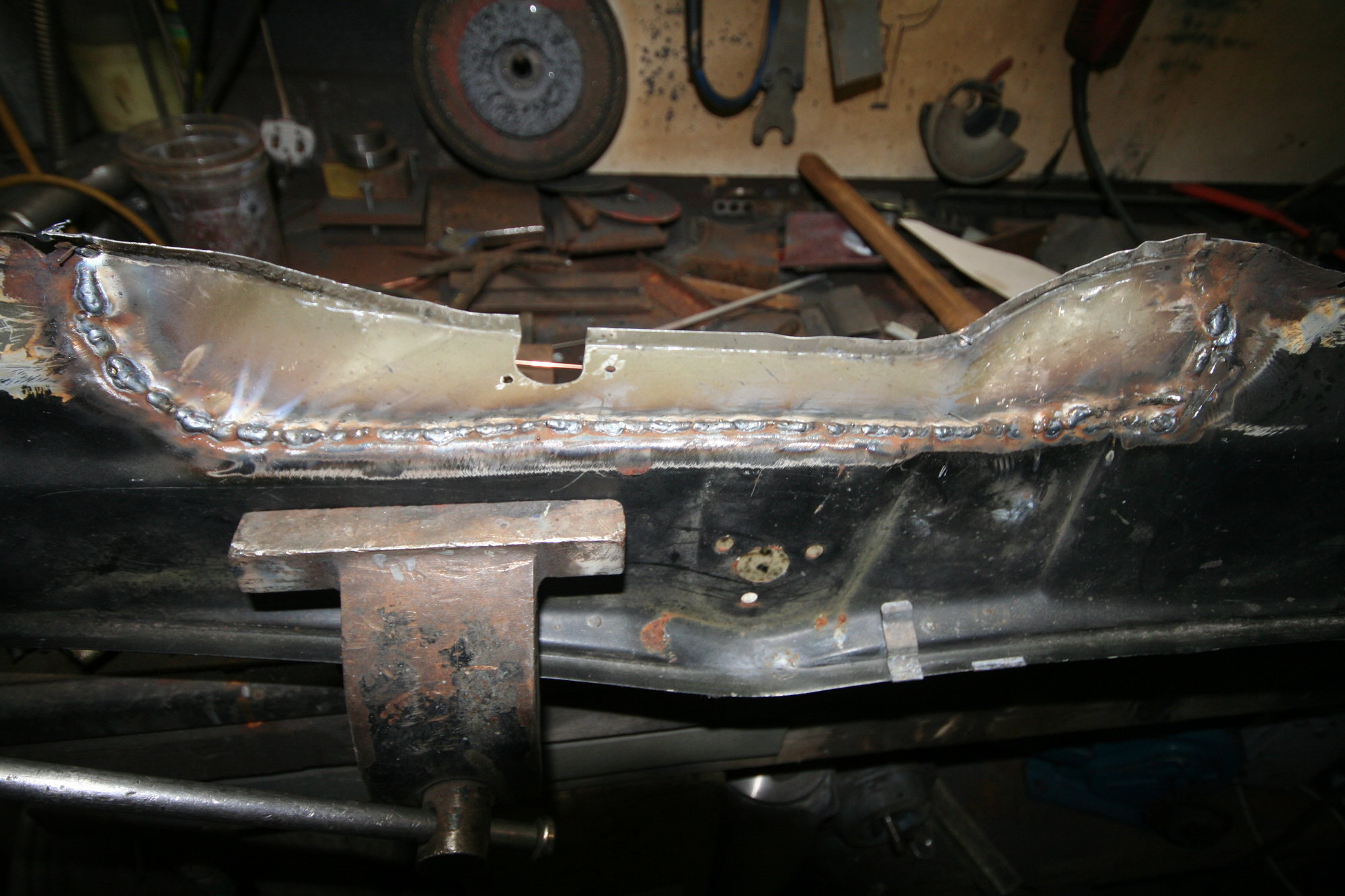

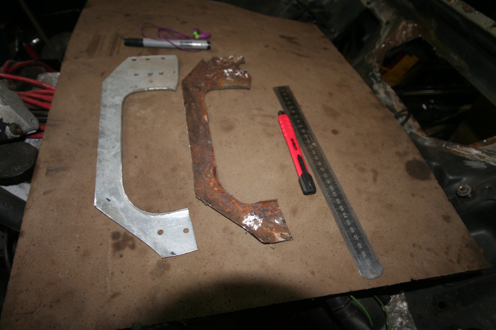

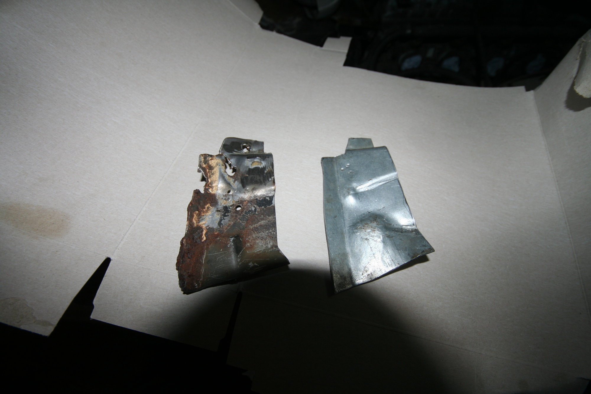

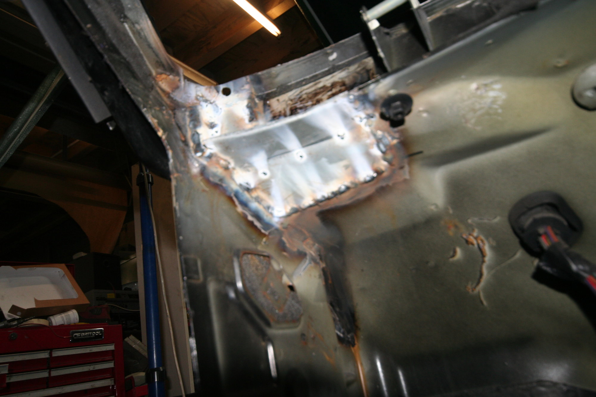

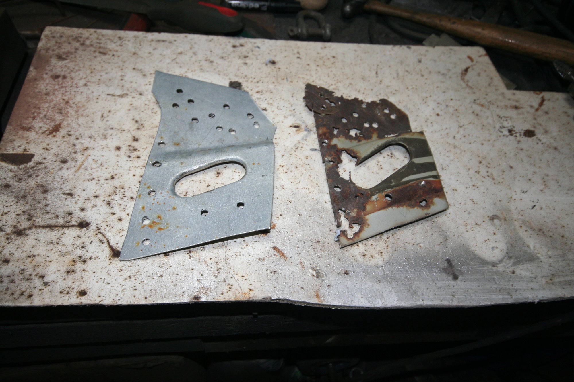

First patch.

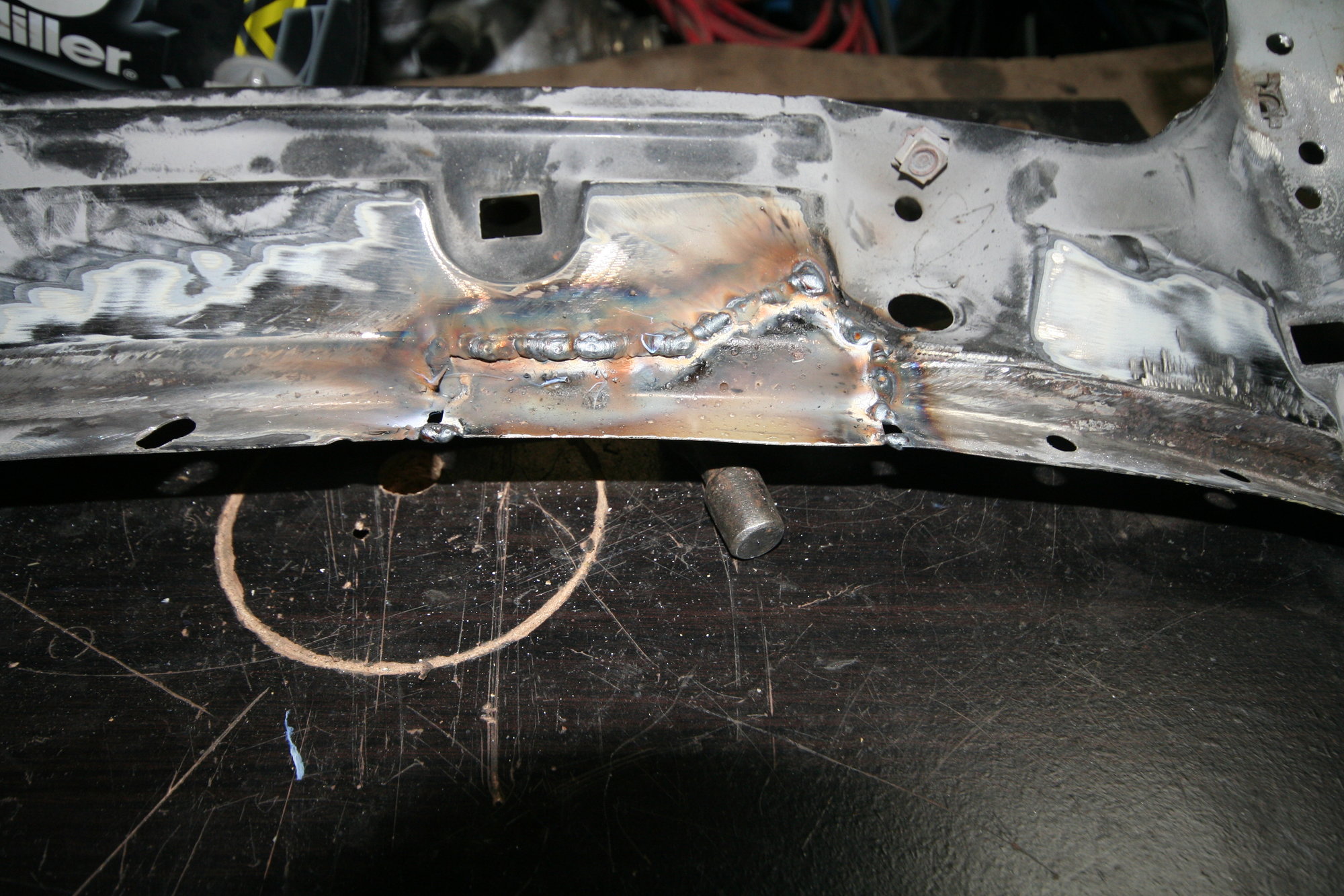

Then the others and weld them in.

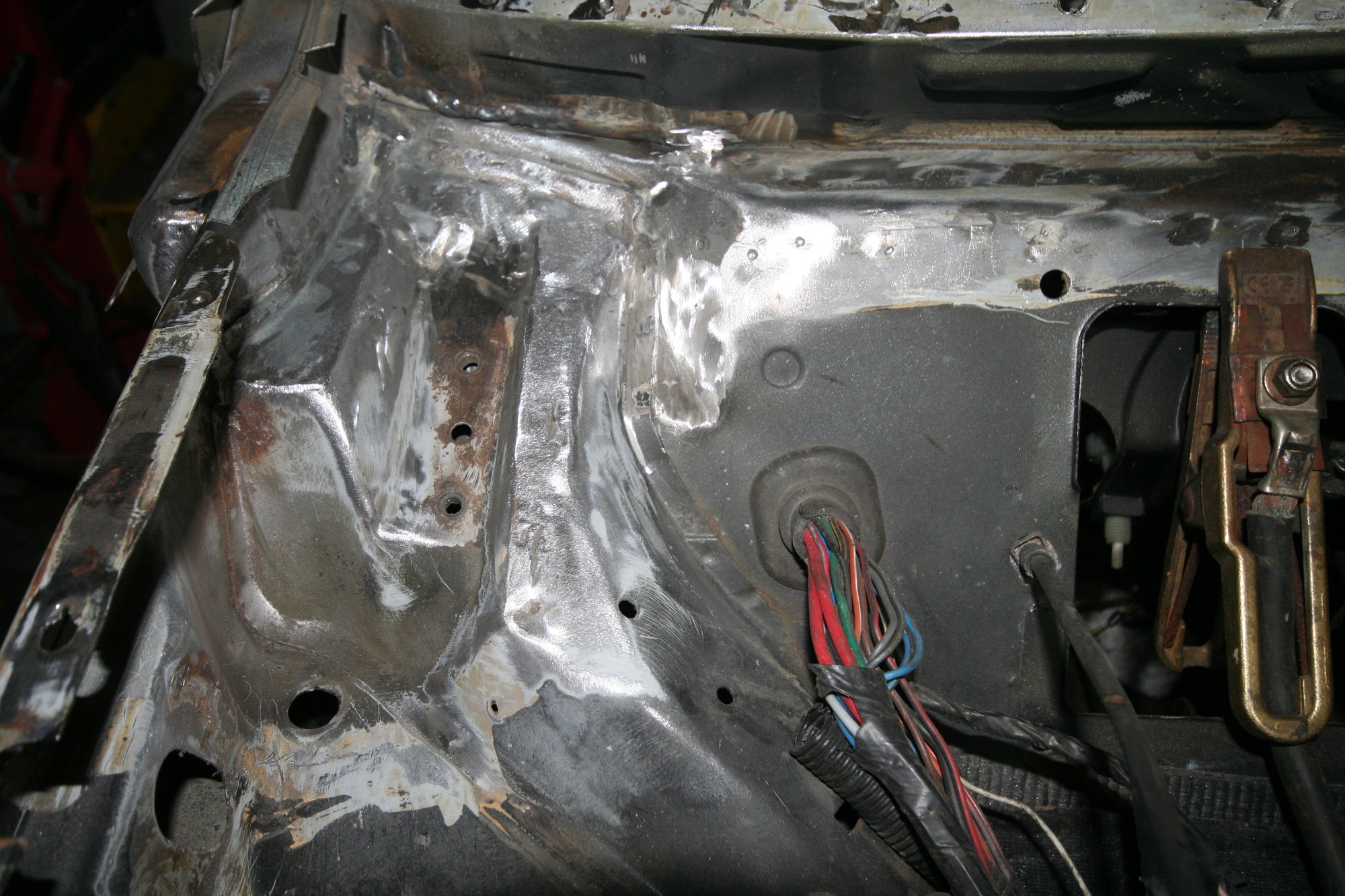

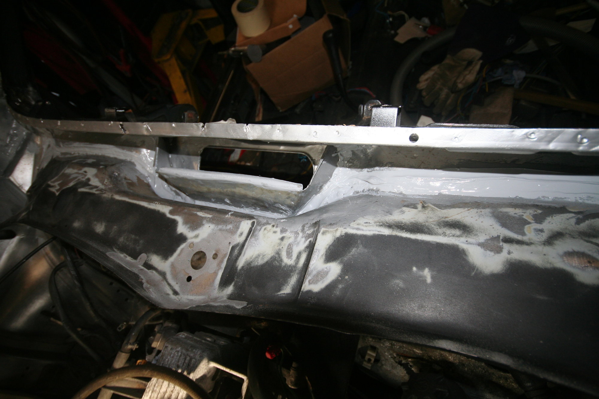

Then tack in the underside.

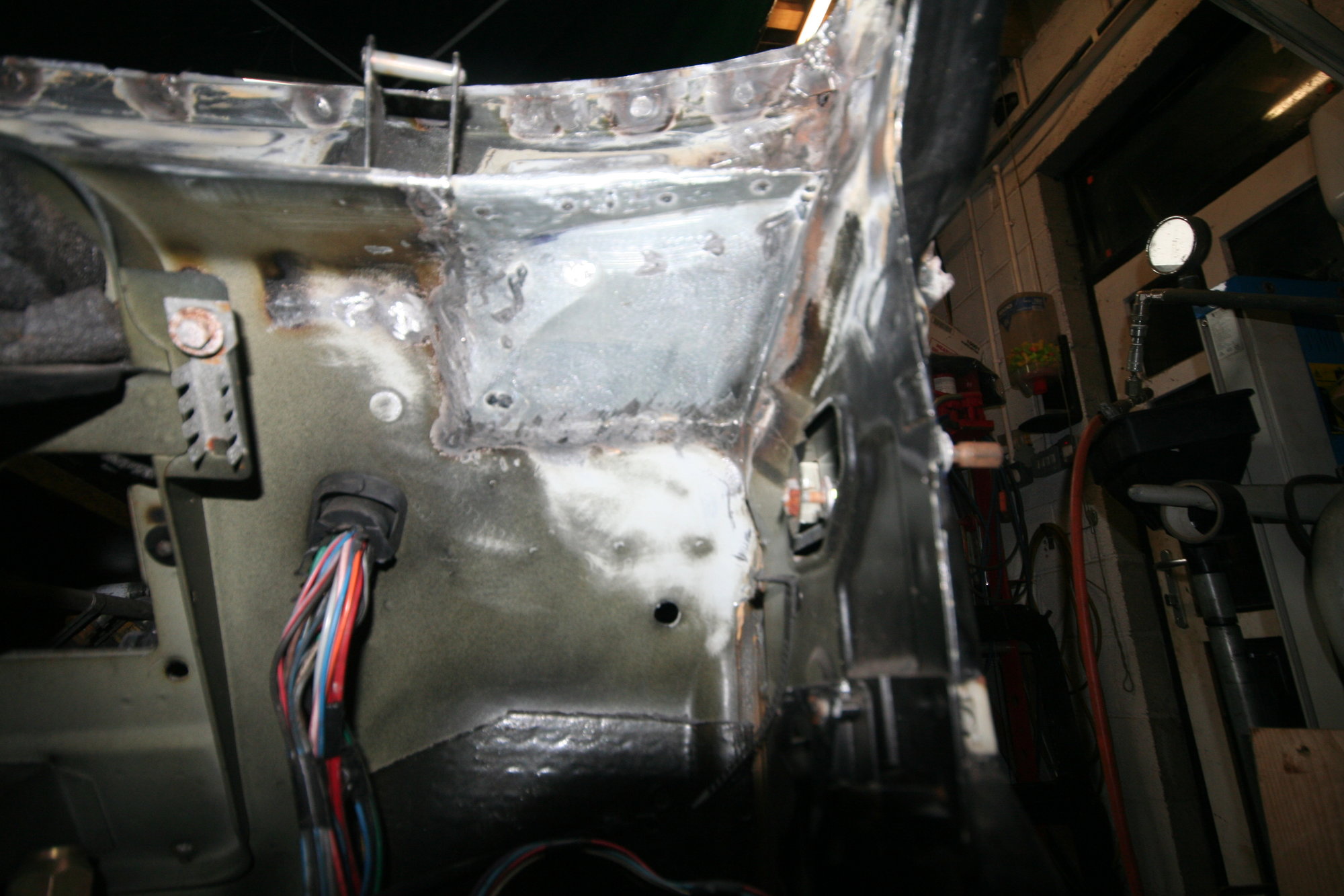

Before finishing it off and grinding the welds.

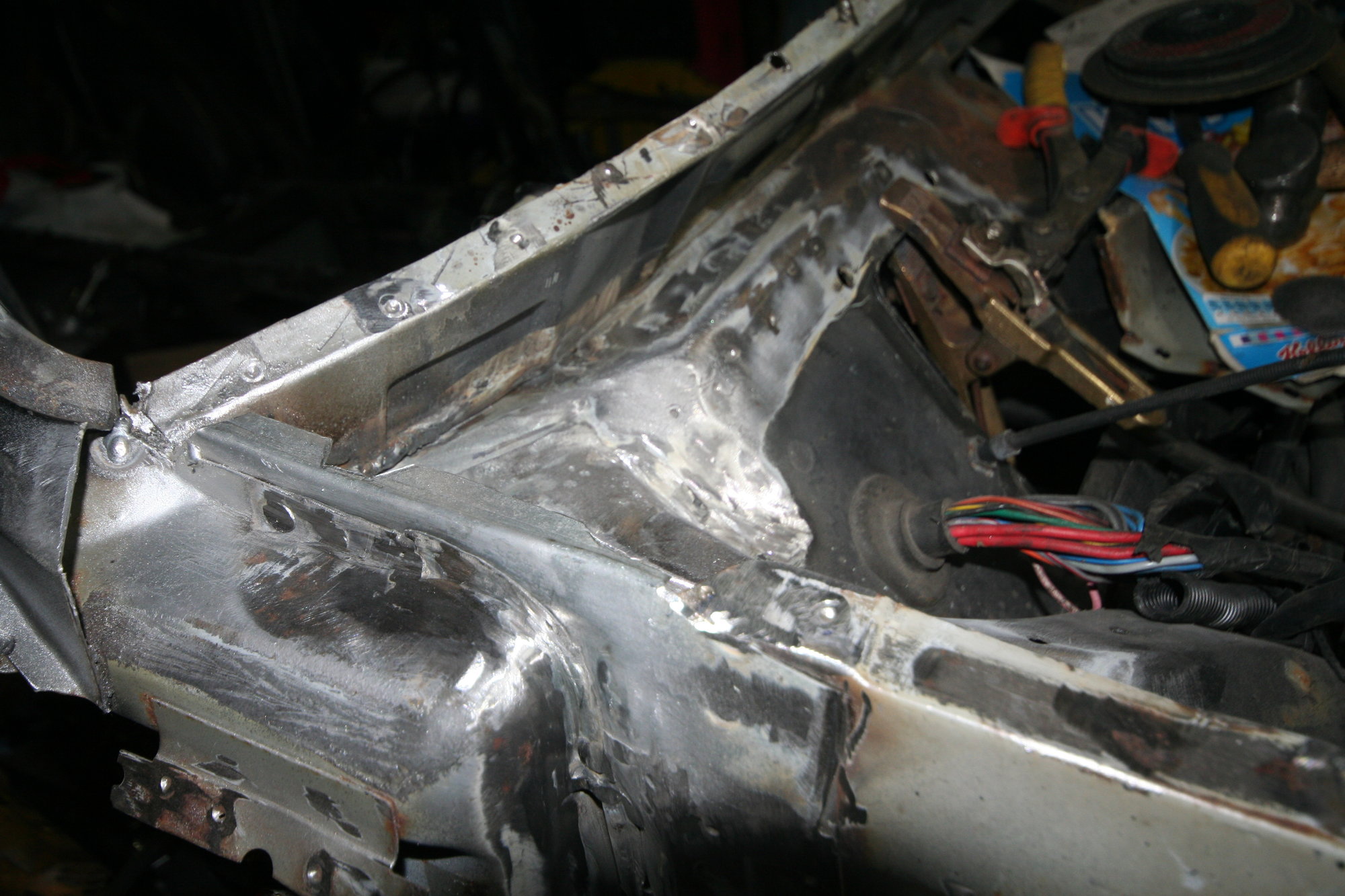

And finishing off the repair into the inner guard area
Finished repair from the dash side.
Thanks Exuptoy,
Its a bit silly how long this sort of think takes and can you imaging what it would cost if you had to pay (or charge) someone for fixing it!
Fortunately I'm not counting the hours and really do enjoy the process of repairing something rather than just heading for the shops. (Even if there is a shop where I could get it)

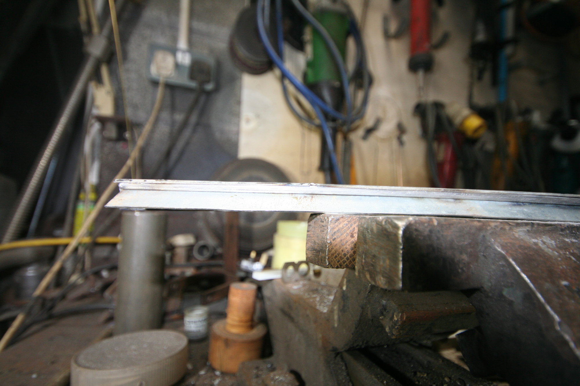

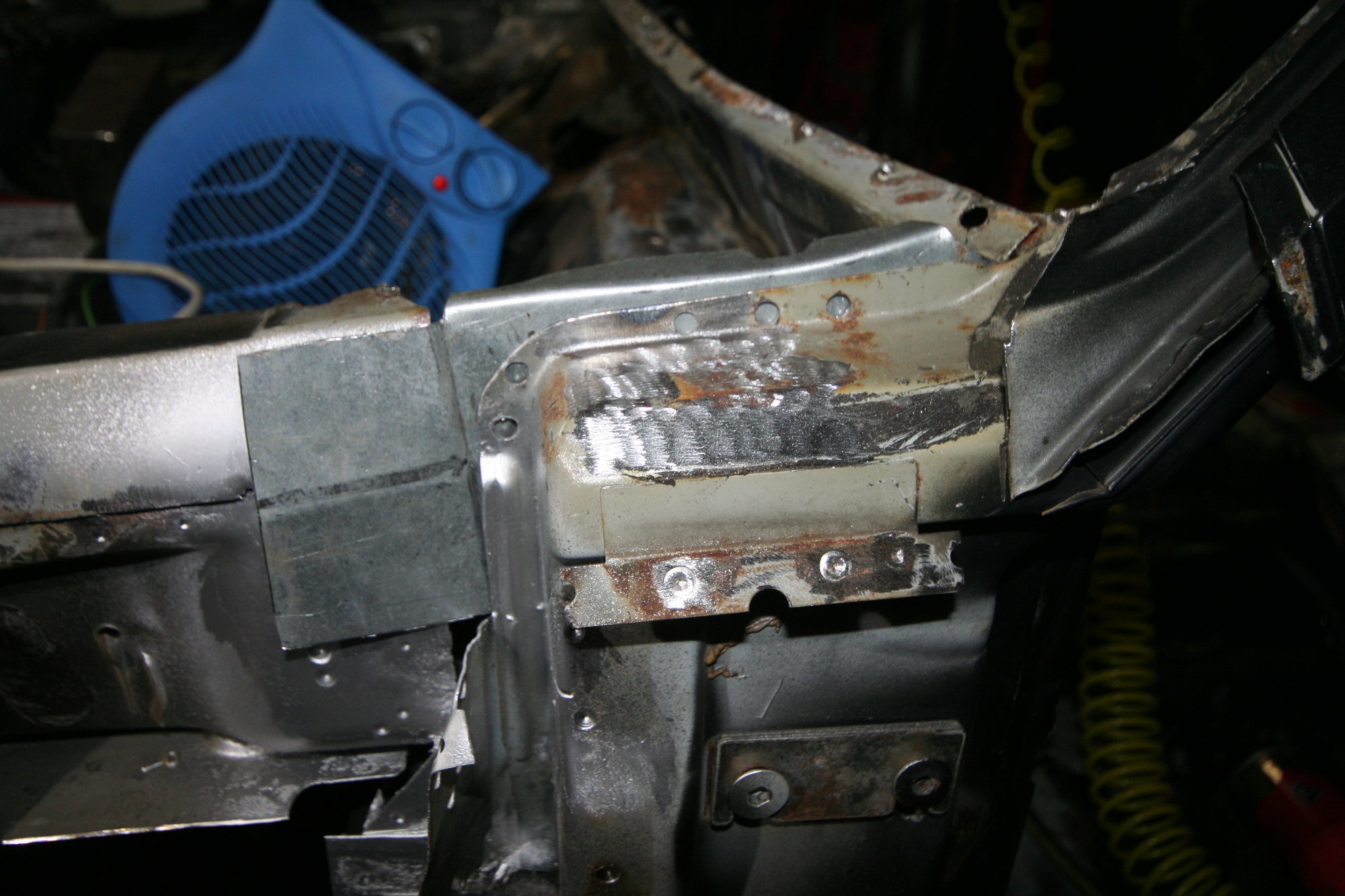

The brazing worked great, much better than I expected.
If I had used Mig or Tig I think it would have been a mess and required a shed load of grinding.
I hope the flux got all removed when I blasted it but you never know.
