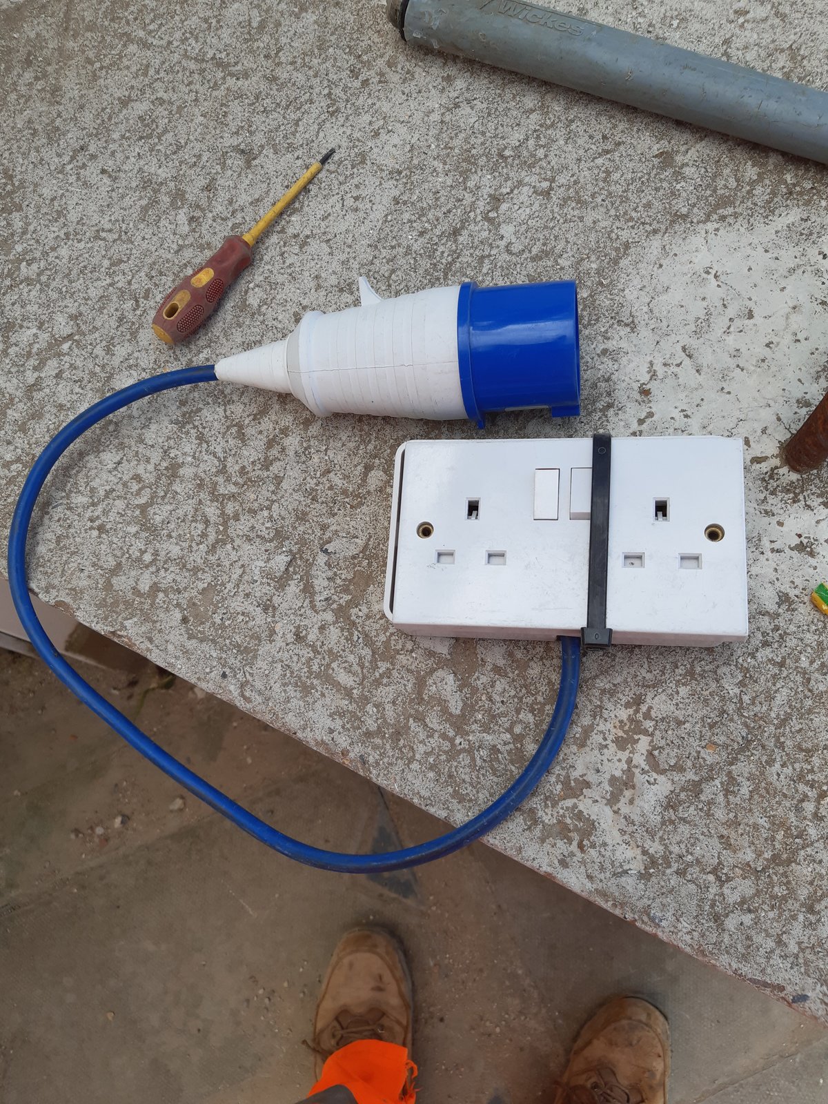

My 140Amp Mig welder is tripping the F outa my Domestic electrics.
I have a 160Amp MMA/Lift Tig welder. One of the cheap ones off Amazon, the DekoPro 160A model and it works fine every time but this Hitbox 140 HIM200 Flux core Welder trips the switch every time.
Any advice would be greatly appreciated by anybody on here.. Thanks in advance btw..
