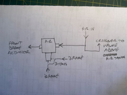

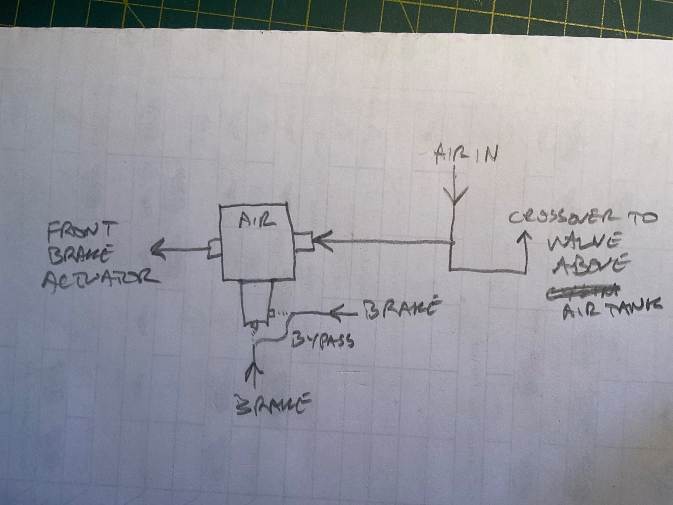

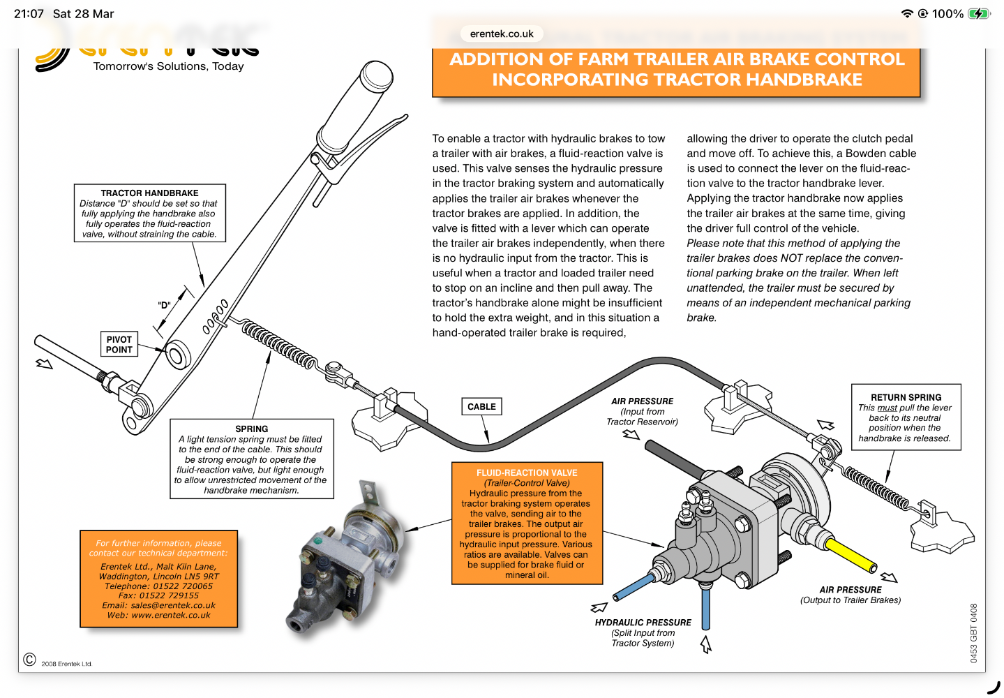

These tractors have a valve to supply air from the compressor to a port on the back for trailer air brakes, in response to hydraulic pressure from the service brakes. I think the front brakes are somehow reliant on the air supply as well:
The hydraulic part was leaking, so he joined the blue pipes together, but this locked the front brakes up, so he released the brake unions and has been pottering about his smallholding with no brakes for ages. Retired farmer and neighbour I’m trying to help out.
We’d rather just bypass the valve, since he doesn’t need the trailer brakes, and replacements or even seal kits are stupidly expensive. It’s leaking air as well, which is needed for the 4wd and diff lock.
The problem is, the pipework is more complicated than in the diagram. One air port appears to have an air feed from the cylinder (on the other side), but is connected via a T piece that returns to the other side again, to a valve above the cylinder. The other air port goes to something that looks like a cylinder, which looks like it has a hydraulic master cylinder bolted to it. Hard to see.
The only other thing is, there’s no cable attached to that lever on the back.
