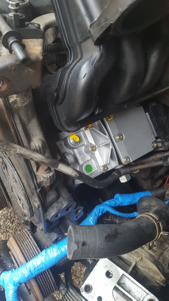

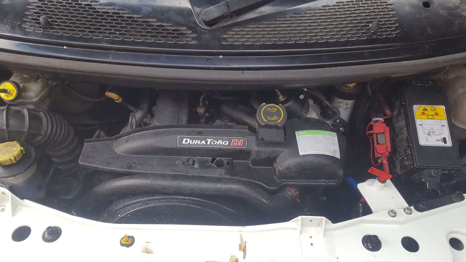

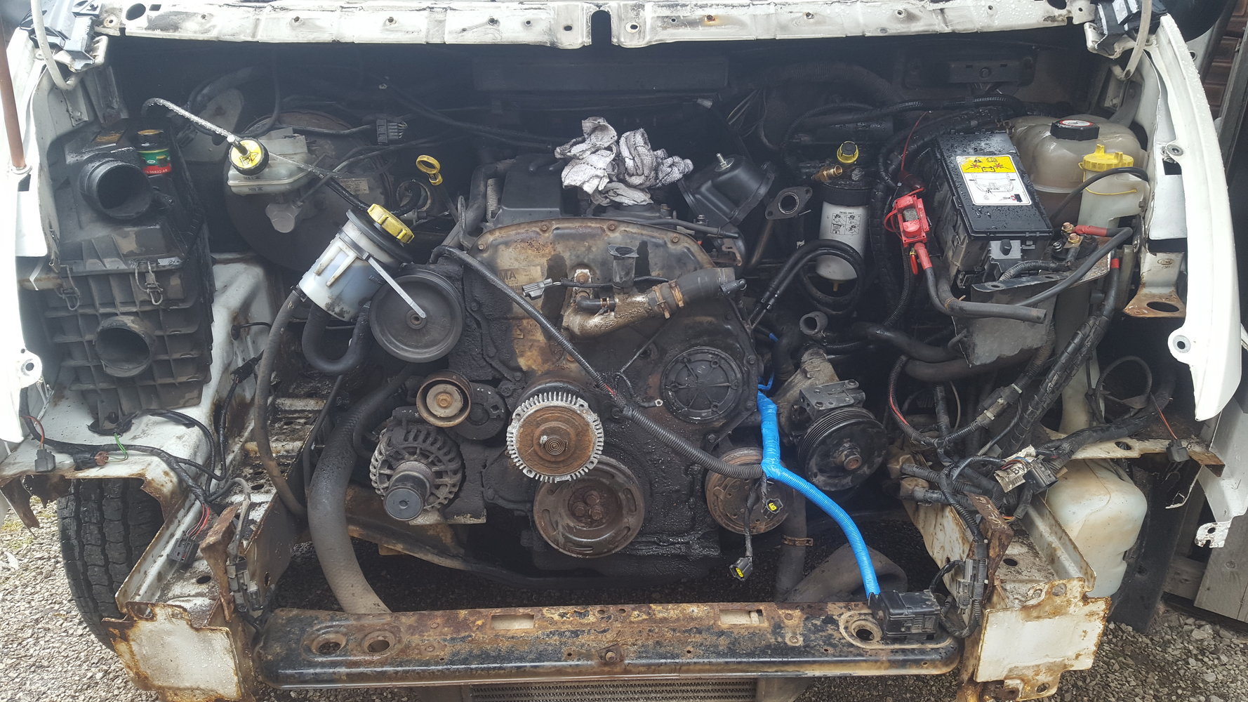

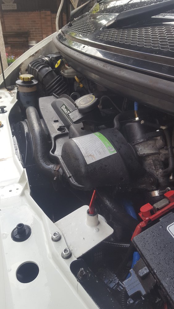

Anyone have any links or names for a recon diesel pump (VP44)...I have tried the EDC repair (solder a new chip in) but it has not really worked so the EDC must be fried. cuts the fuel when it gets hot and is a right pain in the ring, cools off after 20 mins and fires up again for another 30 mins or so. Can get one from Germany for £700 but would rather shop within our own shores. diagnostic codes are P1664,P1564,P1551, P1561, P1630, P1631, P1651, P1661
my engine numbers dont match any ford number. will have to remove the pump and see the number on the side of that to match.
