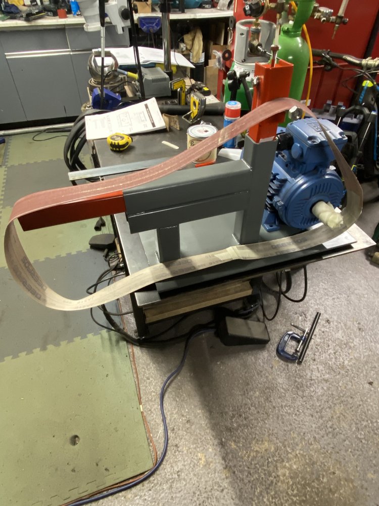

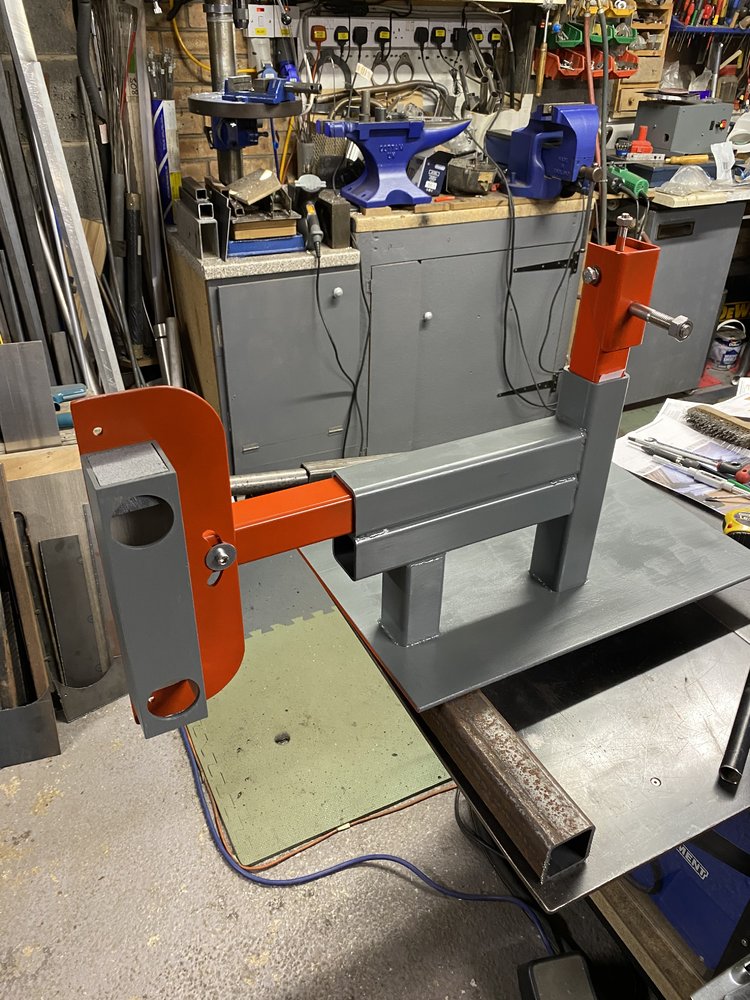

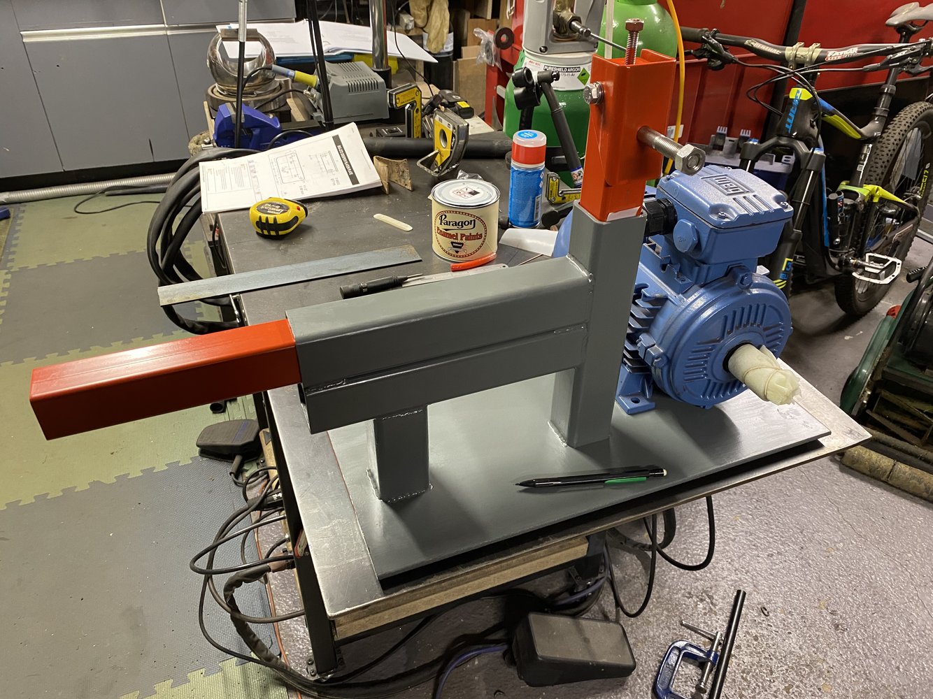

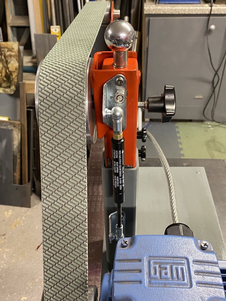

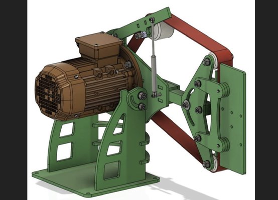

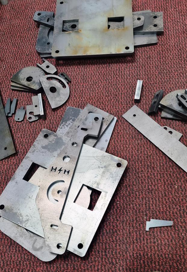

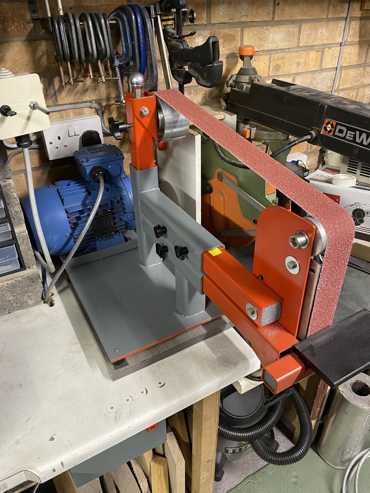

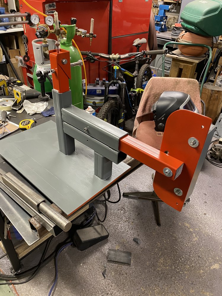

How much did the steel / laser cutting cost ?As if I haven't had enough on this week I picked up the parts for another project this evening, a 2" x 72" Belt Grinder. I have yet to decide on which motor I am going to use but it is going to be 2 horsepower three phase run from an inverter. The bit I am stuck on now are the wheels and where to source them from, or make my own. The Laser cut kit of parts:
There are enough bits for two machines here, my pal is building one at the same time so it will work out a little cheaper for us, we hope.
Would welcome suggestions as to sourcing the drive and idler wheels though.
2 inch belts arent much use for anything 4 and 6 inch are much better over a big flat plate
That depends what you're grinding. We had a 2" in a machine shop I worked in and it was brilliant for no end of jobs. Obviously if you need to grind away a 3" width of stock you'll need a wider belt than 2".2 inch belts arent much use for anything 4 and 6 inch are much better over a big flat plate
2” width means you can apply the pressure needed for ceramic belts to cut well, up at 4” or so you’d need to be leaning pretty hard
This is my problem. I have one and can't seem to get the inertia to build a plate for it as it's only 2 inch and not much good.2 inch belts arent much use for anything 4 and 6 inch are much better over a big flat plate

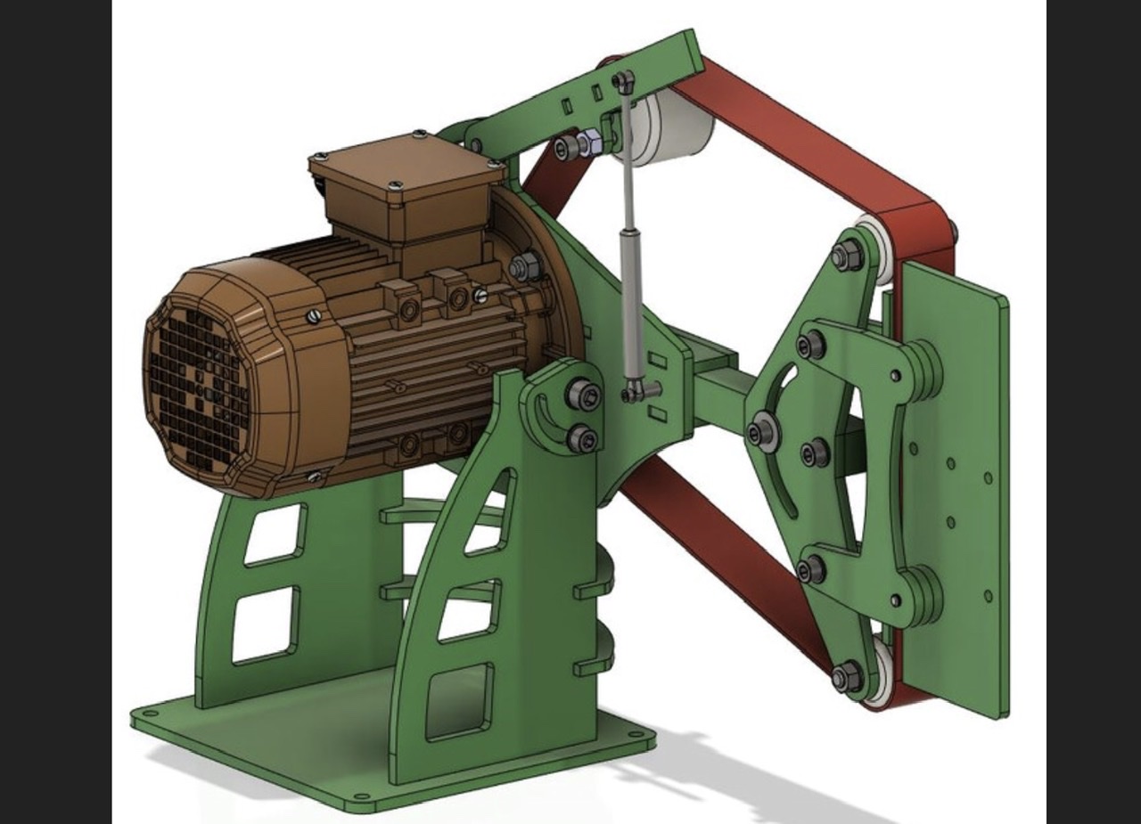

I bet that wasn't cheap. I have 2ninch wide belt roller and thought it was too small really. But it seems that's the most popular size.I got my grinder from here rather than build my own. They appear to make the crowned tracking wheels and standard rollers. https://downlandengineeringservices.com/belt_grinders/
