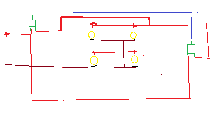

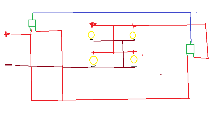

this way, cracking diagram hey lol it is the way it will be set out on the boat.
if trying to use a pir these normaly use 240v for the switching and will need a 240v as well as neutral aswell as the feed from the live 12 volt feed

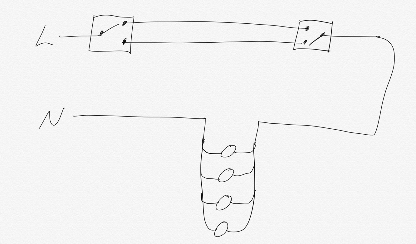

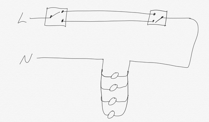

Mmmm.... Are they now 240V lamps, not 12VDC ones?
If so then, you're on the right track but you seem to have connected up both contacts on the first switch to live, which will mean the lights stay permanently on.
Gimme a sec and I'll try another diagram. By the way, if it's 240VAC mains (or, in fact, any AC supply) then there's not really a "+" and a "-"; it's live and return (or neutral in old-fashioned speak).

You've got one too many wires - the L1 should not be linked together (you're already linking the L2s and the commons).
I'm not sure why you're still trying to draw this out - the later drawings, particularly Matt's and wookie's, will work for you![]()
I was going to go with the 2 way switch 2 way at first but then i read about the safety part, unless that does not matter on 12v just 240v ?
No problem with going two wire if its safe enough.
