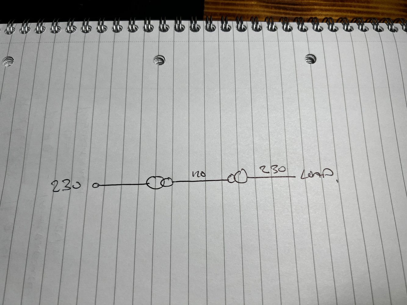

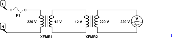

Either I’m stupid or something else, I don’t see them in series…2 x 5kVA 230/110V single phase AC transformers connected in series, would the inrush current (5X) be double or just the same as one? or somewhere inbetween.
1 transformer is connected to another as it’s secondary load, the 2nd transformer has the load on its 240 ( primary) output winding…ignoring mag currents etc, theoretically the current in the primary of T1 will be half that of T2’s input winding ( the secondary..)….the overall current draw will be dependant on the load attached to the whole…as I see it…
