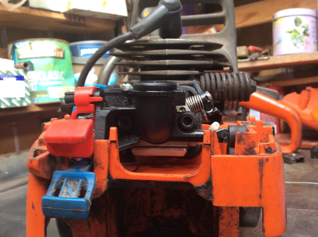

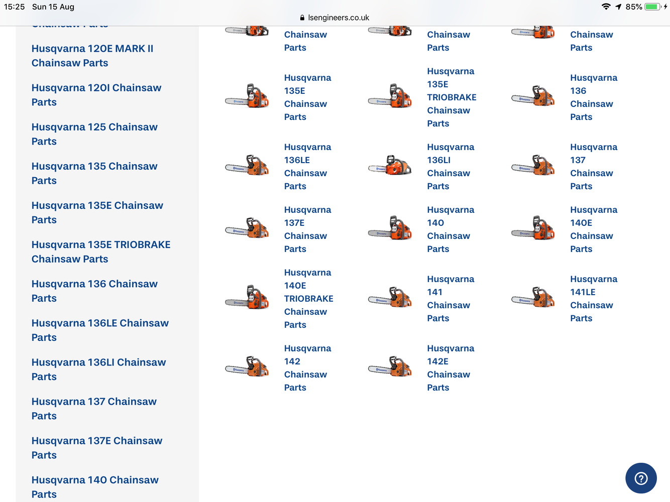

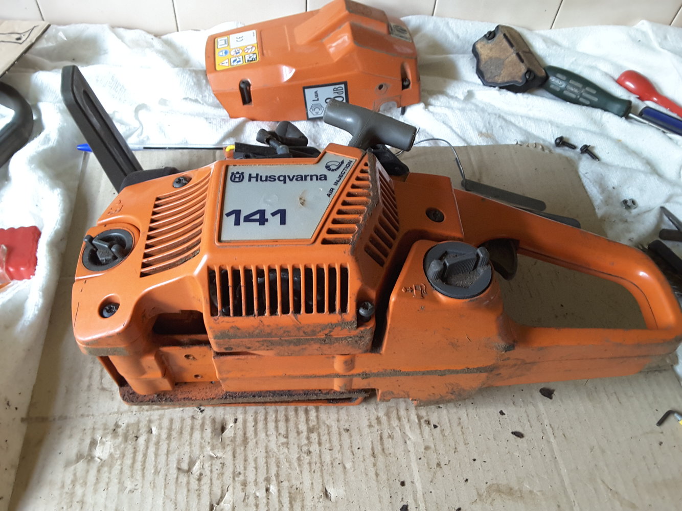

I have a manual for the 41 or the 140 But not the 141. Must be newer?
My two stroke strimmer is always a bugger to start after a couple of weeks. Stored with an empty tank.
My system now is to remove plug, pour in a fair amount of petrol. Ignition off. Plug out. Pull start several times. With plug still out, I use the compressor and blow air into the exhaust whilst pulling the starter rope. Then do the same blowing air into plug hole. Plug back in, choke, priming tit left alone, pull and it starts.
What a bloody palaver.

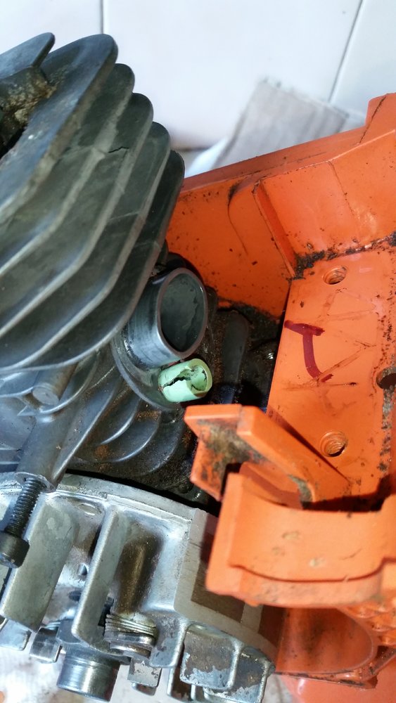

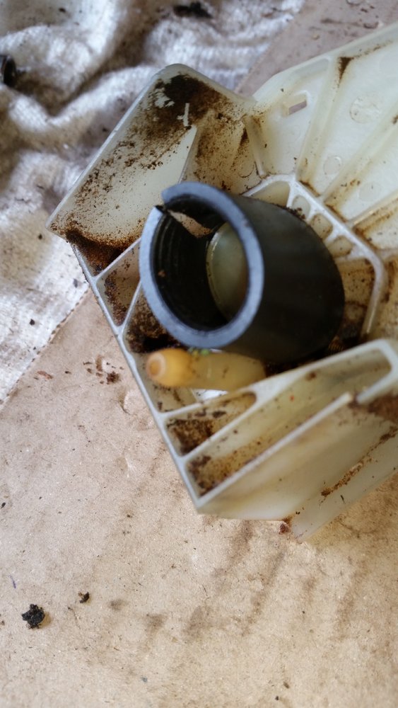

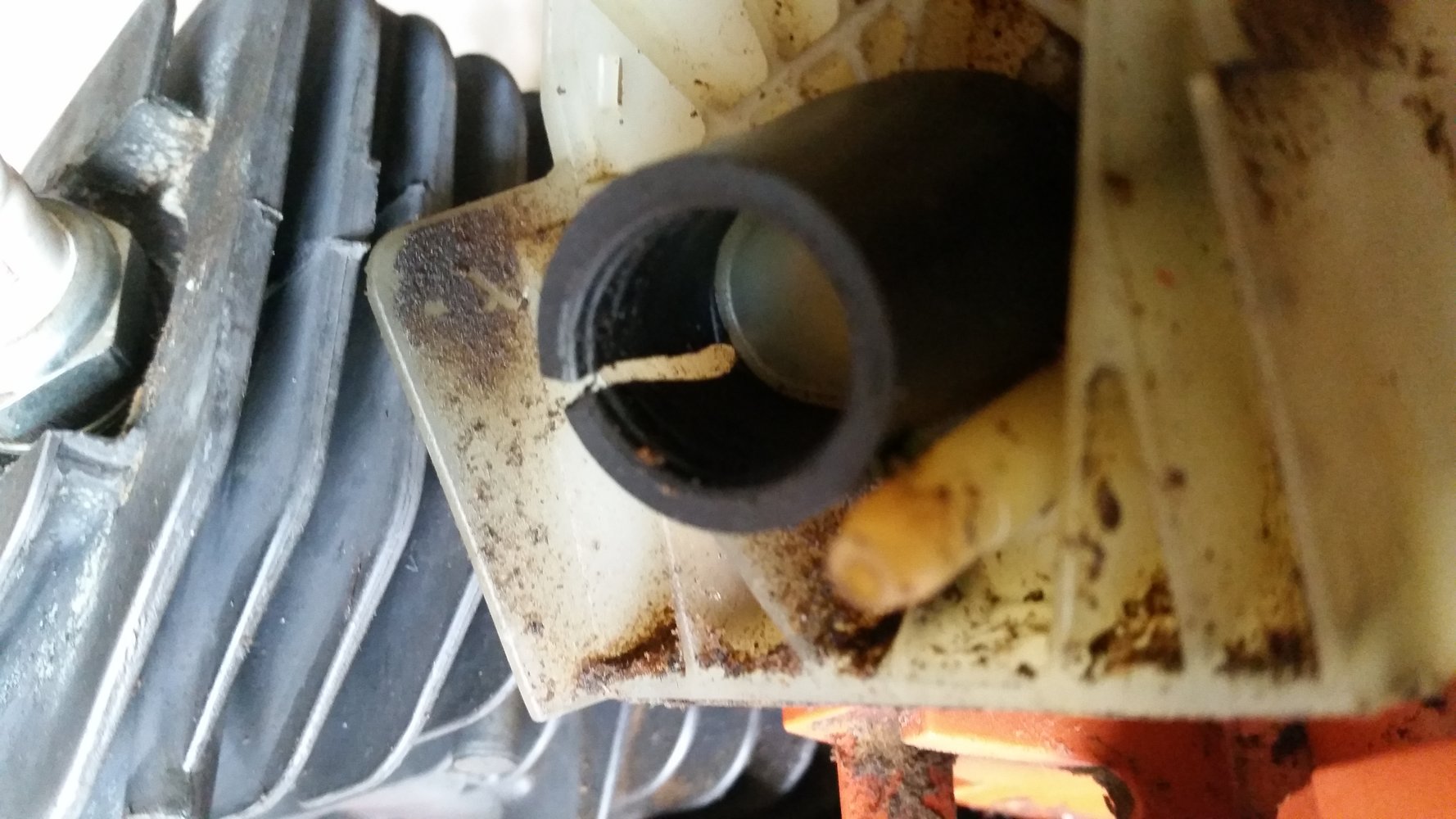

That is what went through my mind when I noticed the 2 parts each with a split.any extra air will stop the unit starting split in fuel pipe, gasket split, etc
did you throw fuel down the bore ? and try a start this way it does worry what the state of the carb is like only the compression in the bore and if you got spark
