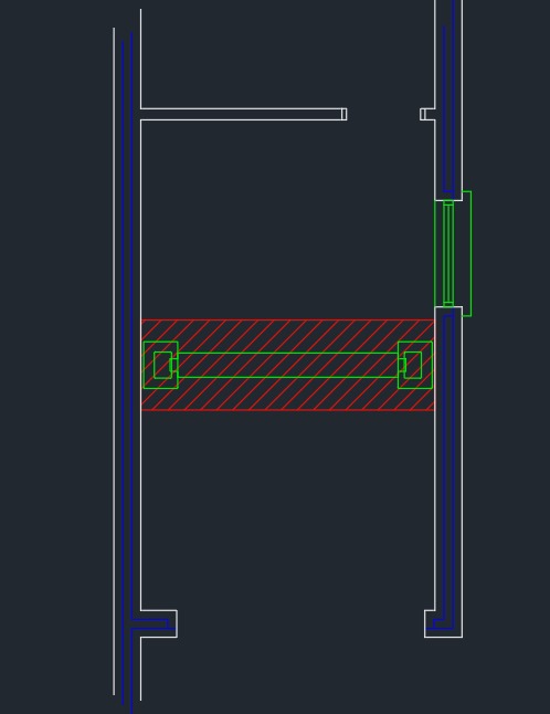

This is the beginning of a CAD setting out drawing.
The lift is a tight fit in this garage but will fit.
The red hatch is the approx area I plan on sawing and digging through the existing concrete floor. And dowel the founds and edges of concrete plus have the lift pad poured under the edges of the existing floor. It won't be going anywhere after that.
