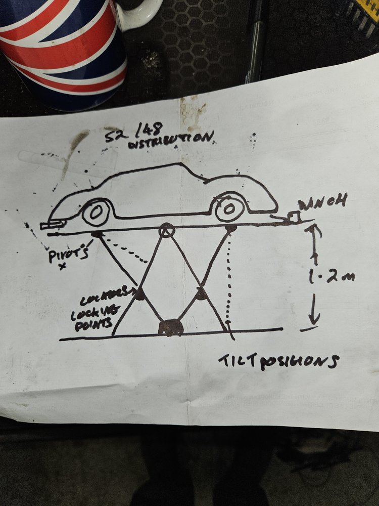

You need to torque the fastener to the correct torque not over tight and stretch the fixing in this situation.Respectfully I’d say it’s common sense to not pull down hard on a fastener on a 2 post lift which will set up a rocking motion.
These lifts are used almost exclusively in many garages and are perfectly safe if used with consideration to the off centre balance if removing a tight bolt at the front or rear. A 4 post in a domestic garage is likely to be too large for most.
......The Meteor will be extra, back yard engineering at it's BEST....is that post to my idea Gaz? winches are dam good, braked and reliable nowadays.i wouldnt be using those with just a winch one ton of car coming back down your not going to survive it
Temporary car lift needed

its not the winch its more the cable that has failed had a fair few fail with genie lifts with having steel girders and beams on themis that post to my idea Gaz? winches are dam good, braked and reliable nowadays.
