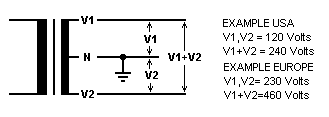

This supply system is common in Hastings town centre.Split phase is two phases, 180° out of phase with each other, sharing same neutral. 230V each, 460V between phases.
Not much use for anything as a supply over and above two single phases to increase capacity. Used to be able to get split phase motors iirc.
It's probably split phase, rather than two phases of a 3phase supply given its location I suspect.
