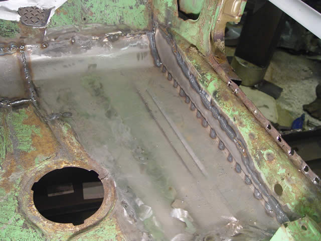

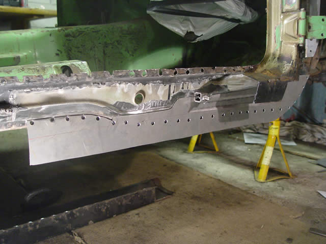

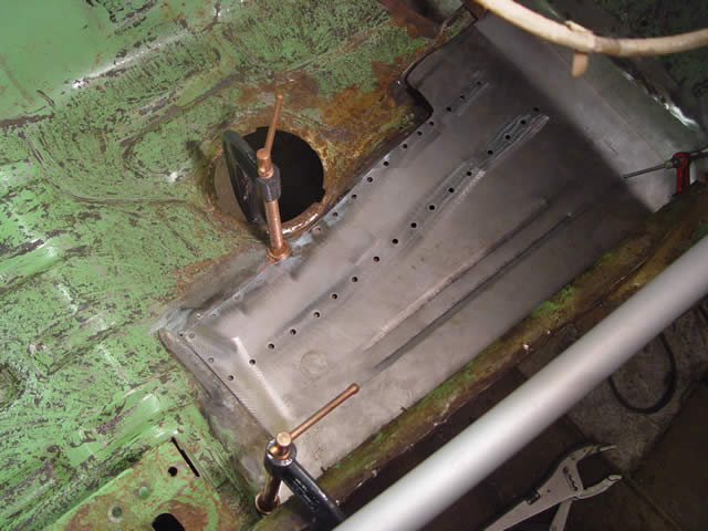

I have made some progress on the drivers foot well and I did the front section of the inner sill today. Now there is some more rigidity on the drivers side I can hack out what is left of the inner sill and start on the rear wheel arch.
I removed the last owners patches and made some repairs on the support member than runs under the foot well and into the engine bay. Cleaning the metal and doing the plug welds near the firewall was a pain but well worth it.

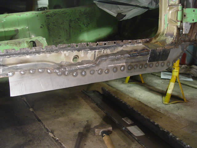

Note the DIY "instergrip" I made up as a test and used on the sill, it works well so I'm going to make a set beats buying them! £29.99 on ebay for four!! I will post a thread on how I made it if anyone is interested?

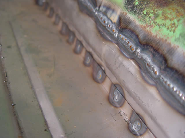

Welding in a repair on the drivers side inner sill. I think I'm starting to get the hang of the welders power settings and my welds are gradually improving.
just out of intrest, i see u got a few rusty bits in the last pics, you going to rub iut all back and clean it up once u replaced all the shudy welds etc?
starting to look nice n keep up the work
I have been and will be grinding all the welds back with flap discs and once all the welding is done I'm planning to shot blast the rust, wheel arches, boot, underneath etc

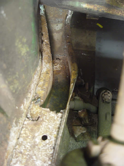

The inner wheel arch on the '02s has a tube which runs from front to back, for some reason part of this has been cut out. I'm not sure why as they don't normally rust there?
Half of the inner arch was also missing since I pulled out the bodged repair. Now with a gaping hole I had a choice of trying to patch the 'tube' and buy an inner arch repair panel, although I'm not sure they cover the entire area that was missing. Or turn to the other 2002 I brought, I poked the arches which seemed solid, with a bit of rot at the bottom of each side.

Note the missing 1/4 of the tube.

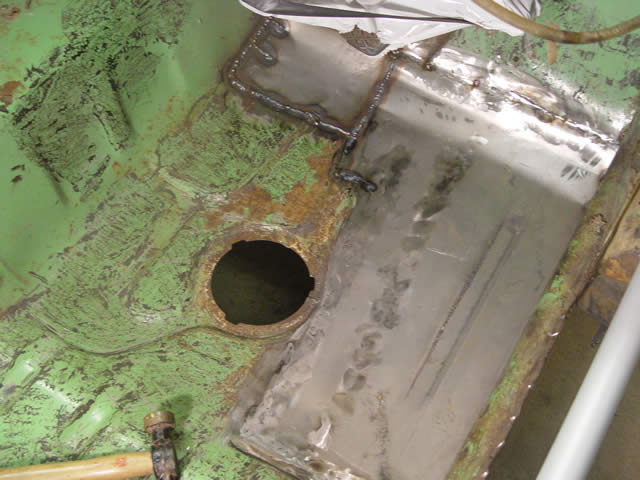

With the wheel arch back in I can start to rebuild areas leading into it. Its nice to start being constructive again, after many hours of grinding, cutting and removing etc

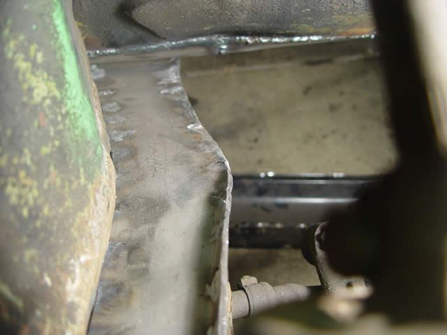

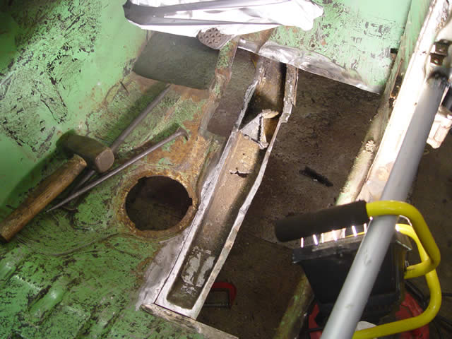

Over the last few days I tackled part of the boot floor...
Not to clear in the photo but they is a 1" gap along the side, underneath was a large dodgy patch. Part of it half blocking the hole towards the back.
Proper job there - lovely to see. It's always a much more work to put things right when someone has botched the car beforehand. You have to cut their stuff and out and whatever they tried to attach it to.
I like the swage in the boot panel. The bending looks neat too - how did you form the bends?
I have cut out a lot more metal than should have been required to fix the initial rust, for the most part the previous repairs are a little more than tacked on leaving them as mud and water traps.
I formed the bends by hand on a home made anvil, see second pic from the bottom.
